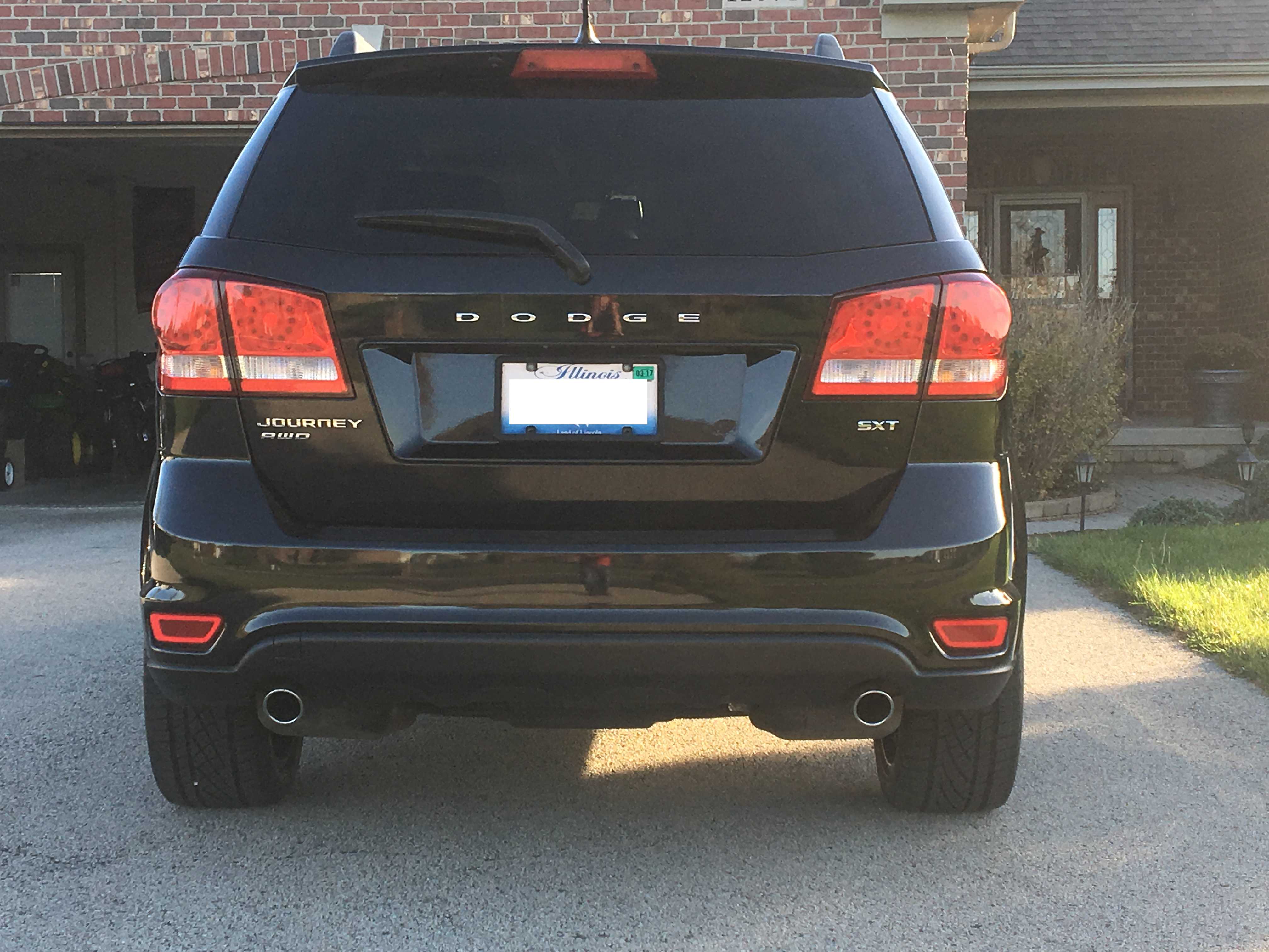

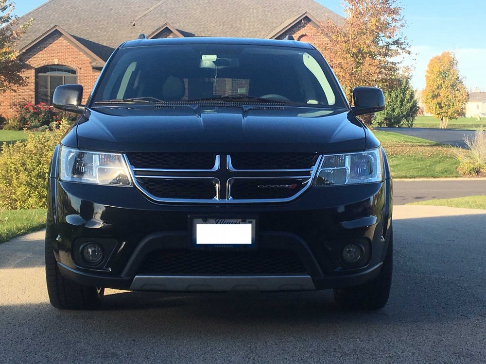

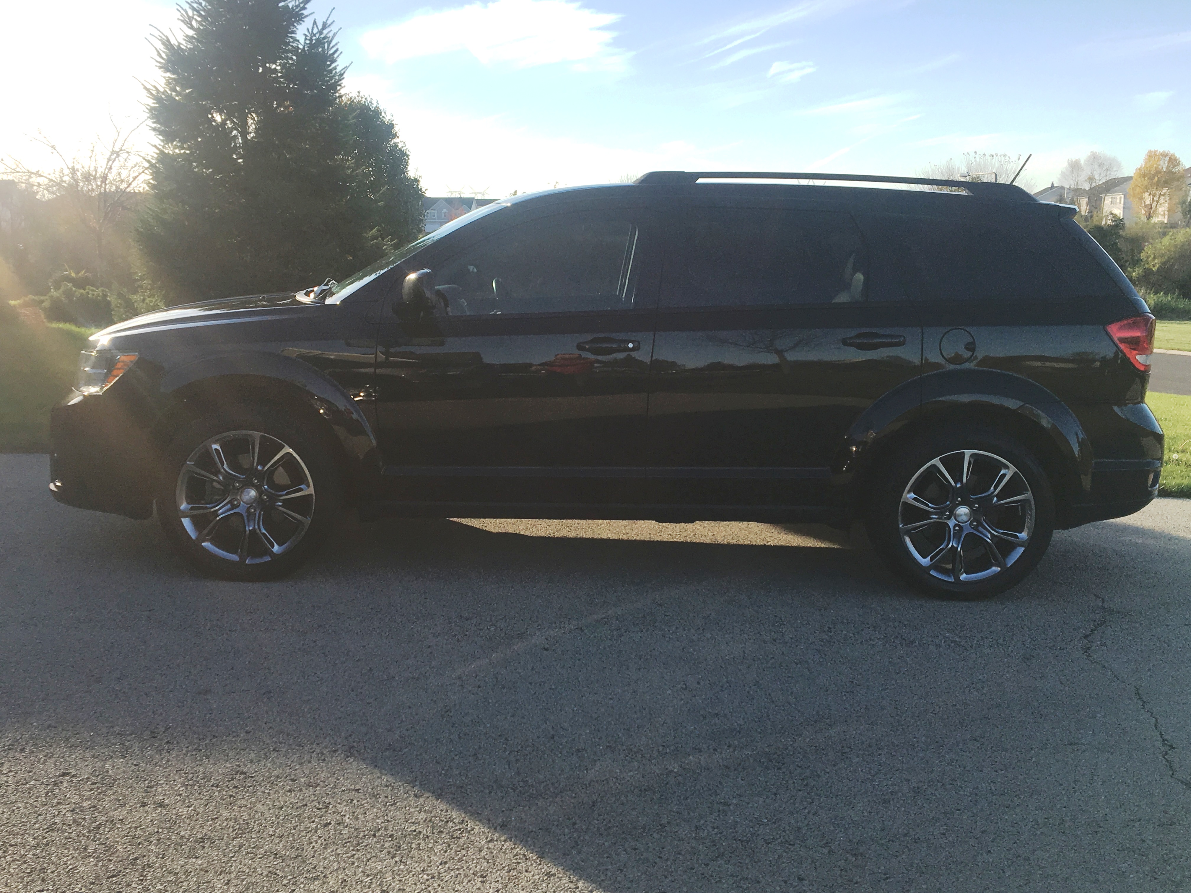

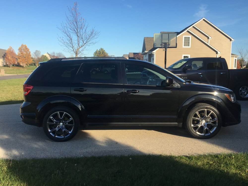

hafnutz67 Posted November 7, 2016 Report Share Posted November 7, 2016 I finally got around to changing out the wheels and tires on my wifes 20013 SXT. The wheels are 20x8.5 +34 Hyper Black SRT8 replicas by H--Performance Designs. The tires are Continental Extreme Contact DWS 06 255/45R20. There are no issues with rubbing and I love the look. Mlangston85 and KnightRoller 1 1 Quote Link to comment Share on other sites More sharing options...
hafnutz67 Posted November 7, 2016 Author Report Share Posted November 7, 2016 A few more pics Mlangston85, KnightRoller and LisaLeeMcLeod 3 Quote Link to comment Share on other sites More sharing options...
jkeaton Posted November 7, 2016 Report Share Posted November 7, 2016 Looks really good!! Quote Link to comment Share on other sites More sharing options...

darrenm Posted February 2, 2017 Report Share Posted February 2, 2017 Nice choice on wheels. How much it cost you? And how's the quality and finish? I found the same replica jeep str8 wheels at http://4wheelonline.com and I'm thinking of buying a set for my DJ. Quote Link to comment Share on other sites More sharing options...
Steven Harshbarger Posted February 2, 2017 Report Share Posted February 2, 2017 Wow, those look amazing. Congrats! Quote Link to comment Share on other sites More sharing options...
nash211 Posted February 7, 2017 Report Share Posted February 7, 2017 (edited) They really look great, how does it ride now ? Edited February 7, 2017 by nash211 Quote Link to comment Share on other sites More sharing options...
hafnutz67 Posted August 13, 2018 Author Report Share Posted August 13, 2018 And on a sour note, the PTU went out and is not being covered under warranty due to the oversized wheels and tires to a tune of approximately $1,800. Ouch KnightRoller 1 Quote Link to comment Share on other sites More sharing options...
jkeaton Posted August 13, 2018 Report Share Posted August 13, 2018 Chance you take when modifying a vehicle from stock. Quote Link to comment Share on other sites More sharing options...
KnightRoller Posted September 12, 2020 Report Share Posted September 12, 2020 I'm sorry but the oversize wheel argument is poppycock! The stock wheel/tire combo is 730mm height. The set he put on is 738. So 8mm is barely over a quarter inch. He used the same size at all four corners so there isnt a speed differential. This is nothing more than warranty looking for a way to blame the owner. Total crap. Quote Link to comment Share on other sites More sharing options...
