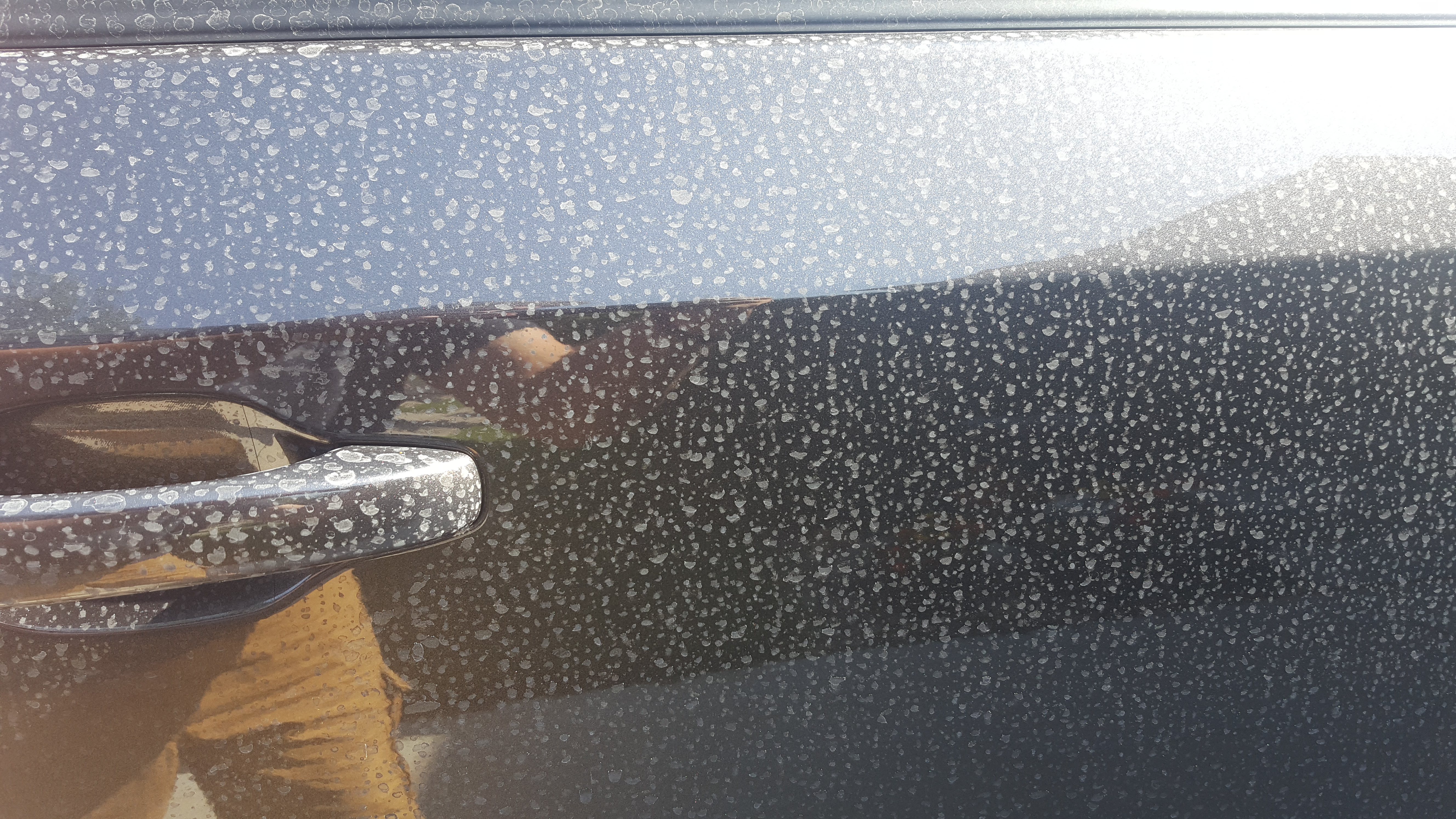

Bryman31 Posted September 3, 2017 Report Share Posted September 3, 2017 so in my area our sprinkler water is city water which is VERY hard/non-potable water. the whole passenger side of my new car is covered in white hard water spots. washing it does no good. i have spent the last 20 mins scrubbing with Windex the crap out of the windows and have made a 60% difference. but i cant Windex the paint. any ideas from anyone how to get hard water spots off?? Quote Link to comment Share on other sites More sharing options...
jkeaton Posted September 3, 2017 Report Share Posted September 3, 2017 Clay bar. Quote Link to comment Share on other sites More sharing options...
Armando G Posted September 3, 2017 Report Share Posted September 3, 2017 Two ways...Water and White Vinegar mix (2/3 water), or hard water spot remover from auto parts store (most do work as long as the spots haven't been there for days). In either case, make sure the car is cool to the touch before doing. 2late4u, jkeaton, OhareFred and 1 other 2 1 1 Quote Link to comment Share on other sites More sharing options...
Bryman31 Posted September 4, 2017 Author Report Share Posted September 4, 2017 OK SOOOOOOOOOOOOOOOOO..................i have no idea why but in our pantry we had white vinegar. so i used some bottled water to mix it. WHAT AN AMAZING THING!!!! my paint is sparkly new!!! thanks Armando G. for the tip!! jkeaton and OhareFred 1 1 Quote Link to comment Share on other sites More sharing options...
