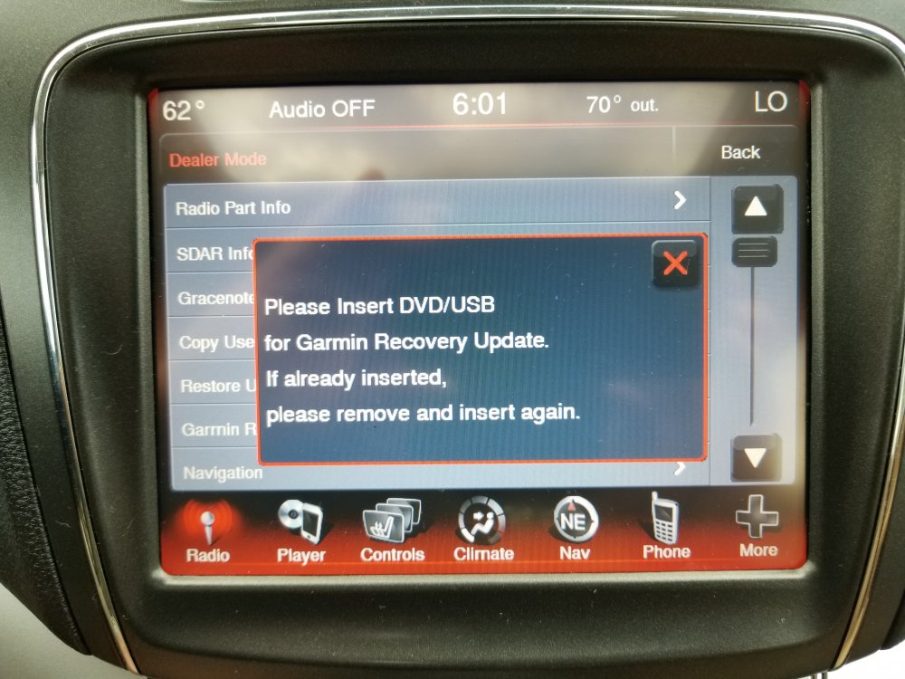

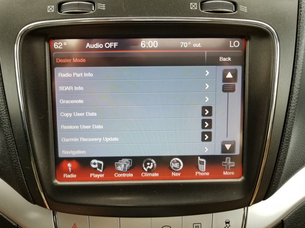

zjrog Posted September 18, 2017 Author Report Share Posted September 18, 2017 Looks like I need the update DVD or USB... I got into tbe dealer menu. But did not see a reset selection. I saw an R61 recall was done and the recall for steering column wiring is needing to be done. But no R65... Quote Link to comment Share on other sites More sharing options...
bramfrank Posted September 18, 2017 Report Share Posted September 18, 2017 No. You need a new radio. The good news would seem to be that the R65 wasn't done . . . . or, the bad news is that it may not have been specified for your serial number (not all vehicles subject to problems were eligible for the recall for some reason. Check with a Dodge dealer. But I'll ask again; Did you get a warranty with the vehicle? If you did, then let the seller handle the problem. larryl 1 Quote Link to comment Share on other sites More sharing options...
