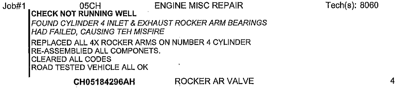

STUE Posted March 31, 2019 Report Share Posted March 31, 2019 Hello, I've been reading this post and I think mine is a related issue. We have a Dodge Journey R/T JC MY13 Wagon and we've just had to shell out nearly $600 AUD for broken rocker arms. Has anyone else experienced this? Cheers Quote Link to comment Share on other sites More sharing options...
