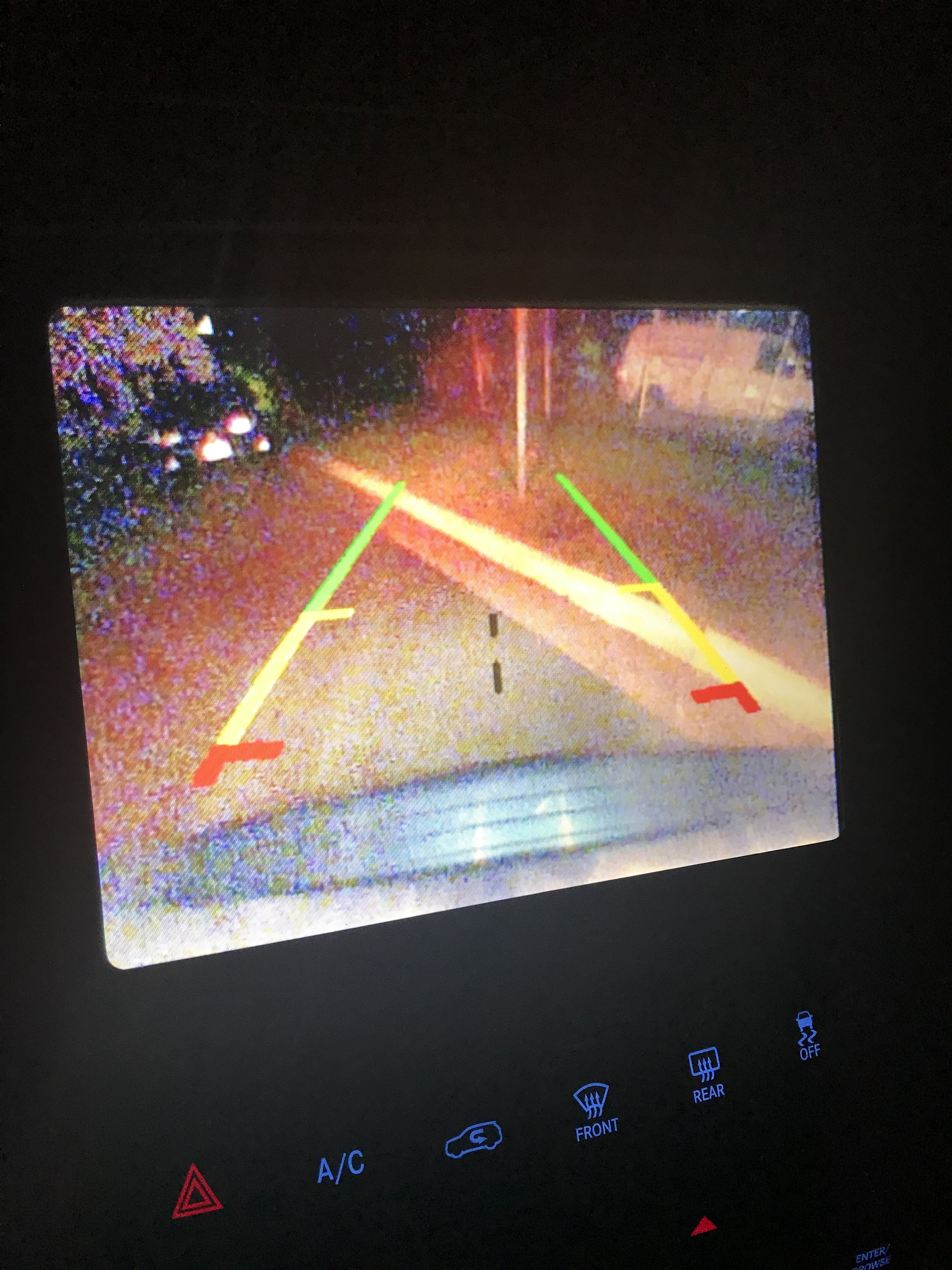

GLobo Posted October 2, 2017 Report Share Posted October 2, 2017 (edited) Hello everyone, this is my first post here. I searched but wasn't able to find my specific issue. I just bought a 2015 DJ Crossroad. It has a backup camera and during the day it works just fine. A little hazy/ blury (not crisp/HD) but I've read it's pretty normal. My problem is at night. Seems that the darker it gets the worse the camera works. It turns really grainy and almost useless. On my Camry the camera turns to night mode, black and white but still really clear. Is it just a problem with my camera or is this just how it is on the DJ? Edited October 2, 2017 by GLobo Quote Link to comment Share on other sites More sharing options...

GLobo Posted October 5, 2017 Author Report Share Posted October 5, 2017 Thanks for the responses all! So it kind of fixed itself! I closed the back door kind of hard and it looks a lot better now lol! A little grainy at night but actually usable... I've been trying to recreate it so I could take it to the dealer but it's not done it again... fingers crossed Quote Link to comment Share on other sites More sharing options...
2late4u Posted October 5, 2017 Report Share Posted October 5, 2017 2 minutes ago, GLobo said: Thanks for the responses all! So it kind of fixed itself! I closed the back door kind of hard and it looks a lot better now lol! A little grainy at night but actually usable... I've been trying to recreate it so I could take it to the dealer but it's not done it again... fingers crossed mine is more clear than that but still a little grainy, you never said if you still have any warranty i would take it in if you do... Quote Link to comment Share on other sites More sharing options...
Steven Harshbarger Posted October 5, 2017 Report Share Posted October 5, 2017 Yeah, that photo is worse than mine. I had the camera option installed shortly after purchase and actually had a bad camera. I also drive a SRT charger and the camera in that was better and why it was so noticable. I took it to the dealer and they replaced the camera and now both Dodges are very similar in quality. Before the swap, it was similar to yours in the photo. Very grainy and kinda blurry. Now, its not HD but it's good enough for me. Quote Link to comment Share on other sites More sharing options...
