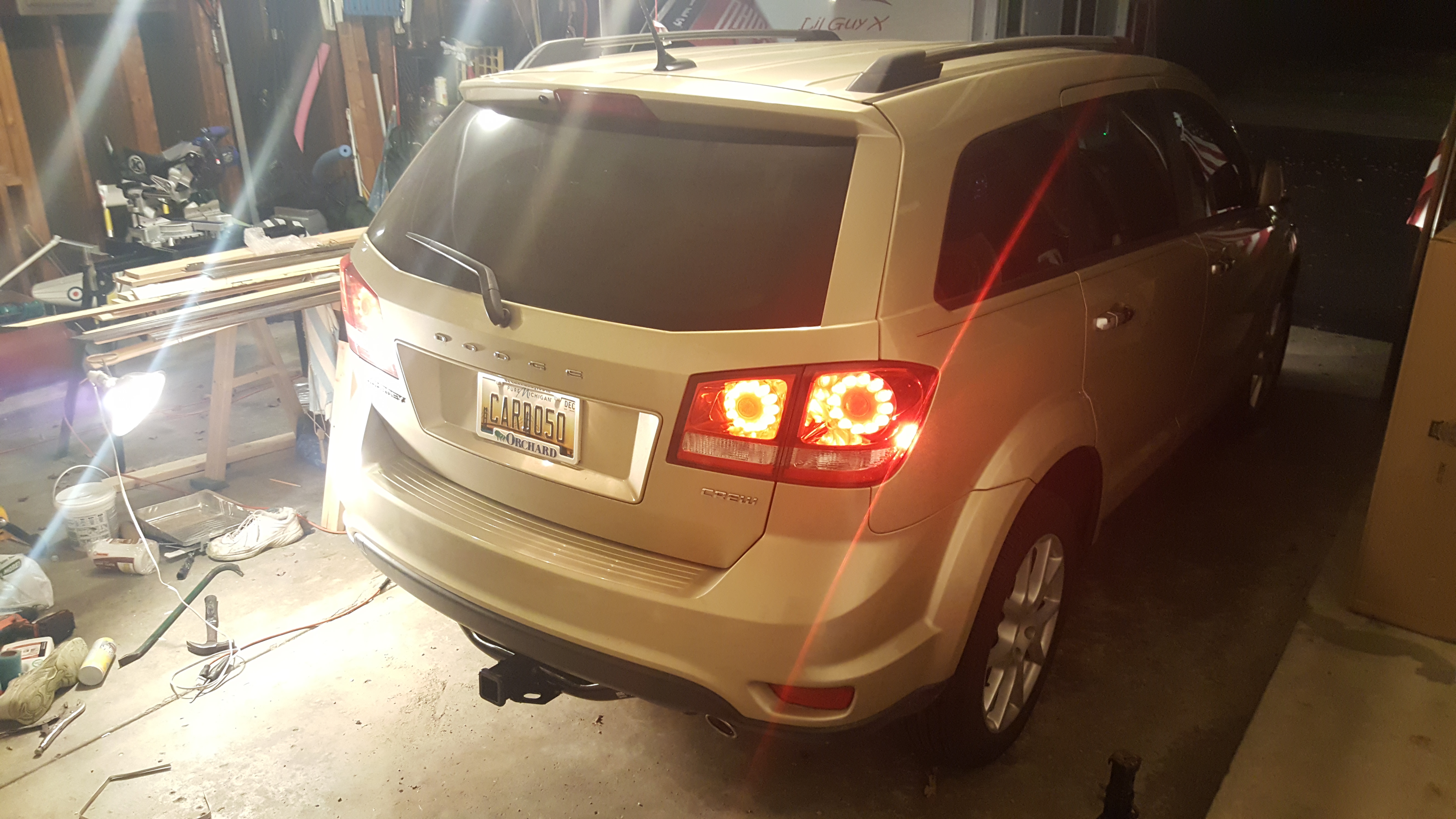

Just installed the trailer hitch (https://www.amazon.com/gp/product/B00QMF1HCW/ref=oh_aui_detailpage_o01_s00?ie=UTF8&psc=1) on my new-to-me dodge journey.
Install took me, and my Dad, and about 2 hours of actual hands-on work. It would have taken less if there wasn't a mountain of sand in hollow frame that I needed to clear away.
All in all, I'm impressed. It was inexpensive, and fairly east to install, even with just a floor jack, and basic tools.59de3bb19cbf4_20171010_2118511.thumb.jpg.d6ecd385b55a4819e62b1110007b68da.jpg
Appearance-wise, It doesn't stick out farther than the rear bumper, and is above the mufflers, meaning it's discrete, but also not totally hidden. I'd recommend this to anyone.

Hey I installed this hitch too last summer to carry bikes. I'm about to redo the job because i'm planning to tow around 2000lbs with it and I didn't have a torque wrench. How did you remove the muffler rubber !? I had a lot of difficulties getting them out off the hook. Also did you have any issues with the length of the screws !? I don't know why but some are not getting out enough from the frame to put the nut and torque them properly !

Sylvian, I'll try and address your questions one at a time: I've included what photos I've got on my phone from the install.
Muffler Rubber, HOW I LOATH MUFFLER RUBBER.... (Side note, I should add that to the "What really grinds my gears" Topic):
Do you have penetrating oil? That's what I should have used, but I ended up with (WD-40 brand?) Silicone spray (https://www.amazon.com/WD-40-300014-Specialist-Resistant-Lubricant/dp/B0083V8K0U/ref=sr_1_5?ie=UTF8&qid=1515528930&sr=8-5&keywords=silicone+spray)
I'd recommend liquid wrench deep penetrating oil if I was to do it again. Apply a liberally as possible, wiggle the rubber, spray, wiggle. Then use a combination of a sizable pry-bar and a rubber mallet for fulcrum to get leverage, and pick a direction (top hook, or bottom hook; pick one you can get good leverage on) and just muscle it off. lubricate both sides frequently... don't forget to support that pipe.
I had not a single problem with the kit at all. All bolt fit perfectly.
I have some thoughts on what may be causing your problems, I'll start with dumb/obvious first:
Are you sure the bolts are the same length? there are six total, and two were shorter than the other four....
Did you get the bolts to 'fall into' the square slots in the metal rectangular-tabs that go in the frame?
(this one I had a problem with) Did you clean the derbies out of the hollow frame with a metal brush, or compressed air? maybe there is a pebble in there propping up the metal rectangular-tab.
Did you get two on and two barely on? Maybe your hitch was manufactured twisted. Mine was a little, but even so i was able to hand-thread all four nuts onto the four bolts with about half an inch of thread exposed below the hitch on every bolt. see the photo.
Worse comes to worse, just buy longer screws with the square head/key to slot into the rectangular frame-tab.
(Look here in the following link; these are the bolts, installed without the hitch, with the rectangle tabs in the hollow frame. There is about 0.75-1.0 inch out the bottom on these two. basically the same excess on the third (Not pictured)
https://imgur.com/EsLGcng
Hope this helps!
