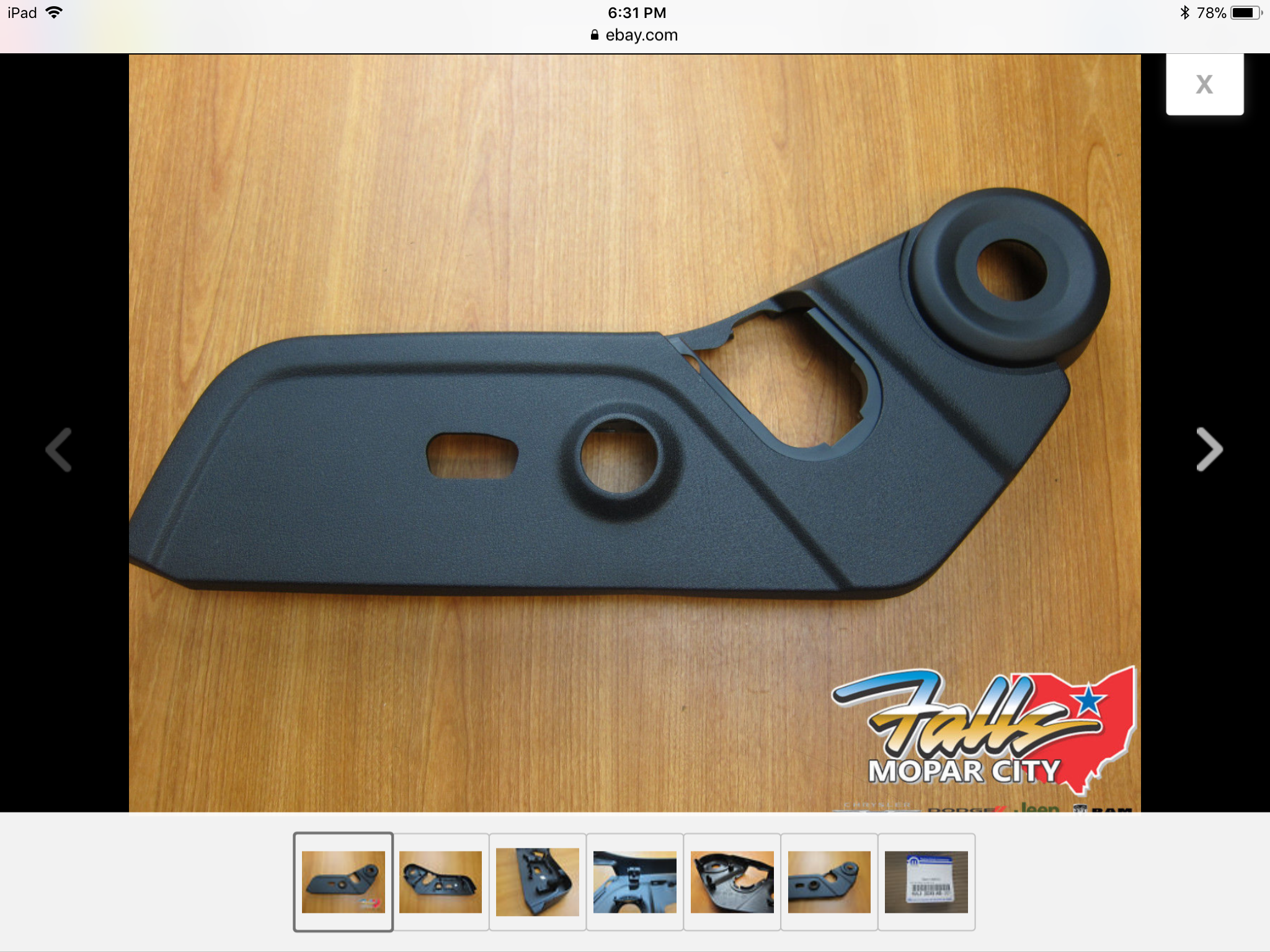

Potlicquor Posted February 17, 2018 Author Report Share Posted February 17, 2018 ... Update: (quite late) but here is a picture of the actual driver’s seat plastic cover part that needed replacing (second time, but not in-warranty this time) so I bought one and replaced it my self in order to save the $100 + labor, taxes, shop fees and whatall ever else. The part cost about $50.00 and about 30 minutes to change out. Also, attached photo of part number in case some on here needs it, thanks to all who assisted on here with this. Please note this part is for the driver’s seat that has auto adjust and lumbar). 2late4u 1 Quote Link to comment Share on other sites More sharing options...

Potlicquor Posted February 18, 2018 Author Report Share Posted February 18, 2018 ... I understand, my wife does virtually all of the driving of this Journey and she is handicapped (wears brace on leg as well) and can’t just get in and out without putting weight/pressure/stress on that top plastic retaining tab. I would be so grateful to you if you could post a couple of pictures of your repair method (black small screw and location) as I am at a loss for ‘where’ exactly it would be installed and I will go ahead and install one now to avert another breakage... which would save time and money too, thanks. Quote Link to comment Share on other sites More sharing options...
2late4u Posted February 18, 2018 Report Share Posted February 18, 2018 i dont know how to post pictures on here but looking at your pic above here the horizontal hole towards the front go about half half towards the front and place a screw there that is where i did mine on the passenger side and just use a small screw about half inch long with a good size head and or washer... my wife has about the same problems as yours and that is why i believe it gets broken as the seat kind of sinks down to the top of the plastic side panel and then gets dragged outward and breaks... good luck do it now before it breaks for a more secure sde panel .... Potlicquor 1 Quote Link to comment Share on other sites More sharing options...
