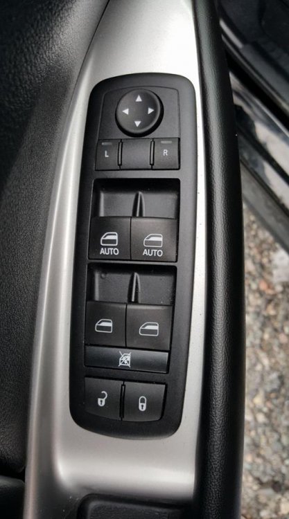

probak118 Posted November 26, 2017 Report Share Posted November 26, 2017 The master door lock control on/off button is still activated. In addition to the child safety on the ends of the rear open doors, you need to give control to the individual doors. Look on your driver's side door arm rest below the rear window controls. There is a button that you press , that will give or remove all lock controls every time you press it. Quote Link to comment Share on other sites More sharing options...
Shawn855 Posted November 26, 2017 Author Report Share Posted November 26, 2017 3 hours ago, probak118 said: The master door lock control on/off button is still activated. In addition to the child safety on the ends of the rear open doors, you need to give control to the individual doors. Look on your driver's side door arm rest below the rear window controls. There is a button that you press , that will give or remove all lock controls every time you press it. The only button below the rear window controls, is the button that prevents them from lowering their windows. There's no other button that i can see. See screenshot. Quote Link to comment Share on other sites More sharing options...

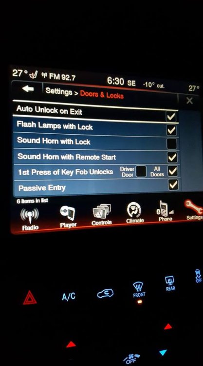

larryl Posted November 26, 2017 Report Share Posted November 26, 2017 It might be in your settings on the EVIC display Quote Link to comment Share on other sites More sharing options...
Shawn855 Posted November 27, 2017 Author Report Share Posted November 27, 2017 2 hours ago, larryl said: It might be in your settings on the EVIC display lol no, it's not in there either. I read elsewhere online that the rear doors will only unlock if: -I open my driver or front passenger door, then all doors will unlock -they manually pull the unlock pin located on their door -I press the unlock button myself To me, there should be an option where if i put my car in park, all doors should unlock, or at the very least allow the rear passengers to exit on their own. Just seeing if I'm missing anything here. Quote Link to comment Share on other sites More sharing options...
redtomatoman Posted November 27, 2017 Report Share Posted November 27, 2017 Maybe this will be helpful. . . From the 2011 manual: Automatic Door Locks — If Equipped When enabled, the door locks will lock automatically when the vehicle’s speed exceeds 15 mph (24 km/h). The Automatic Door Locks feature can be enabled or disabled by your authorized dealer. See your authorized dealer for programming. Automatic Unlock Doors On Exit The doors will unlock automatically on vehicles with power door locks if: 1. The Automatic Unlock Doors On Exit feature is en- abled. 2. The transmission was in gear and the vehicle speed returned to 0 mph (0 km/h). 3. The transmission is in NEUTRAL or PARK. 4. The driver door is opened. 5. The doors were not previously unlocked. 6. The vehicle speed is 0 mph (0 km/h). To change the current setting, refer to “Uconnect Touch™ Settings” in “Understanding Your Instrument Panel” for further information. NOTE: Use the Automatic Unlock Doors On Exit feature in accordance with local laws. Peace. jkeaton 1 Quote Link to comment Share on other sites More sharing options...

Shawn855 Posted November 27, 2017 Author Report Share Posted November 27, 2017 9 hours ago, probak118 said: Crap...sorry Shawnn855 my mistake, your are correct. It must have been in the settings as mentioned but, I know I changed it to automatic ( they are not locked when car stops.). All good man. I'll take a look in my display settings again but I'm like 90 percent sure I have the "auto unlock on exit" option already enabled. Will report back soon. Quote Link to comment Share on other sites More sharing options...
Shawn855 Posted November 28, 2017 Author Report Share Posted November 28, 2017 The auto unlock option was in fact already enabled. Tried disabling and reenabling it to make sure but still all doors remain locked when I come to a full stop and put the car in park. Only way for the doors to unlock is when I open my door, or when I press the master unlock button on my driver side. Quote Link to comment Share on other sites More sharing options...
