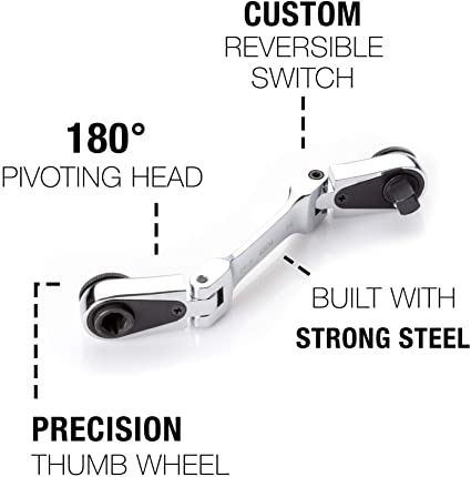

thejeepdriver Posted March 26, 2023 Report Share Posted March 26, 2023 This job is much easier using one of these: EZRED 4S04 Micro Combo Dual Ratchet Socket with 1/4" Square Drive & Magnetic Bit Drive. Available at amazon, or through your local Snap-On dealer for twice the price. Quote Link to comment Share on other sites More sharing options...
