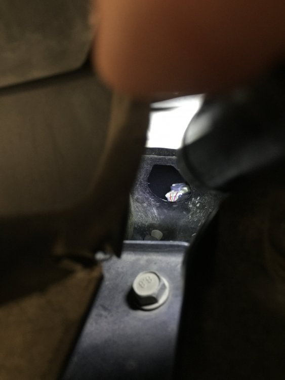

Hole in Firewall after rubber and 2.5” grommet have been removed:
A closer shot. You can see where the rubber mat was removed:

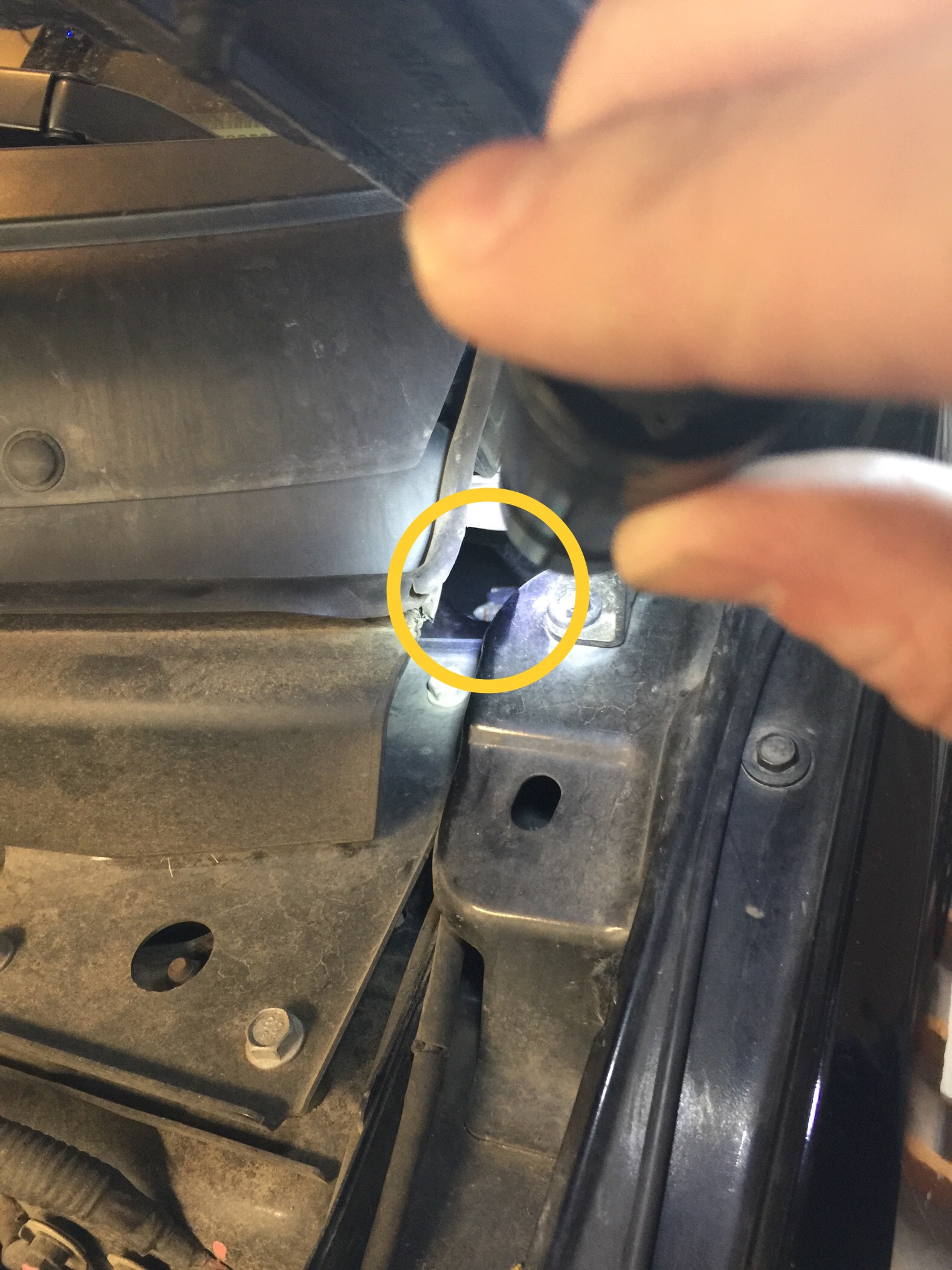

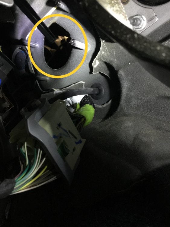

From the hood (driver’s side):
A closer shot from the hood:

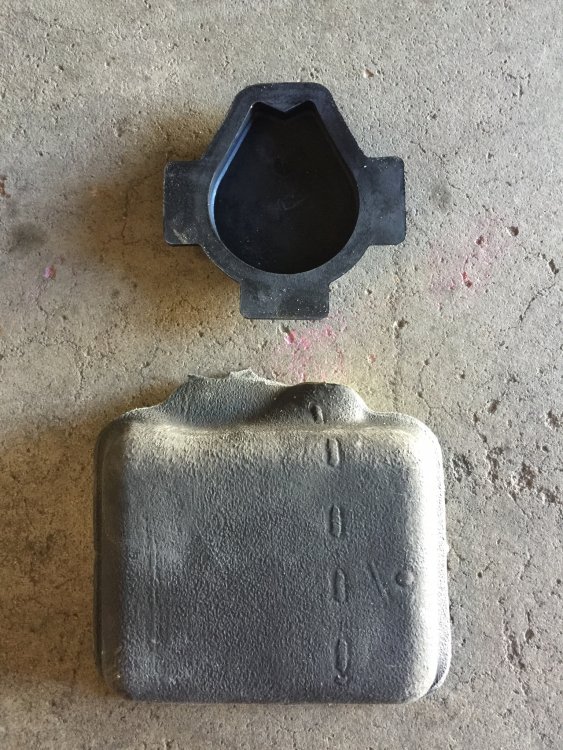

The 2.5” grommet (top) and square rubber piece that hides the grommet:

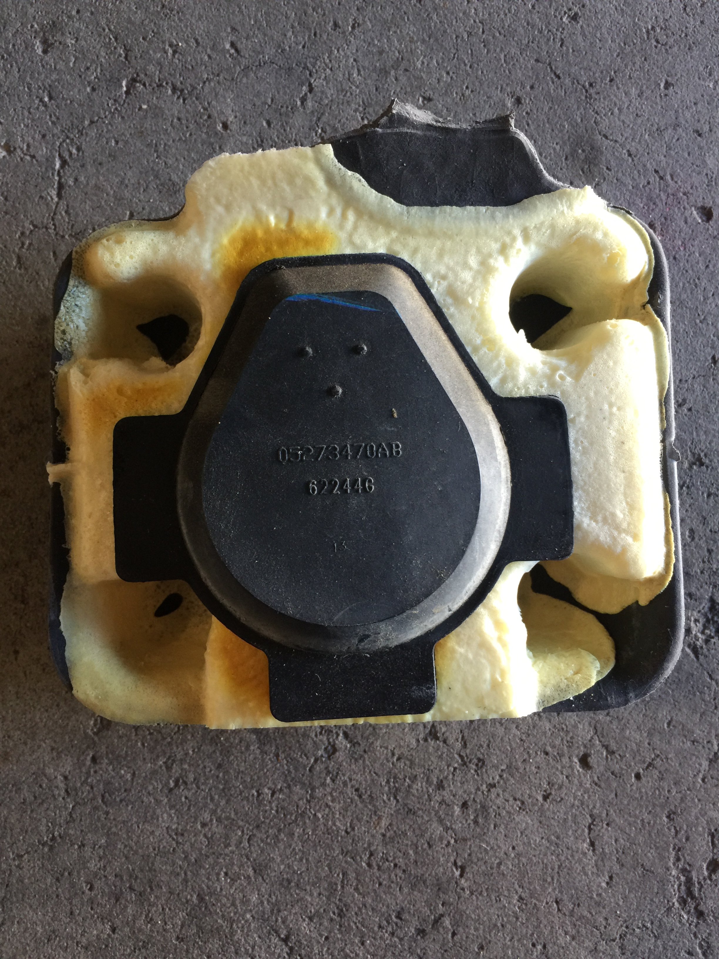

Just to show how they fit together while installed:
