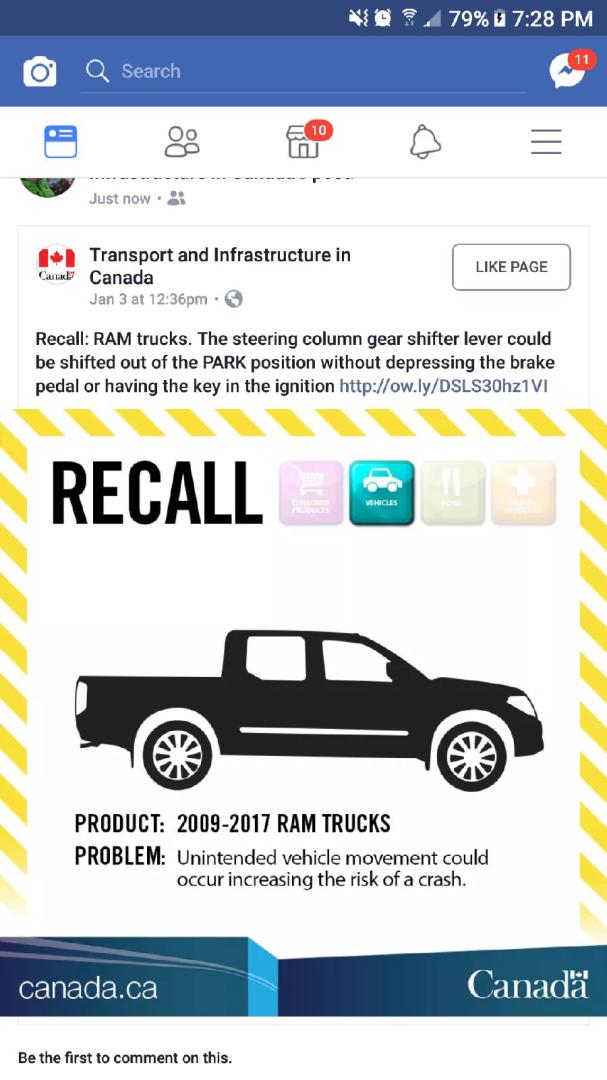

grice Posted January 5, 2018 Report Share Posted January 5, 2018 (edited) And Dodge didn't believe me when 4 years ago my wife's 2011 dodge journey R/T rolled backwards 15 feet into a fence when it was left idling in park. HUH, I Think a big fat I TOLD YOU SO is in order. Edited January 5, 2018 by grice Quote Link to comment Share on other sites More sharing options...

lmoore1436 Posted January 5, 2018 Report Share Posted January 5, 2018 17 hours ago, grice said: And Dodge didn't believe me when 4 years ago my wife's 2011 dodge journey R/T rolled backwards 15 feet into a fence when it was left idling in park. HUH, I Think a big fat I TOLD YOU SO is in order. Sorry to hear about what happened to your journey, but this is a completely unrelated problem. No automaker is going to take the hit for a something that occurs only once, especially something where they aren't able to confirm what happened. Every automaker comes across issues like these. 2005 Ford Explorers caught on fire when cruise control was turned on, 2014 GM cars would switch off on the highway while driving, Toyotas and Lexus cars accelerated on their own in 2009 are just a few instances. did you take it to the dealership to get it looked at and see if they could find a defect? Below is what the recall for RAM trucks is about. "Fiat Chrysler said the issue applies to shifters mounted to steering columns, not rotary-dial shifters or floor-mounted shifters. The issue arises when the brake pedal is pressed for a long stretch while the driver is idling in park mode, disabling the brake-transmission shift interlock and then allowing the shifter to move out of park mode." jkeaton and mechanical-idiot 2 Quote Link to comment Share on other sites More sharing options...
