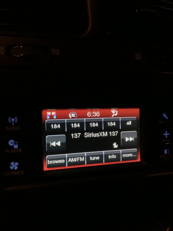

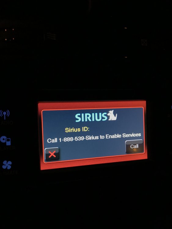

AtilaPS Posted January 26, 2018 Report Share Posted January 26, 2018 I bought a 2017 Dodge Journey and am trying to activate my SiriusXM for three days. But it seems to me that the system seems frozen in station 137 (SiriusXM). Everything works, except SiriusXM, I can not feel any other channel. When I go to settings-sirius setup-subscription info, in the Sirius ID field, nothing appears, just the msg Call 1-888-539-Sirius to enable sevices. I have already registered with Sirus and my registration is active.My radio is a Uconnect 4.3 whiteout Bluetooth. Can anybody help me? Quote Link to comment Share on other sites More sharing options...
jkeaton Posted January 26, 2018 Report Share Posted January 26, 2018 (edited) Need to call them and have them resend the activation to it. It is literally telling you what you need to do. Edited January 26, 2018 by jkeaton larryl and OhareFred 2 Quote Link to comment Share on other sites More sharing options...
AtilaPS Posted January 26, 2018 Author Report Share Posted January 26, 2018 I'm already did it 5 times, but dosen't work. Another problem is I can't change the station to XM 184 to receive a signal. Quote Link to comment Share on other sites More sharing options...

larryl Posted January 26, 2018 Report Share Posted January 26, 2018 Unhook the negative battery post for 10 minutes then try again maybe its frozen AtilaPS, OhareFred, 2late4u and 1 other 2 2 Quote Link to comment Share on other sites More sharing options...
AtilaPS Posted January 26, 2018 Author Report Share Posted January 26, 2018 Tks Larry, I did this and the radio works perfectly. 2late4u, OhareFred and jkeaton 1 1 1 Quote Link to comment Share on other sites More sharing options...

bramfrank Posted May 6, 2018 Report Share Posted May 6, 2018 Well, if that image with the blank ID has't been retouched, your first clue would have been the missing serial number. If cycling power hadn't brought it back a replacement radio would have been the next step. I did not renew my subscription when the traffic (which we don't normally get in Canada, but which I talked them into turning on) was shut down - now I use Waze and with 5,000 songs in the ipod in my armrest, miss nothing. PitCarver 1 Quote Link to comment Share on other sites More sharing options...
