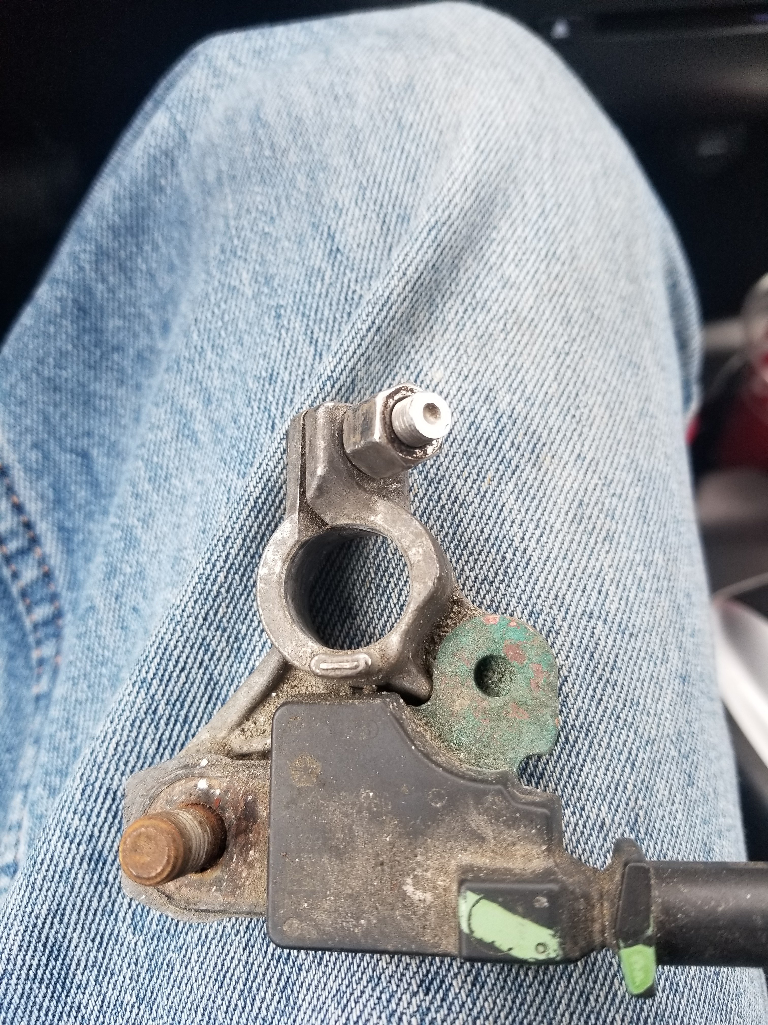

winger1050 Posted March 7, 2018 Report Share Posted March 7, 2018 Hey guys 2012 sxt 3.6 I started having lights flickering and before i even had a chance to look into it the next day she wouldnt start. Checked the obvious battery (good) alternator (good). Here is where i am at she will stay running ONLY while on a jump from the top. If i try to jump from the battery itself she wont get anything. I literally have no power no anything unless i've got the cables to the top posts. I ordered a new battery temp sensor to rule that out but still not sure of that one. All my grounds are good. I am stumped all i want is to at least get this toilet running. Any suggestions would be great. Thanks ahead guys Quote Link to comment Share on other sites More sharing options...
jkeaton Posted March 7, 2018 Report Share Posted March 7, 2018 Check all the cables and connections. Quote Link to comment Share on other sites More sharing options...
OhareFred Posted March 8, 2018 Report Share Posted March 8, 2018 I recall someone else having a problem like this and it was the battery sensor on one of the cables. Try replacing your cables from the battery to the jump posts and fuse box. Try a forum search, you should be able to find LOTS of no start subjects. 2late4u and mechanical-idiot 1 1 Quote Link to comment Share on other sites More sharing options...
winger1050 Posted March 14, 2018 Author Report Share Posted March 14, 2018 Just thought I would update everyone. I went ahead and replaced the battery temp sensor which was my suspicion. That was the problem she's running great. NavalLacrosse, OhareFred and 2late4u 2 1 Quote Link to comment Share on other sites More sharing options...

winger1050 Posted March 14, 2018 Author Report Share Posted March 14, 2018 It's basically your negative battery terminal. Took me 5 minutes to replace. 80$ Quote Link to comment Share on other sites More sharing options...
winger1050 Posted March 14, 2018 Author Report Share Posted March 14, 2018 2late4u 1 Quote Link to comment Share on other sites More sharing options...
