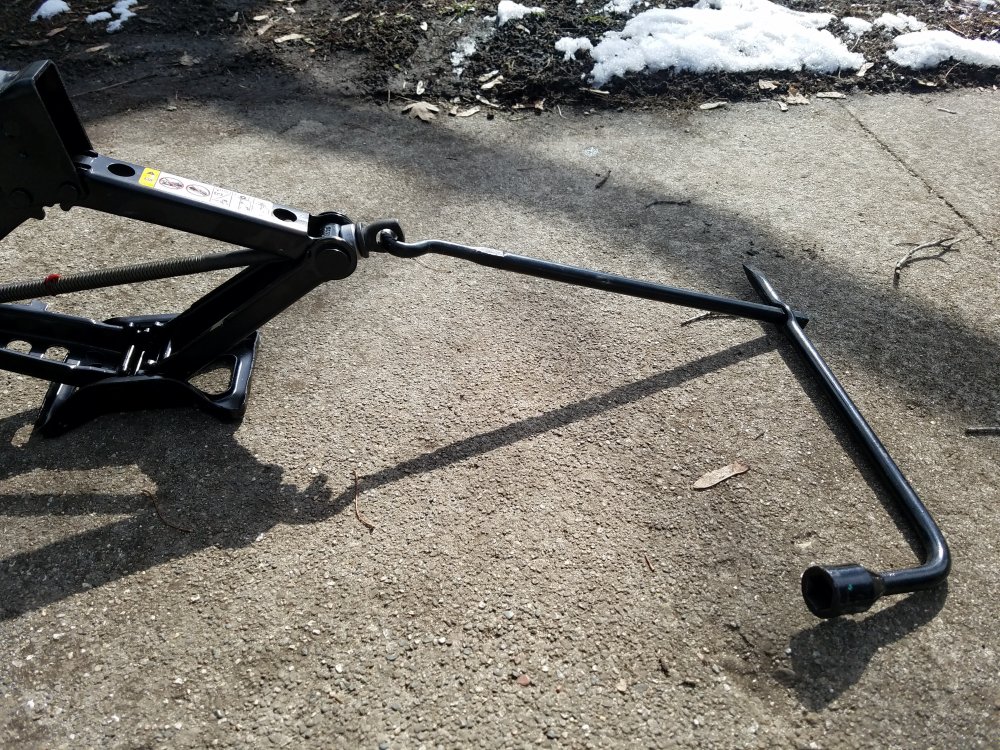

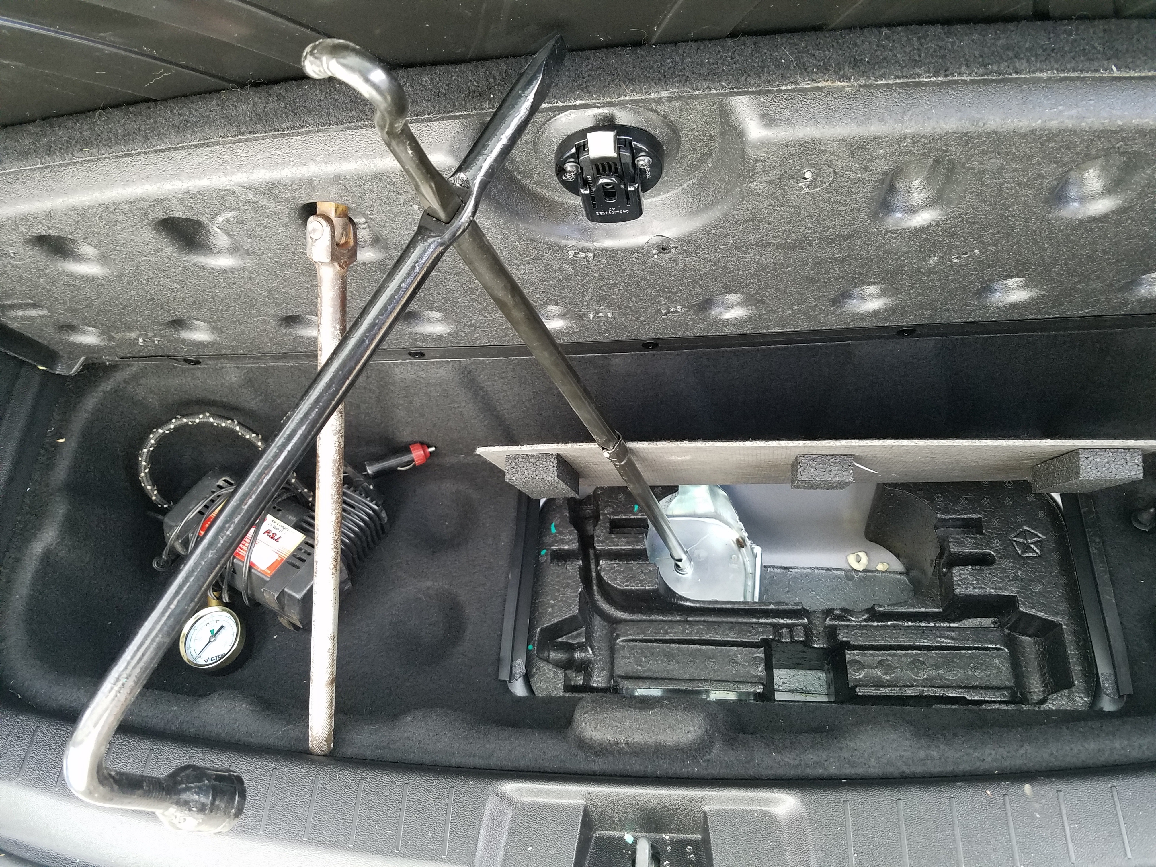

Summer Solstice Posted March 11, 2018 Report Share Posted March 11, 2018 (edited) I had my first flat tire on the Journey last week. Fortunately, it was in the parking lot at work and not on the road. It was also far better weather than it was the day before. A glass half full is better than a glass half empty. For those who have not yet had the pleasure of changing a tire on the Journey, I took a few pictures so that you could live vicariously through my experience. The tools are all packed neatly under the floor just inside the rear door. The crank to lower the underbody spare tire is inside of this compartment under one of the extension bars. It is fully accessible once the tools are removed. The tools are assembled in various configurations to achieve each step of the tire change process. Edited March 11, 2018 by Summer Solstice Quote Link to comment Share on other sites More sharing options...
Summer Solstice Posted March 11, 2018 Author Report Share Posted March 11, 2018 The crank will lower the spare all the way to the ground. The cable is long enough that the tire can be pulled out from under the vehicle before removing the cable. The jack is a typical spare offering that does the job. It is a bit cumbersome to use but is adequate for the job. The notch on the top plate of the jack fits on the underbody lip that runs the entire side of the journey. It works just fine as long as care is taken to keep the jack level and steady during the process. The extension handles are a bit wobbly, but again do the job. Quote Link to comment Share on other sites More sharing options...

Summer Solstice Posted March 11, 2018 Author Report Share Posted March 11, 2018 All of the directions are decently laid out in the owners manual. The pictures, however, leave a lot to be desired. I have driven a lot of donuts in my time (and eaten even more). I have pushed them far harder than the recommendations written on the side. Though I am no fan of the stock Kumho tires (for the same reasons that others have addressed before) they sound and ride far better than the spare. I kept my speed at 65 on the highway all the way home and on to Discount Tire. Shameless plug here....Discount treated me very well, as always. The tire was fixed for free and installed back on the vehicle. The tire sensor reset within a couple of miles and all is well again. The smooth, quiet ride that was the selling point of the Journey is back. PitCarver 1 Quote Link to comment Share on other sites More sharing options...

Summer Solstice Posted April 14, 2018 Author Report Share Posted April 14, 2018 On 3/22/2018 at 6:00 AM, probak118 said: I would be a little pissed at having a flat rather than think about taking pictures ? But like you said, could not have been better spot to have a flat. You can be sure that I did not take these pictures while changing the tire. The first and only thing on my mind was getting the spare on, getting the tire fixed, and getting this in the past as quickly and painlessly as possible. I'm not that nuts...yet. I did take the pictures the next day before cleaning up the tools and putting them away properly. My primary interest was for those, like me, that have never had an SUV or an underbody spare tire. The owner's manual is decently written but the images are sorely lacking in quality. The tools provided are adequate for the job but are a bit of a puzzle to assemble. Best to bring along a 5 year old (so simple a 5 year old can do it). I did figure it out so maybe I qualify. Changing a tire is never fun but I have had plenty of experience in far worse conditions. Hopefully, this just makes it a little easier for the next person. Quote Link to comment Share on other sites More sharing options...
