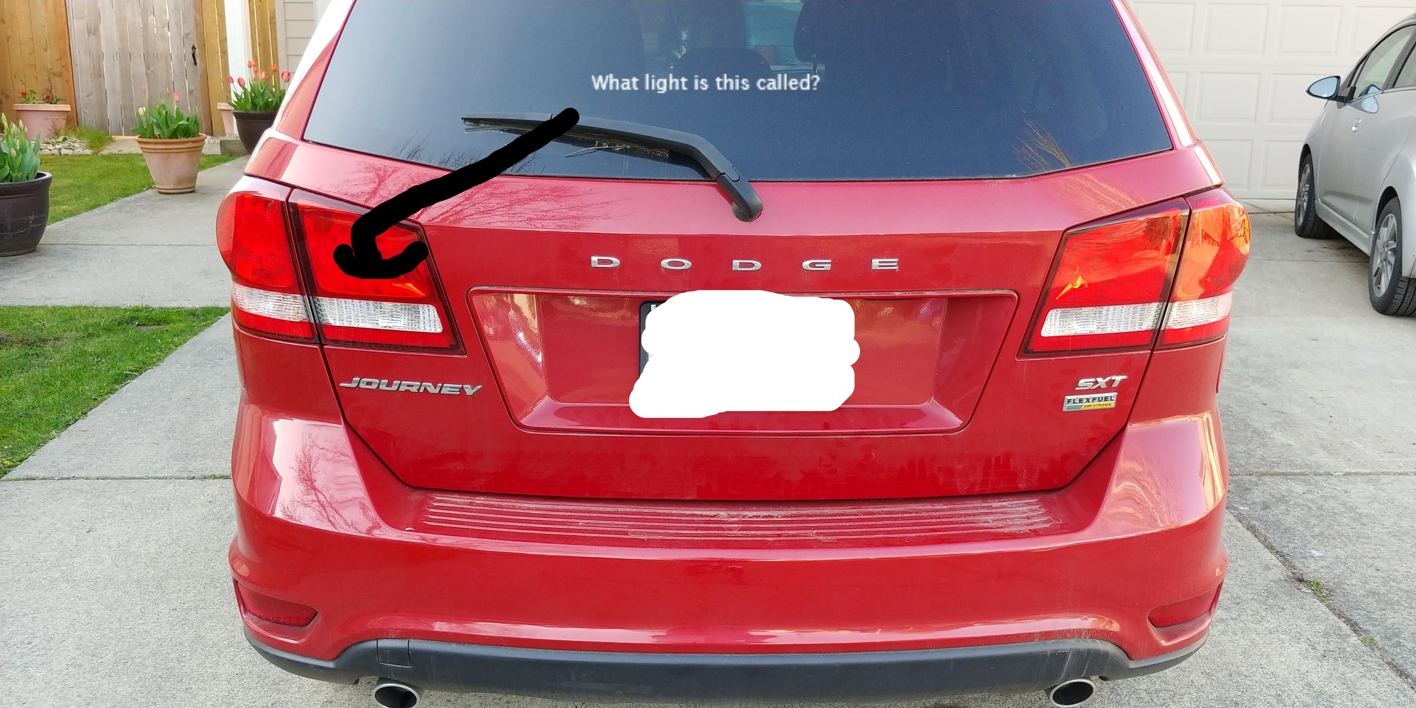

wadekilpatrick Posted April 1, 2018 Report Share Posted April 1, 2018 Hi everyone. Newbie here. We have a 2015 Dodge Journey with 65,000 miles on it. I have noticed when the lights are on, the reg light where the arrow is pointing is not on. I tried changing the bulb thinking that was the problem but it still won't light up. The reverse light also does not light up on that LEFT side as well. Any suggestions as to what this is called or what might be the problem? Thanks Wade Quote Link to comment Share on other sites More sharing options...
larryl Posted April 1, 2018 Report Share Posted April 1, 2018 you might have broken wires in the the hatchback wire harness leading from the cabin into the hatch jkeaton and OhareFred 1 1 Quote Link to comment Share on other sites More sharing options...
Armando G Posted April 1, 2018 Report Share Posted April 1, 2018 That would be your parking light. Quote Link to comment Share on other sites More sharing options...

wadekilpatrick Posted April 1, 2018 Author Report Share Posted April 1, 2018 Thanks for the replies. Is there an easy way to check this or is this something that needs to be taken to a mechanic to do? Quote Link to comment Share on other sites More sharing options...
2late4u Posted April 1, 2018 Report Share Posted April 1, 2018 you can check it yourself it has been discussed here check the forum for info on how and what to check for or take it to the dealership or local garage that does electrical work.. jkeaton 1 Quote Link to comment Share on other sites More sharing options...
redtomatoman Posted April 2, 2018 Report Share Posted April 2, 2018 I may be wrong. Too lazy to go out to the garage and check, but I don't believe that those lights come on with the headlights. I think those are brake lights only. Others will chime in if I am incorrect. Peace. Quote Link to comment Share on other sites More sharing options...
redtomatoman Posted April 2, 2018 Report Share Posted April 2, 2018 Just reread your post. Didn't see the reverse light not working. Dunno. Check other DJ when you're on the road to see what their light do. Peace. jkeaton 1 Quote Link to comment Share on other sites More sharing options...
