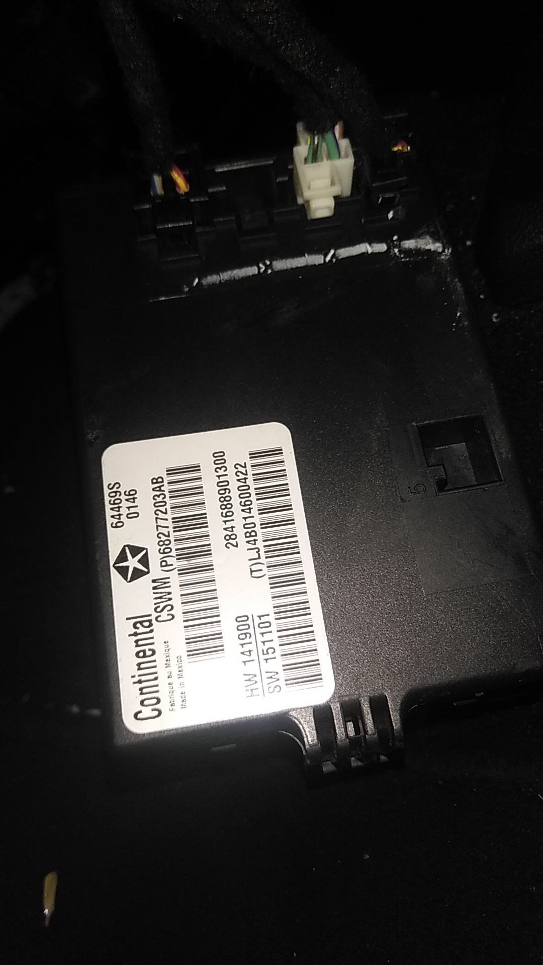

DizzyR/T Posted April 12, 2018 Author Report Share Posted April 12, 2018 What is this box under driver seat this box kept falling and now it's a lil dented wonder if this is my problem anyone know what this is? Quote Link to comment Share on other sites More sharing options...
2late4u Posted April 12, 2018 Report Share Posted April 12, 2018 13 14 15 16 2013-2016 Dodge Ram 1500 Truck Towing Chassis Control Unit Module is what comes up on e bay for the part #64469s took me about 4 minutes with google to find this..... jkeaton 1 Quote Link to comment Share on other sites More sharing options...

DizzyR/T Posted April 12, 2018 Author Report Share Posted April 12, 2018 Ok I thought that was the issue since it was slightly dented. Been driving most ofthe day. Also the box of hot to the touch uncomfortably hot thought I hit jackpot on my problem. I'm going to see if I locate the module for the heated seat pull it out and bring it to my buddy see if it's damaged. Quote Link to comment Share on other sites More sharing options...
DizzyR/T Posted April 12, 2018 Author Report Share Posted April 12, 2018 So I had it pulled out the car metal was touching the mother board inside. Reshaped it but it might be done. Couldn't tell if anything was shorted out. Found out it's not for the towing chasis control unit. Apparently I shouldnt have any parts from ram in the journey. Now to figure out if I order 1 when I got time and money to spare cuz summer here I don't need it. But I'm trying to fix it as soon as I can. I looked up the part and keep seeing the freemount (Fiat version) of this part. Quote Link to comment Share on other sites More sharing options...
DizzyR/T Posted April 12, 2018 Author Report Share Posted April 12, 2018 Ok so this is my problem who ever designed this is not the smartest person. This box is mounted right under the seat and the yellow foam is the only protection they provided. You can see the board is burnt from the metal touching it. Funny part is this was one of my issues months back when I got the car. Wires are too short to relocate the box, the box always fell out. Design flaw. I think so. Quote Link to comment Share on other sites More sharing options...
