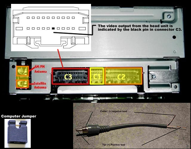

2016RT Posted April 11, 2017 Report Share Posted April 11, 2017 On 4/15/2008 at 7:33 PM, Lurch said: OK so here is a quick write up on how to get the DVD video signal off of your stock 6 disk radio unit. (this will not work with the RES model) The picture I made shows which pin on the radio supplies the video out signal. The trick was how to attatch a cable to that pin. Well being the computer teacher/nerd that I am I had some jumpers lying around(lower left picture). I then clipped off the end of an RCA cable (12ft cabels)and stripped back just enough to put the center wire of the RCA through one side of the computer jumper and crimped it(smashed that one side of the jumper) using a pair of needle nose pliers. If you use this same method make sure that you cut away the negative wiring on the RCA so that it doesn't cause a short. Then use electrical tape to tape the jumper and RCA wire to ensure it dosent come loose. Then use the needle nose pliers to slide the uncrimped half of the computer jumper onto the indicated pin and you have video. Expand Hey all, I just bought a 2016 RT with the 3.6 ltr. V-6. I have the large screen head unit, I quess the 8.4? My question is; can I hook up a rear camera and use main screen to view?, and as it only has one (1) DVD/CD slot under head unit can I view a DVD on it? I don't know what radio I have, It appears to have everything, except Nav. Any advice would be great. Thanks Quote Link to comment Share on other sites More sharing options...

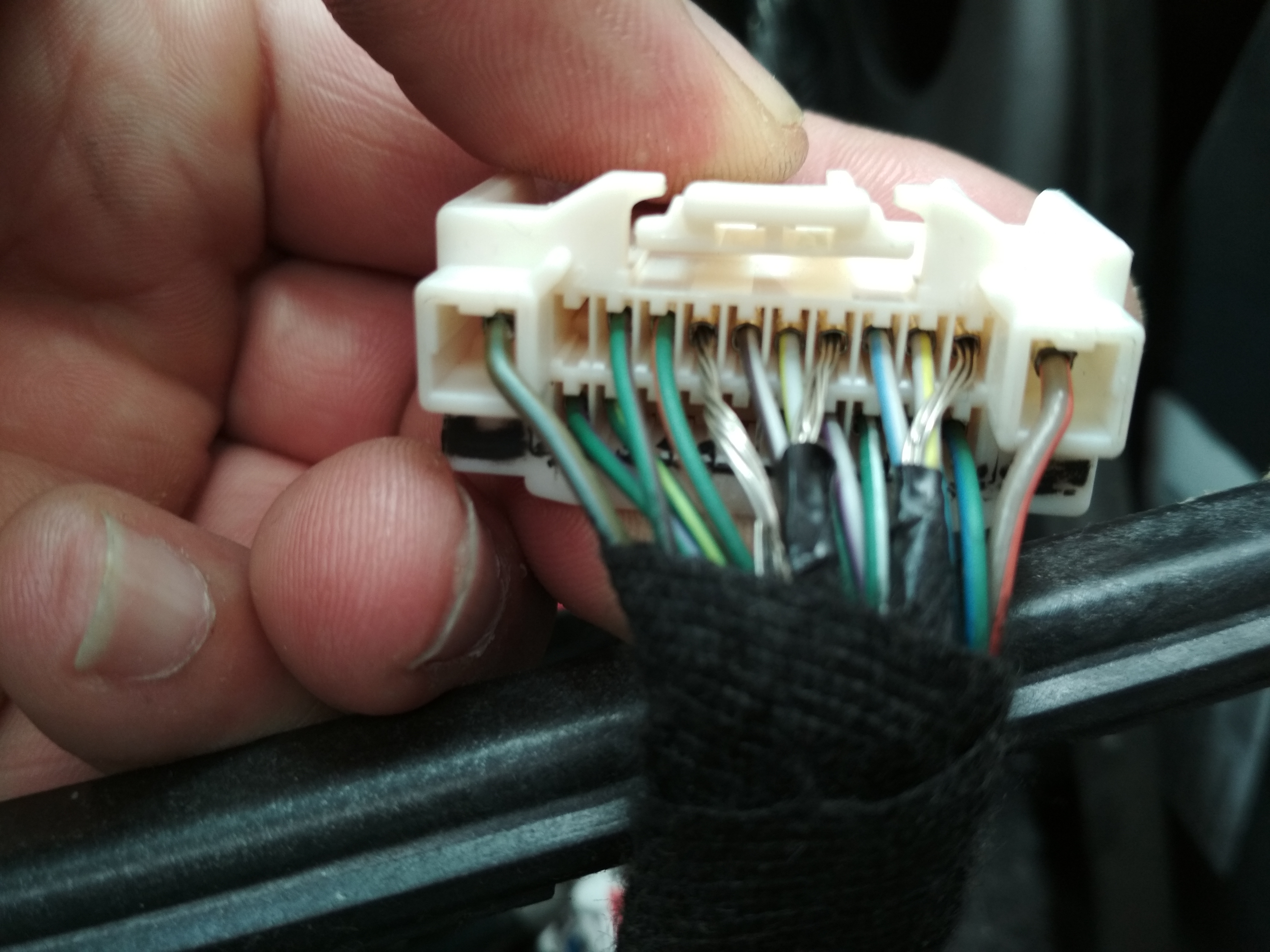

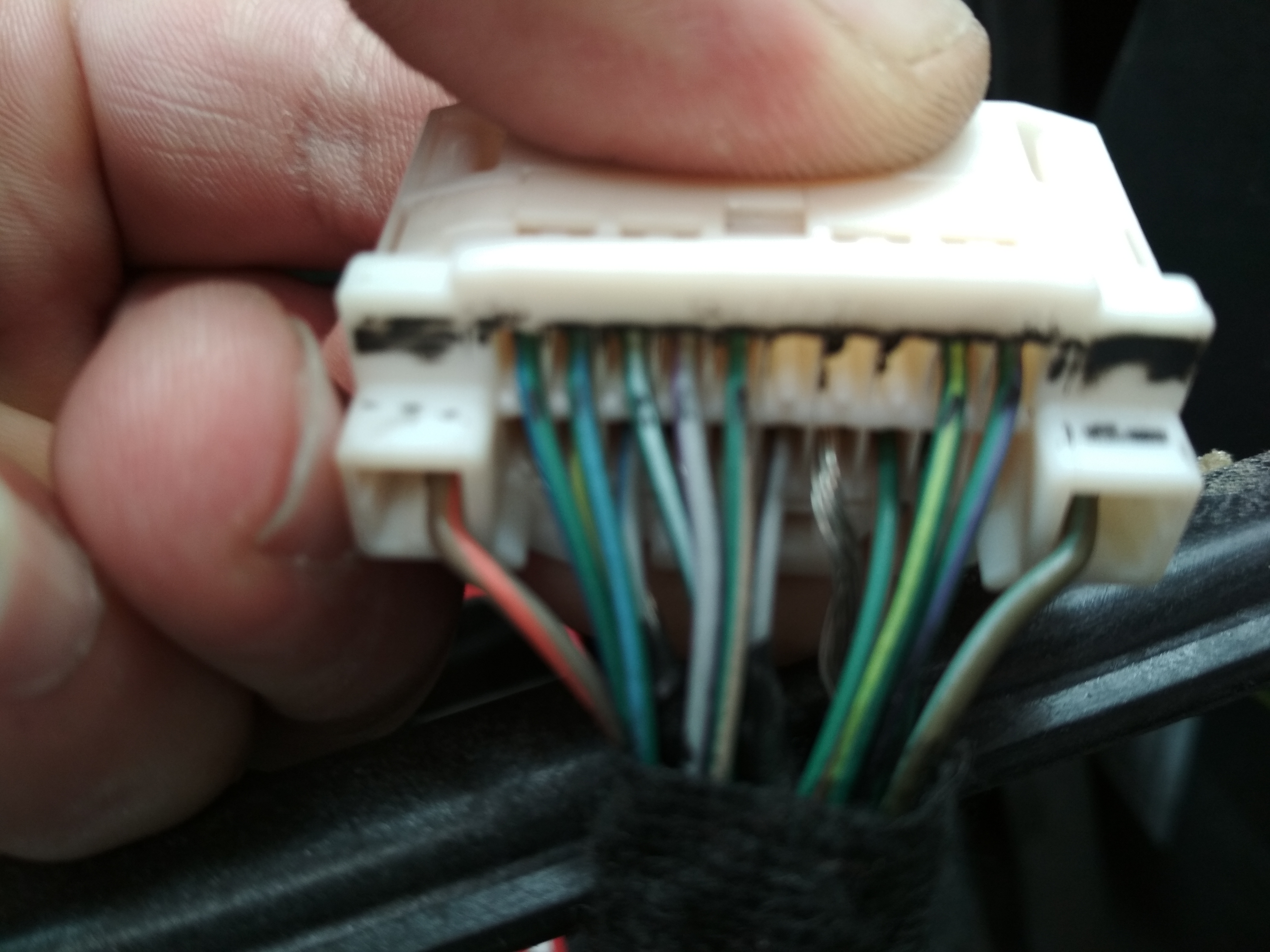

rangeatope Posted June 1, 2018 Report Share Posted June 1, 2018 HELLO, pardon for my English poor person. I write from españa. Photo of my connector of my Req CD6/DVD journey 2009. It can say that pins to connect exit of video to Dvd player Quote Link to comment Share on other sites More sharing options...
