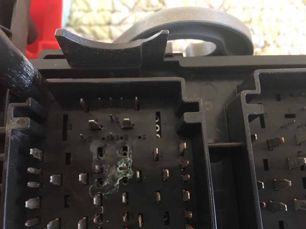

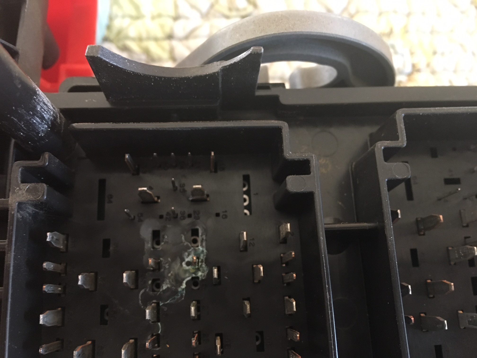

Mudshack Posted May 30, 2018 Author Report Share Posted May 30, 2018 Update. I picked the DJ up from the dealership. They agreed to show me what was the issue. And all the service manager did was point and say it is all corroded underneath where you can't see it. See attached picture of what he pointed at. So, I am guessing this is the Power Distribution Center. I plan on figuring out how to disconnect it and look under it and clean any corrosion that may be under there. I have worked on most of my own cars over the past 25yrs. But these new cars baffle me. I can't even figure out where the battery is to disconnect it.......yet. Google/Youtube are my friend. BTW - the DJ shifted just fine on the way home. No issues. Quote Link to comment Share on other sites More sharing options...

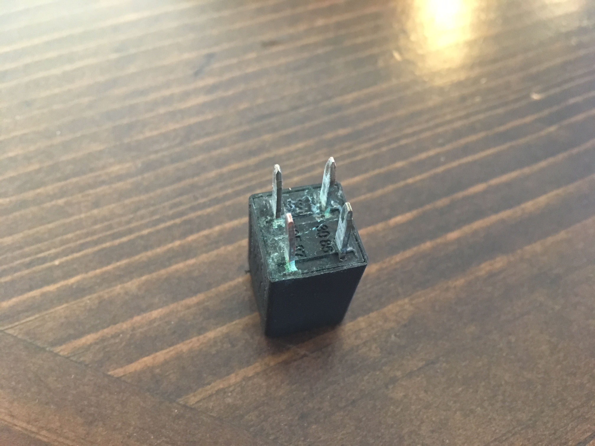

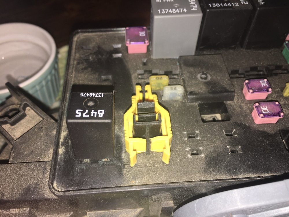

Mudshack Posted May 30, 2018 Author Report Share Posted May 30, 2018 Update. I figured out how to remove the TIPM/Power Distribution Center from the vehicle. When I did, I verified that the dealership was right. The Powertrain Control Module was corroded. Turns out it was a light corrosion on the copper pegs. I used light vinegar and a toothbrush to get all the corrosion off. I cleaned off the exterior of the TIPM/PDC and then on the underside where all the narrow pegs come out of the unit there was light corrosion as well. I cleaned that up. Unfortunately I couldn't get inside the TIPM/PDC to see if there was corrosion internally (which I am sure there is). But all contacts are now cleaned. If the shifting issue comes back I will clean again. I will keep cleaning until I need to replace the TIPM/PDC. It is a $400 part that litterally plugs in. 5min fix. Enjoy the pics. I just hope that if anyone has this issue that they can use this thread as a reference. Shoot, I should probably make a Youtube video (my first) explaining it all. I only say this because in nearly 24hrs of searching, I found not one reference to this issue nor how to fix it. larryl and 2late4u 1 1 Quote Link to comment Share on other sites More sharing options...
