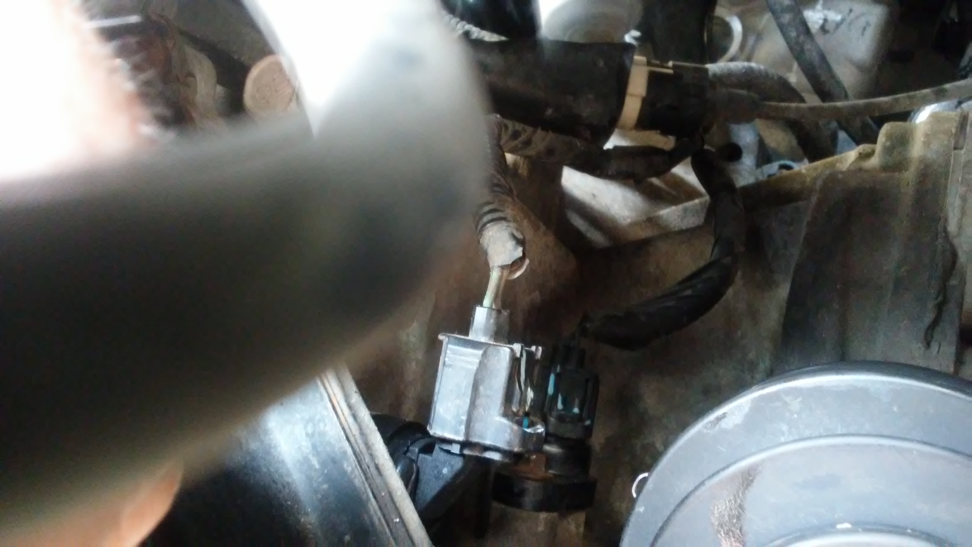

Armando G Posted July 1, 2018 Report Share Posted July 1, 2018 Any chance you took pictures of their location while you were down there? And congrats on getting it fixed. Quote Link to comment Share on other sites More sharing options...
machm1970 Posted July 1, 2018 Author Report Share Posted July 1, 2018 Here ya go, not the best pic though. Each one has 2 wires and one 8mm bolt holding it in. Matt 2late4u and Armando G 1 1 Quote Link to comment Share on other sites More sharing options...
