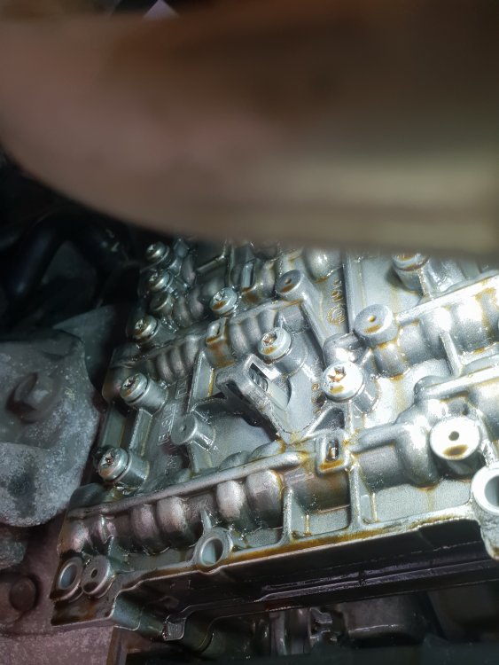

Cpwfos Posted July 9, 2018 Author Report Share Posted July 9, 2018 My work so far Quote Link to comment Share on other sites More sharing options...

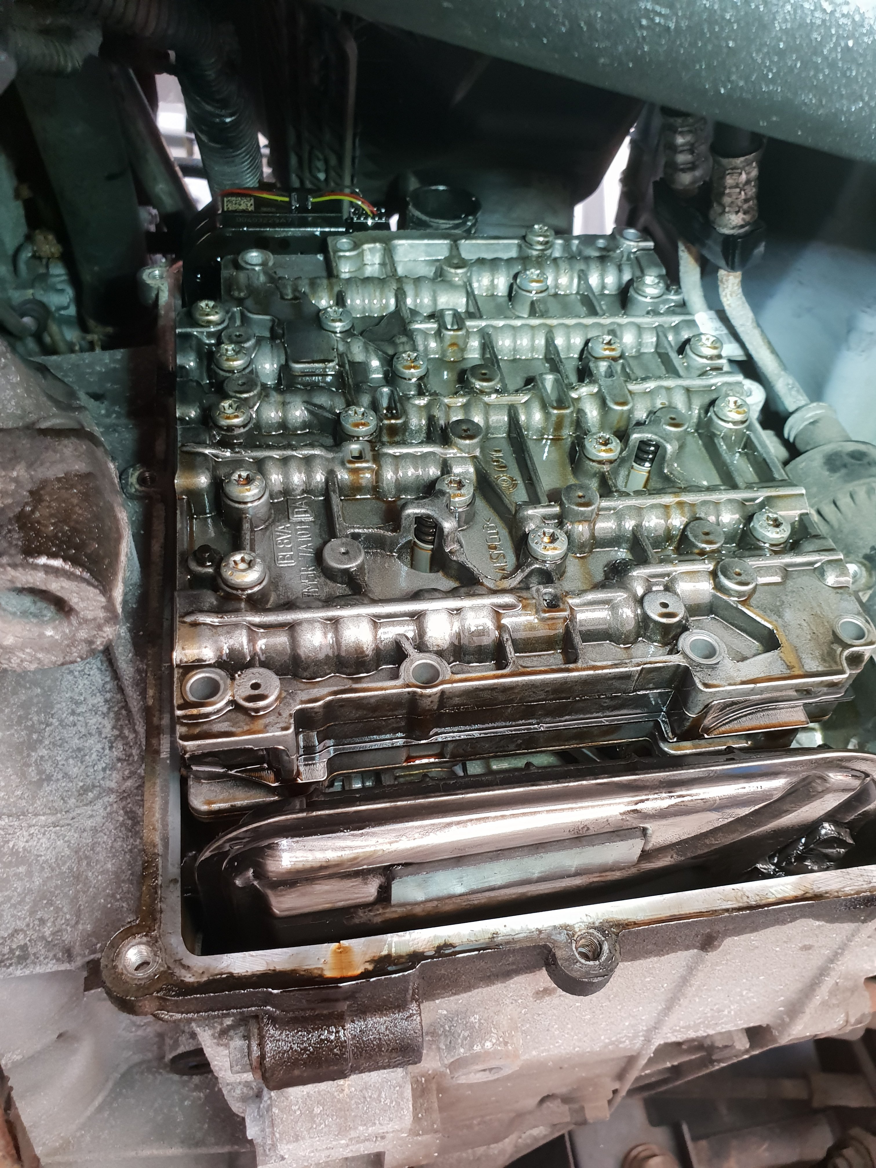

Cpwfos Posted July 9, 2018 Author Report Share Posted July 9, 2018 Took out the multi plug feeding the solenoid s and took off the black plastic side mounted sump tray, now I'm face with what you see in the pic which has about 25 torx screws holding it in place, this looking familiar to anyone? Quote Link to comment Share on other sites More sharing options...

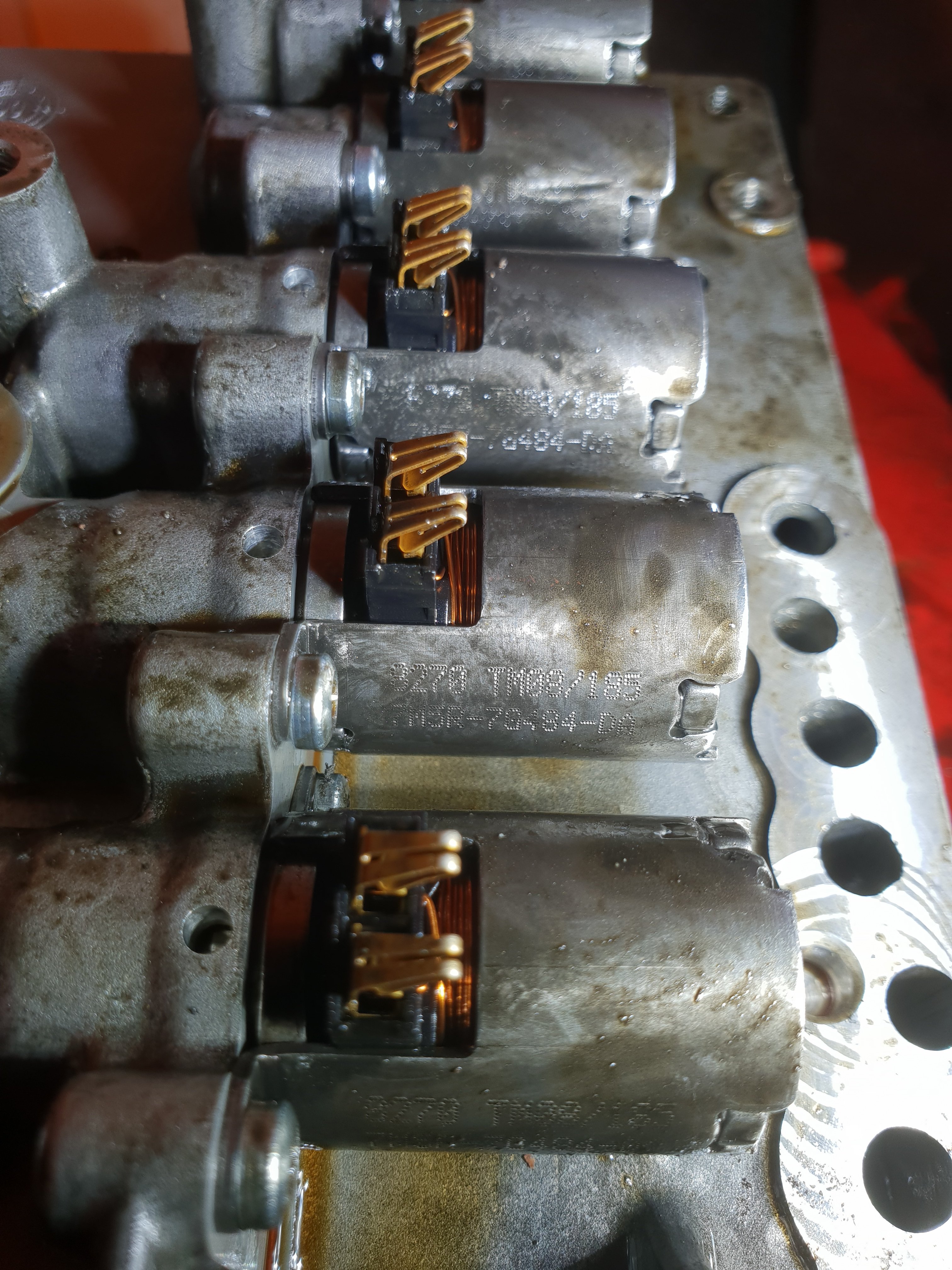

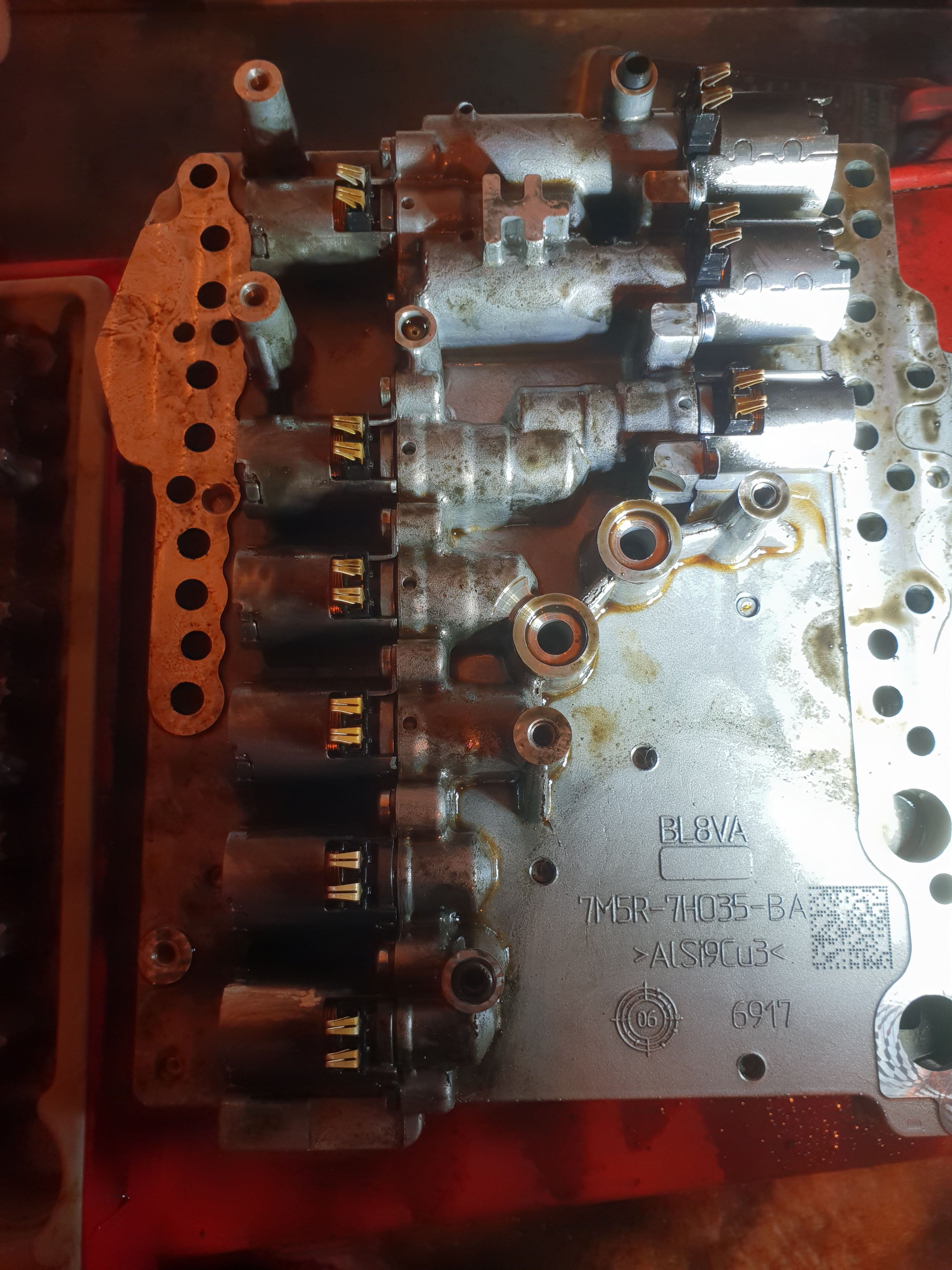

Cpwfos Posted July 11, 2018 Author Report Share Posted July 11, 2018 A little further on today, I removed the valve body and split it to find the control solenoids, I the did a continuity test across them all which came out as normal, then I removed them and blew them out with air and the channels from which they were removed hot blasted aswell after that I used a 12 volt supply to manually check they were all working which they were, was hoping to find a problem with at least one of them but it wasn't to be, hopefully I will get lucky and I have removed a blockage with the air Quote Link to comment Share on other sites More sharing options...
