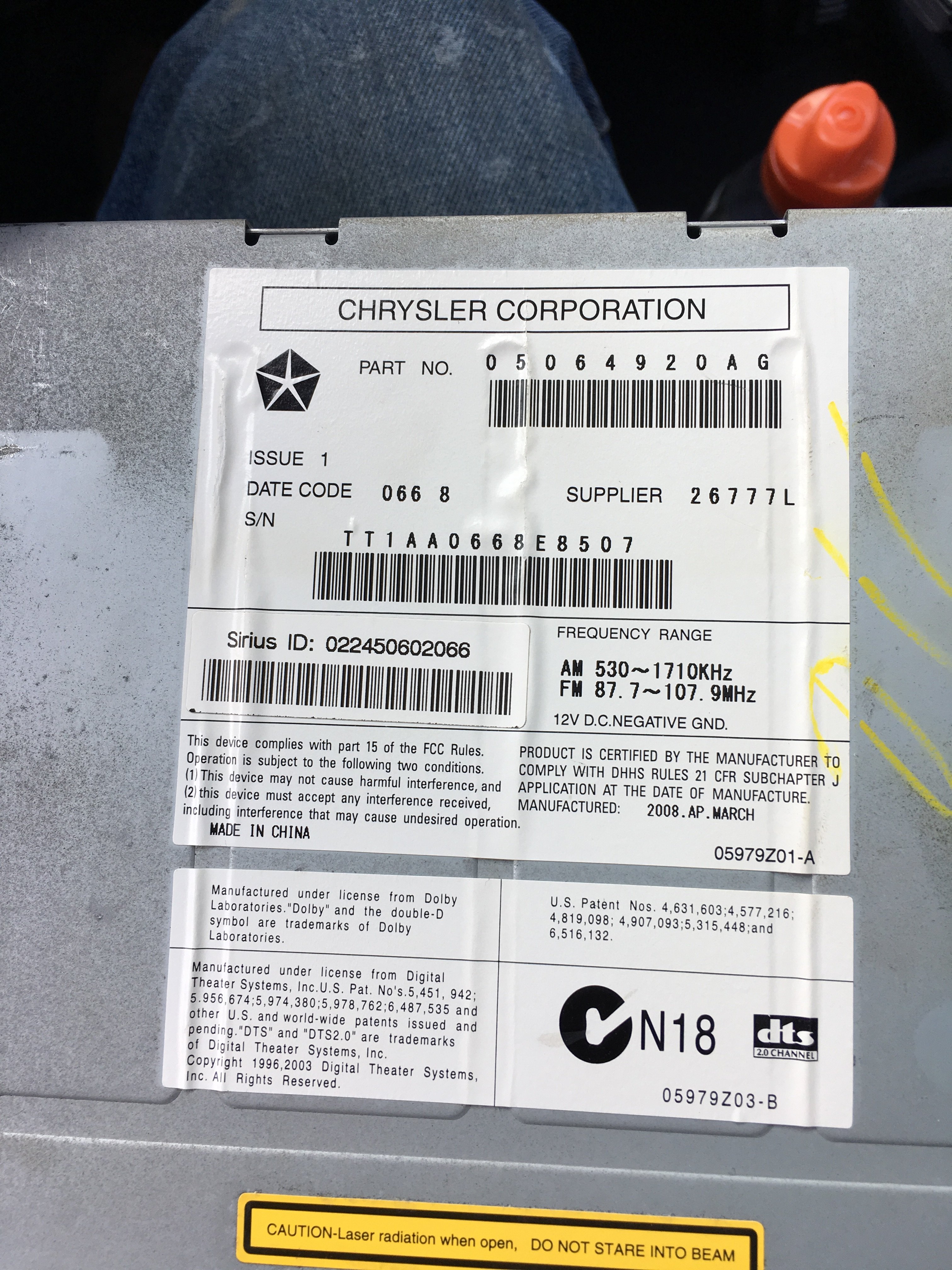

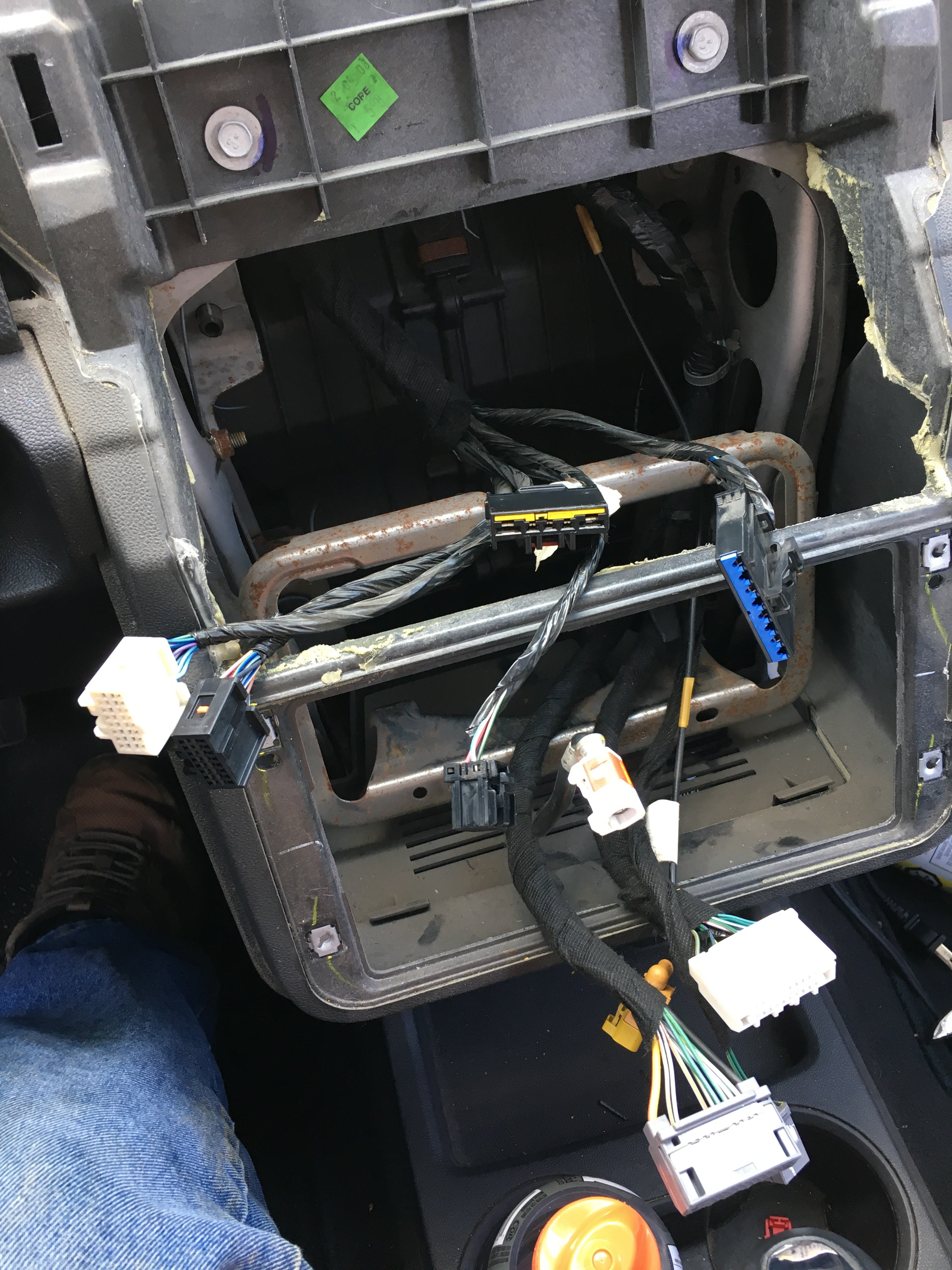

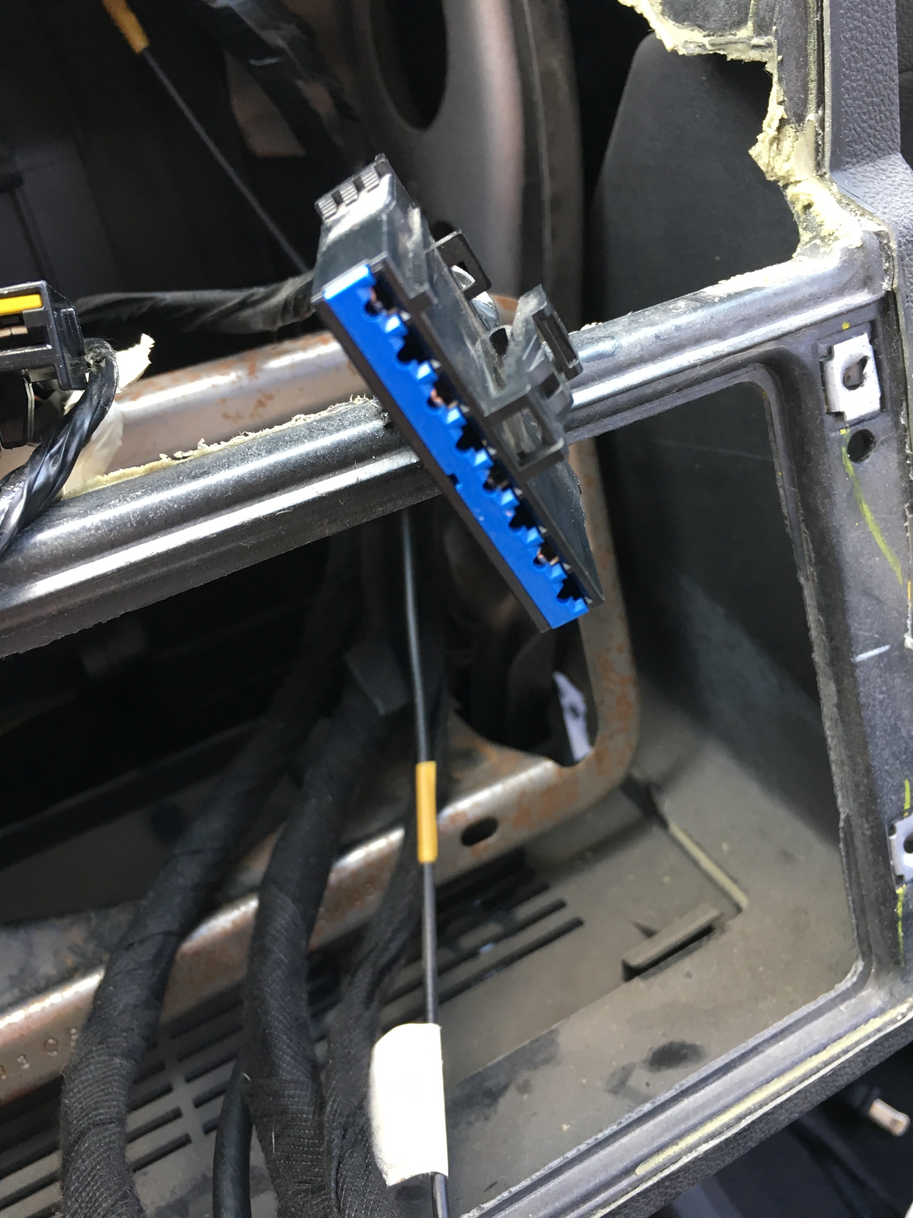

blissman20 Posted August 4, 2018 Report Share Posted August 4, 2018 Just picked up my 09 journey for $1,400 Canadian, it has its fair share of issues. While waiting on parts to come in I’ve decided to tackle or attempt to tackle some electrical. Currently the radio does not turn on or make a sound. The previous owner said it just quit. Upon removing the Radio shroud I saw the screws were missing that were used to hold the radio in which makes me wonder if this is even the correct radio for my journey. Anyways I went ahead and tested all the wires in the connectors and not one of the puts out 12V with the key on or running. And yes the M12? 30A fuse under the hood is good. Also there was a black and blue connector not connected to anything that puts out 12V Quote Link to comment Share on other sites More sharing options...
jkeaton Posted August 5, 2018 Report Share Posted August 5, 2018 Is that the correct connector for power? There are a bunch there. Quote Link to comment Share on other sites More sharing options...
blissman20 Posted August 5, 2018 Author Report Share Posted August 5, 2018 (edited) 34 minutes ago, jkeaton said: Is that the correct connector for power? There are a bunch there. After unplugging the dual climate controls and radio that’s what’s left. The blue and black wasn’t connected to anything. When I did the voltage testing with my multimeter one heavier wire was putting out 2v so I did a bench test and put 12V to it and the radio illuminated and made it sound like was trying to accept a disc. I’m wondering if the radio itself is shot Edited August 5, 2018 by blissman20 Quote Link to comment Share on other sites More sharing options...
