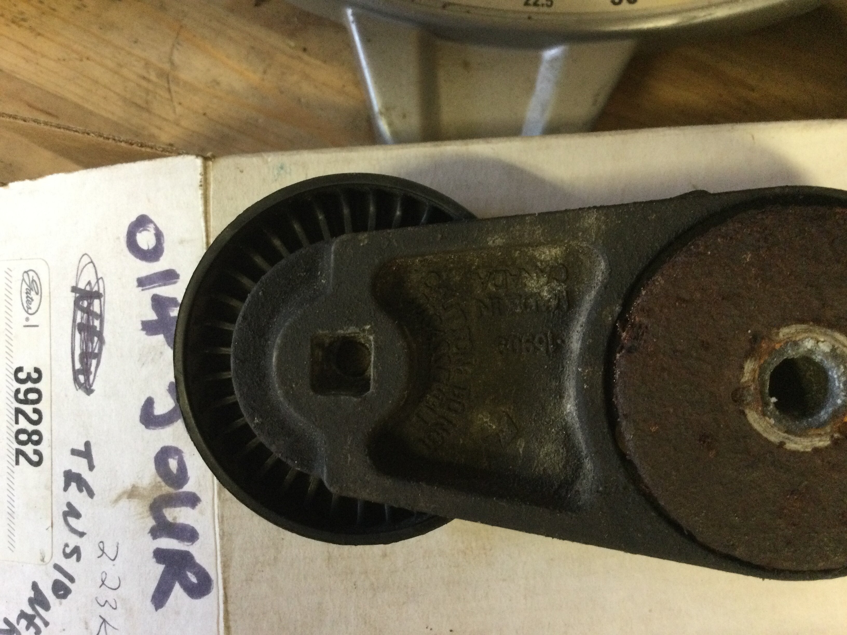

diymirage Posted November 7, 2024 Report Share Posted November 7, 2024 On 11/7/2024 at 3:13 AM, Karen jo said: Well it's day 3 I finally rented the tensioner bar to get that tensioner to let me put on the belt, now it's squealing and it slips 1 lip of the steering pulley smh, so I read to get the pulley on with semi loose bolts and steering left to right off the ground that is to make sure the pump is aligned then by hand screw bolts back on evenly to ensure alignment... so wish me luck Expand Good luck I thought most tensioners had a 1/2 inch hole that allowed you to put a breaker bar on there? Sounds like someone figured out a way to make it harder then it needs to be Quote Link to comment Share on other sites More sharing options...
John/Horace Posted November 7, 2024 Report Share Posted November 7, 2024 Good point, OP might not realize there is a 3/8” square cut out for a ratchet drive to fit in on tensioner. But very tight space to work in. I use a pipe extension on small ratchet. Need some of the plastic removed to even swing a tool. Pulleys are almost right against cross member on transverse mount engines, as you know. I replaced with a RockA Gates when bearing went, then belt squeeling. Quote Link to comment Share on other sites More sharing options...
