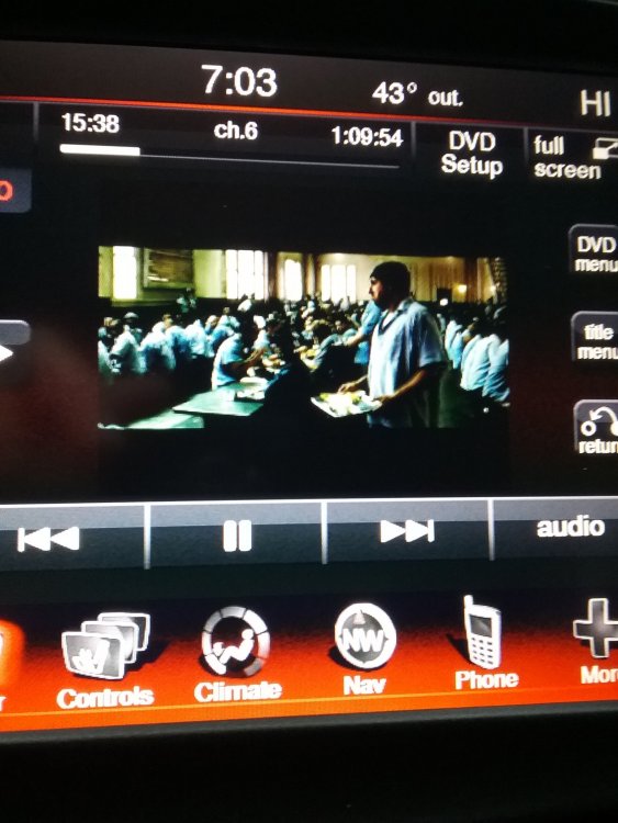

14WhiteRTRallye Posted November 7, 2018 Report Share Posted November 7, 2018 (edited) Mine shows on top left of Evic and on nav button on 8.4. No subscription needed. Plays dvds on the 8.4 too! Edited November 7, 2018 by 14WhiteRTRallye Quote Link to comment Share on other sites More sharing options...
jmferdin Posted November 7, 2018 Author Report Share Posted November 7, 2018 Yeah I dont have that on the EVIC. Anything special you had to do to play DVD on the 8.4 screen? Quote Link to comment Share on other sites More sharing options...
bramfrank Posted November 8, 2018 Report Share Posted November 8, 2018 1 hour ago, jmferdin said: Yeah I dont have that on the EVIC. Anything special you had to do to play DVD on the 8.4 screen? Yes. Put the vehicle in park. Quote Link to comment Share on other sites More sharing options...

14WhiteRTRallye Posted November 8, 2018 Report Share Posted November 8, 2018 Dvd works in drive too. But picture turns off when you start moving. The dvd keeps playing sound when moving. Quote Link to comment Share on other sites More sharing options...
