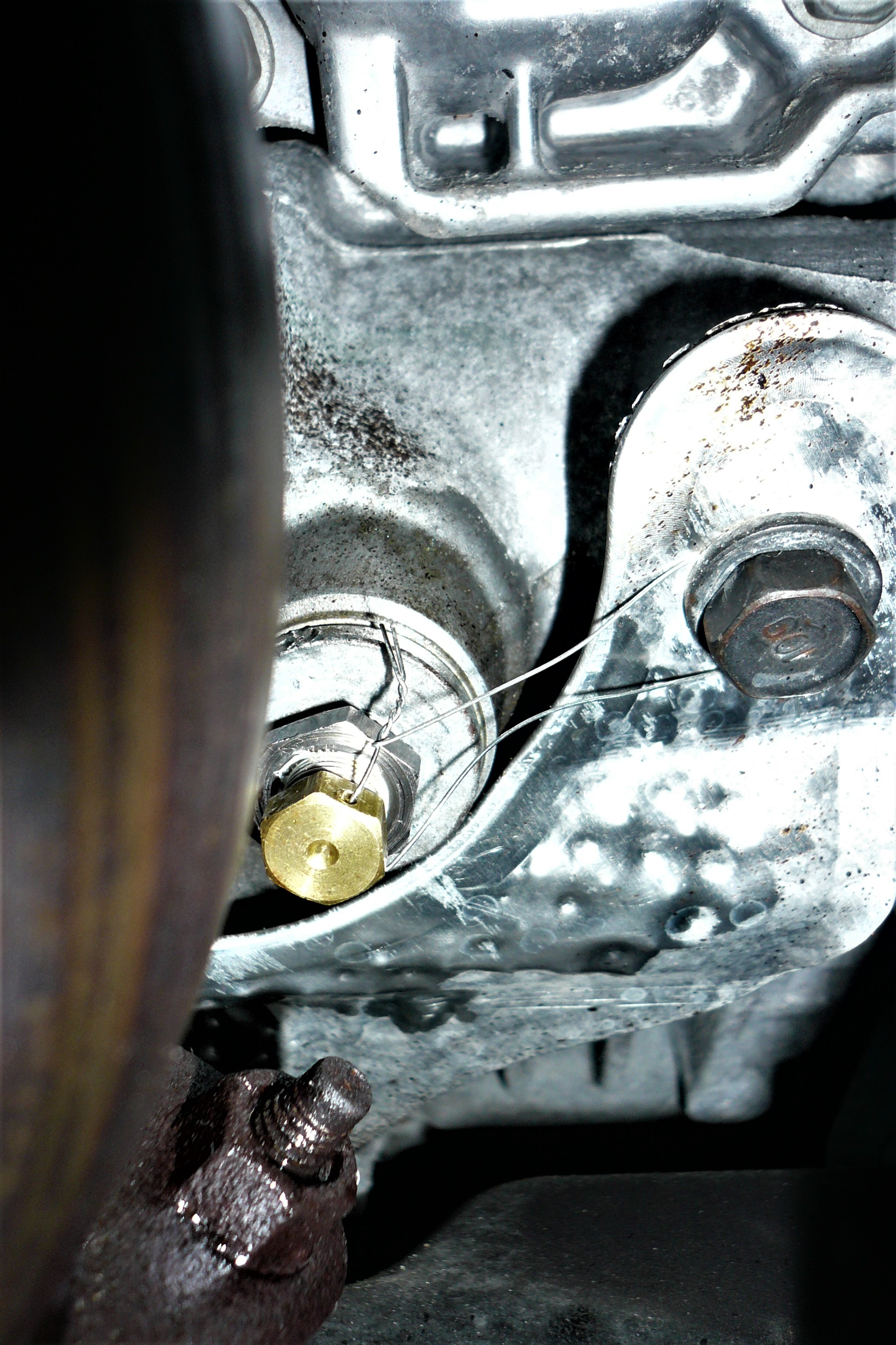

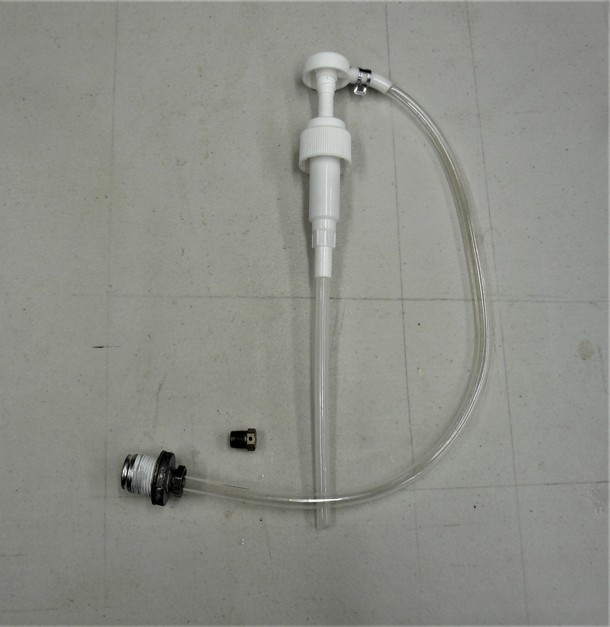

twinx1649 Posted January 26, 2019 Report Share Posted January 26, 2019 I changed the PTU fluid today and wanted to pass along some lessons learned. 1) It wasn't practical for me to fill the PTU using the fill plug, so I opted to modify the drain plug for fill/drain and it worked well. 2) Modification included drill/tap drain plug for 1/4" NPT to 1/8" NPT fitting and 1/8" NPT plug drilled for safety wire (see pix's). 3) I used Mobil 1 LS 75W-90 synthetic and warm it up first to help it pump easier. 4) Use oil transfer pump with longer 3/16 diameter pick-up tube so it can reach the bottom of the bottle https://www.amazon.com/gp/product/B000BQW5LK/ref=ppx_yo_dt_b_asin_title_o02__o00_s00?ie=UTF8&psc=1 5) Remove exhaust support bracket so you can get both hands in position to remove the fill hose, cover the drain hole after filling, and get the 1/8" plug threaded into the drain plug. I suggest you try this many times with a dry PTU... practice makes perfect... and less clean up. 6) Mark the bottle so you know when you reach the 28 oz. point. I added an additional 1 to 1.5 oz in case I spilled any while performing tube removal after filling. It should be noted that the fill hose had a snug fit into the pipe fitting so it sealed well. I added some electrical tape to the tube in case I needed to create a seal between the tube and fitting (see pix). I also used Permatex thread sealant #59214 (high temperature). 7) Use safety wire on the 1/8" pipe plug to keep everything in place since the installation torque will be lower because you'll be tightening the 1/4" NPT fitting to seat the factory drain plug. 8) Reinstall the exhaust support bracket and add a dab of antiseize to the exhaust bolt for future removal. Note: I recommend changing the fluid every 20K miles, that cat will cook the PTU fluid and changing regularly is cheap insurance. Additionally, I looked at using the PTU vent tube as a fill port, but it was easier to use the drain plug. You can use the vent tube but you can only add 2 oz. at a time until the trapped air in the PTU case is "burped" to allow the fluid to fill. Forcing the fluid with pressure will potentially create a leak path past one of the seals. TopperHarley, 2late4u, Summer Solstice and 1 other 1 1 2 Quote Link to comment Share on other sites More sharing options...

TopperHarley Posted June 19, 2019 Report Share Posted June 19, 2019 I am doing this tomorrow thanks so much for idea. One question, when you pump the fluid in won’t you build up pressure? Aren’t you forcing fluid into a closed sealed unit ? Im thinking like blowing into a bottle with you mouth, air has no where to go? Am I wrong in thinking this way ? Quote Link to comment Share on other sites More sharing options...
2late4u Posted June 19, 2019 Report Share Posted June 19, 2019 i dont have awd but he mentioned this...... You can use the vent tube but you can only add 2 oz. at a time until the trapped air in the PTU case is "burped" to allow the fluid to fill. Forcing the fluid with pressure will potentially create a leak path past one of the seals. Quote Link to comment Share on other sites More sharing options...
