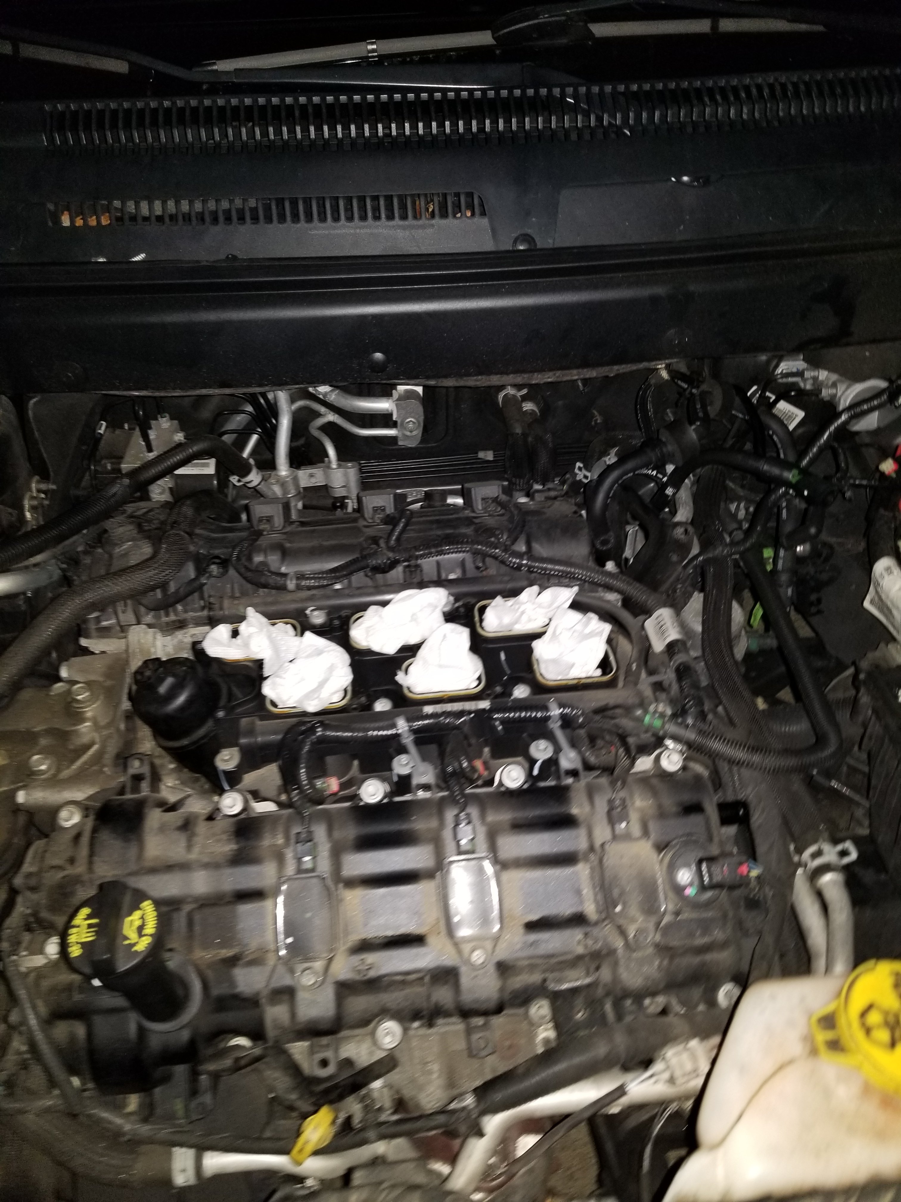

DJRI Posted March 13, 2019 Report Share Posted March 13, 2019 Under the intake manifold is 6 ports with a gasket on each. Those I didnt bother replacing. I put paper towel in each port to stop debris from falling in. Quote Link to comment Share on other sites More sharing options...

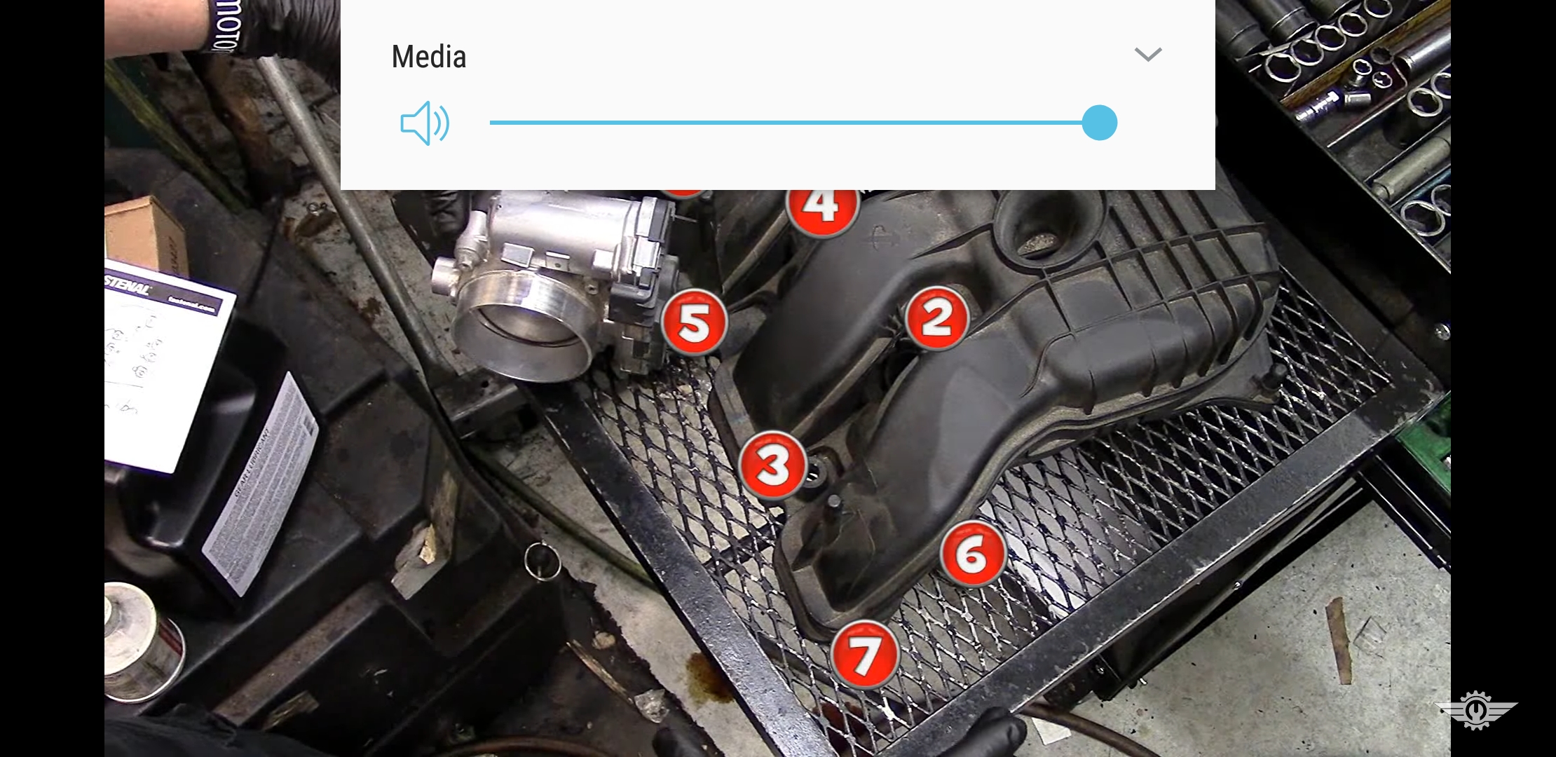

DJRI Posted March 13, 2019 Report Share Posted March 13, 2019 Tighten the manifold bolts down in this order. 1 is coverd under the volume bar. jkeaton 1 Quote Link to comment Share on other sites More sharing options...
