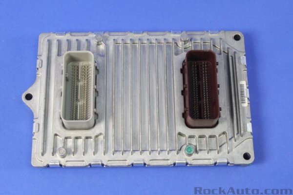

Wiartonwilly Posted July 24, 2022 Report Share Posted July 24, 2022 I have seen the coolant temp sensor cause this problem. Antifreeze will seep thru the sensor and will actually follow the wires and get into the computer. check for coolant in the coolant temp sensor plug. Quote Link to comment Share on other sites More sharing options...
John/Horace Posted July 25, 2022 Report Share Posted July 25, 2022 Into the computer meaning the pcm. But it’s the crazy temp probe sensors causing limp mode isn’t it ? PCM doesn’t short out, It’s pretty much sealed, main circuit board is encased in clear urethane I believe. Must create a big mess under hood though. Quote Link to comment Share on other sites More sharing options...
