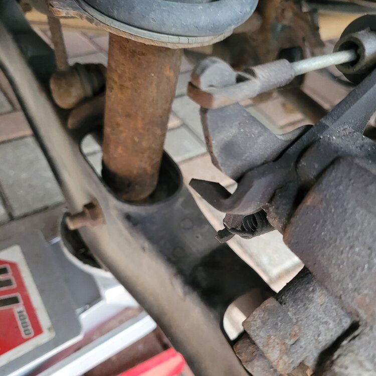

John/Horace Posted January 5 Report Share Posted January 5 Yup, rear calipers can be an issue. They start to not fully retract after parking brake used. Can tap back so no gap is there, spring doesn’t seem strong enough. Pic is with parking on, gap should completely disappear when released. Freeing up with cycling doesn’t really help. Cross direction bleeding works best on Journey, longest line first. Passenger rear then driver front etc. If no pressure bleeder, just a 2” piece of clear tube over end of bleeder screw helps. You see clearly when no more air bubbles coming out. Light taps on caliper can be helpful. Quote Link to comment Share on other sites More sharing options...
