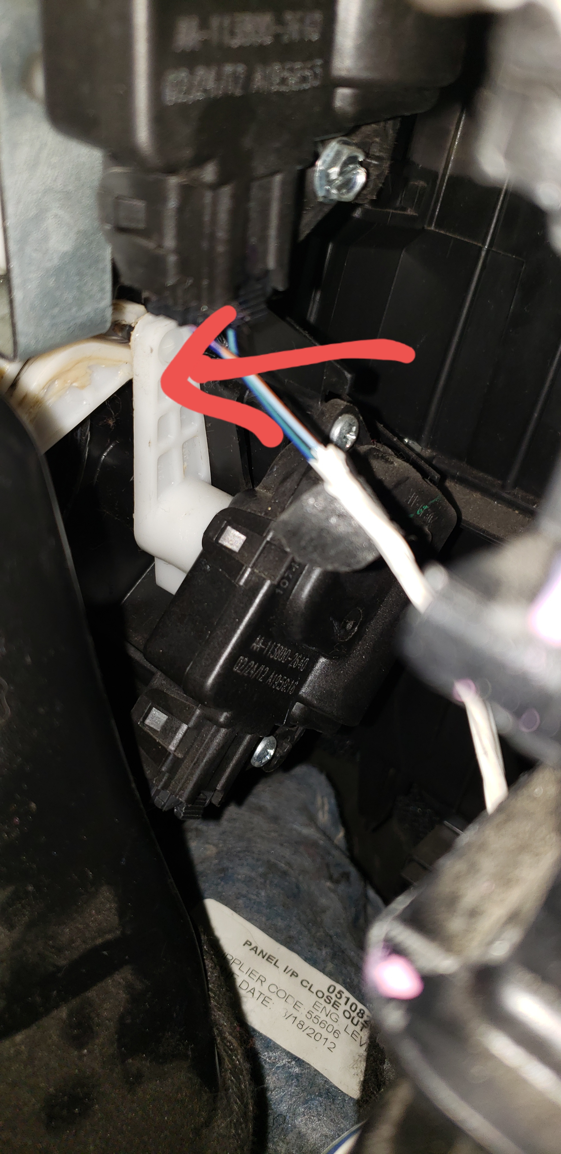

Bustamatic Posted April 26, 2019 Author Report Share Posted April 26, 2019 One last question for those more knowledgeable than I. I located what I believe is the culprit. The other actuators all move as I adjust settings...except this arm in the 3rd picture..which I am assuming is the blend door actuator. I seems stuck in that position..I tried moving it but no luck. Quote Link to comment Share on other sites More sharing options...
2late4u Posted April 26, 2019 Report Share Posted April 26, 2019 iv heard some say tapping on it frees it up and one said unplugging it and then plugging it back up made it start working good luck Quote Link to comment Share on other sites More sharing options...

lemdog Posted May 28, 2019 Report Share Posted May 28, 2019 i had this issue, you may have seen me post recently in other threads. i fixed it last night. i read about tapping it to "wake it up". it was the only one not moving and i had AC driver side, heat on passenger side. as soon as i started tapping it with butt-end of a long screw-driver, it woke up and started moving again. now everything works normal. not sure how long it will last but if it can last all summer, i will be happy enough. then find time later to replace it by winter. jkeaton 1 Quote Link to comment Share on other sites More sharing options...
