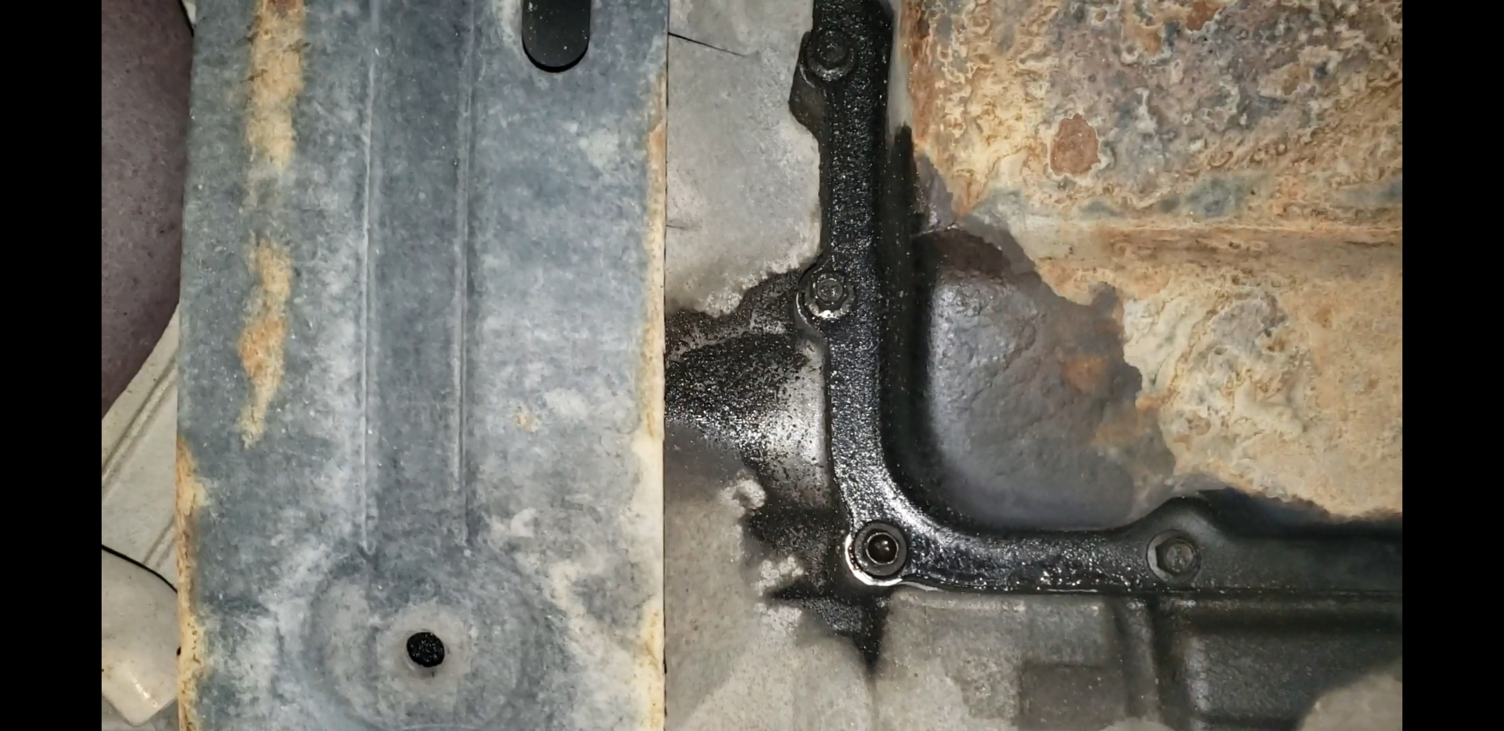

Bustamatic Posted May 7, 2019 Report Share Posted May 7, 2019 I discovered a leak on corner of transmission oil pan while performing my spring oil change. Looks like the gasket failed, possibly the pan damaged.? It seems to be coming from the corner. No symptoms when driving, and I checked the fluid condition and it could use a change but isnt terrible. My idea is to perform a transmission fluid/filter change, and have a new tranny oil pan on standby in case the pan is the issue(I can always return it if not needed.) I am just looking for any advice and a 2nd opinion on my plan. Thank you. Quote Link to comment Share on other sites More sharing options...

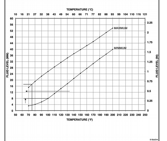

Bustamatic Posted May 7, 2019 Author Report Share Posted May 7, 2019 I believe the gasket will be a bead of RTV silicone around the pan edge and bolt holes... that's the way the service guy at the local Dodge dealer explained when he broke down the cost of having them do it, which is around $230 CAD. I've ordered a special dipstick as well(photo included), and will be using it with this graph and the transmission temperature display on my dash to find the right level, and spend just over $100 CAD doing it myself. Quote Link to comment Share on other sites More sharing options...

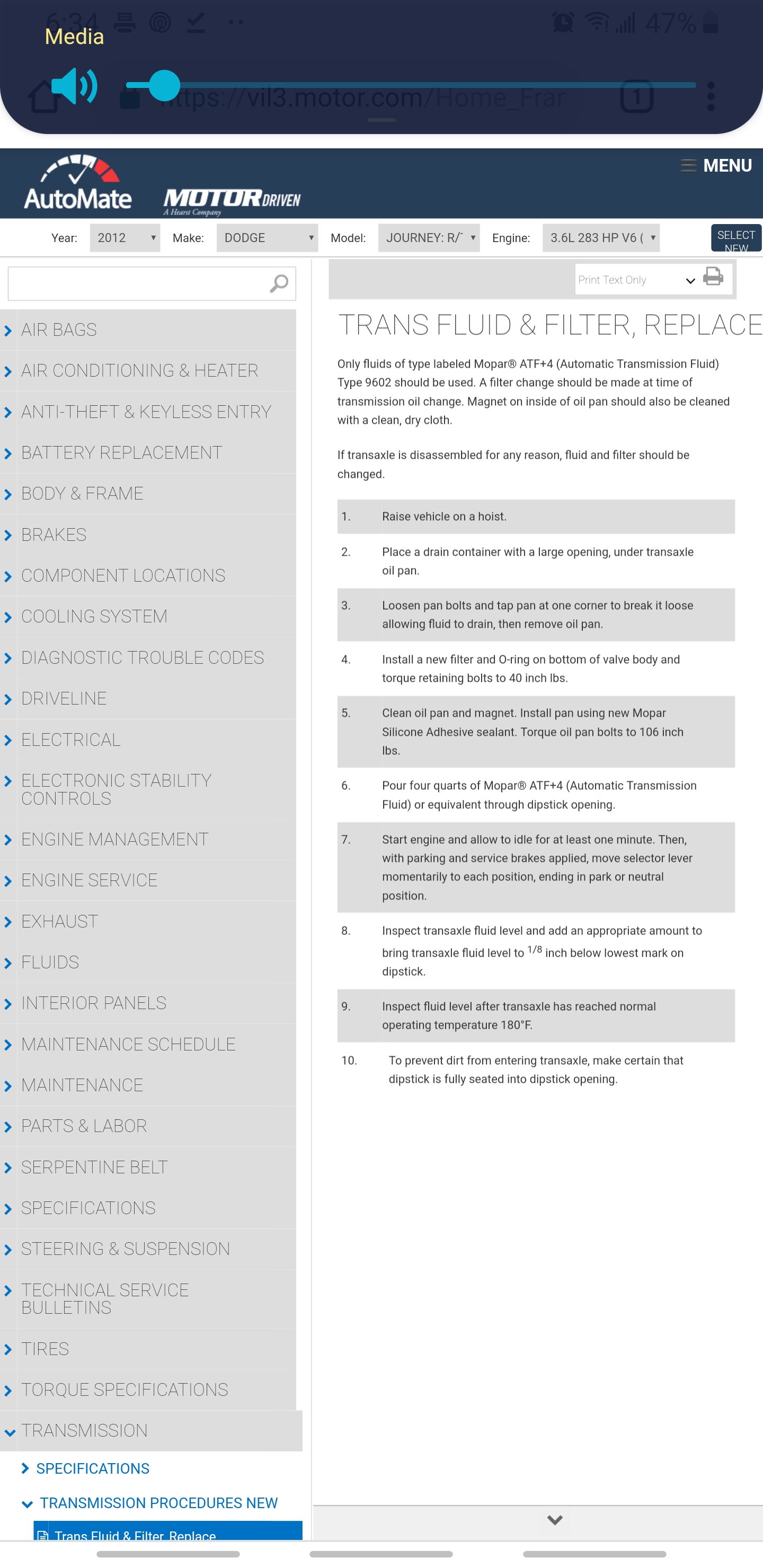

Bustamatic Posted May 11, 2019 Author Report Share Posted May 11, 2019 hey nino. heres a screenshot of the fill instructions for the 62TE transmission. I had to replace just over 5 quarts... I followed these instructions and after the initial 4 quarts(used a siphon pump), the dipstick read 10mm. I then added small amounts of fluid (with a syringe) around ten times from start up to around 70C to get it to the right level. I shifted through the gears before each read of the dipstick. Hope this helps. nino and jkeaton 2 Quote Link to comment Share on other sites More sharing options...
