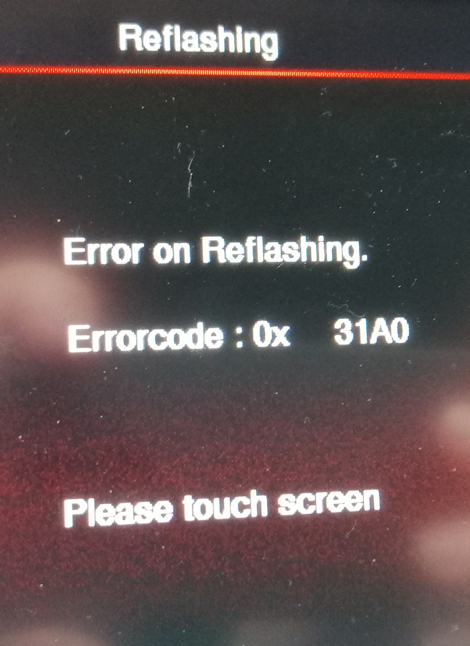

Foden Posted June 12, 2019 Report Share Posted June 12, 2019 Hi, have a 2013 R/U Uconnect 8.4 with Navigation. Downgraded to CPT13, which seemed to go OK. It showed the hour-glass and then the progress bar all the way to completion. . However, once completed i got the Error Reflashing Errorcode : 0x 31A0. When I start the Nav app it just sits at the loading please wait.... screen. I've tried to upgrade, reflash same version but all attempts fail with the same error. The progress bar does not move at all. I've tried using the original USB i used to downgrade and 7 other different brands/sizes (all formatted to Fat32) - but still same issue. Even tried an SDCard and DVD but they weren't recognized. I may be wrong but believe 31A0 means it doesn't like the USB stick Going into Dealer mode and checking the Navigation info all fields are all blank. Any ideas how I recover this Quote Link to comment Share on other sites More sharing options...
Foden Posted June 13, 2019 Author Report Share Posted June 13, 2019 (edited) Error Edited June 13, 2019 by Foden Re-sized image Quote Link to comment Share on other sites More sharing options...

Foden Posted June 14, 2019 Author Report Share Posted June 14, 2019 (edited) I've trawled through this and the Charger forum, nothing so far other than try a different USB This is all it does before it errors out Edited June 14, 2019 by Foden Quote Link to comment Share on other sites More sharing options...

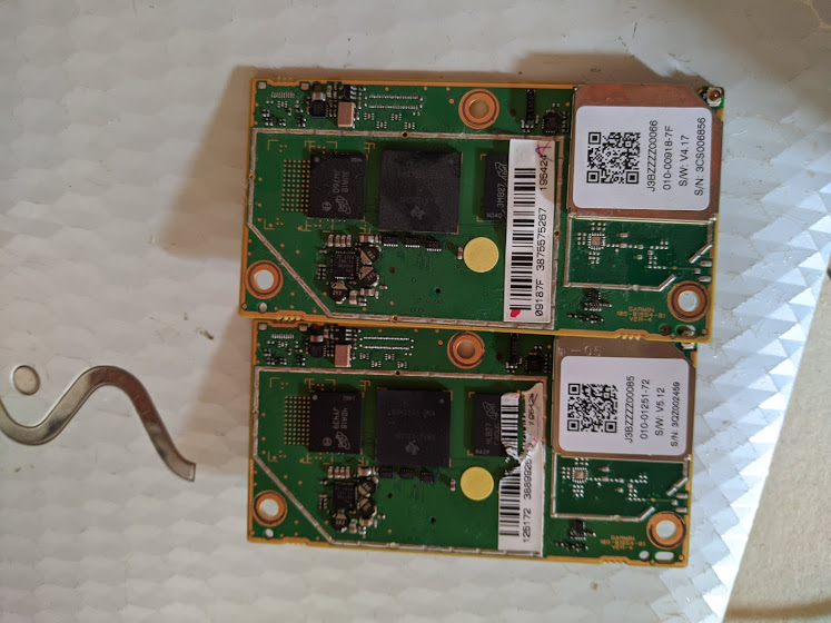

agm2112 Posted October 6, 2020 Report Share Posted October 6, 2020 I had exactly the same problem. A friend gave me a dead uconnect radio. I switched nav boards with my unit and .... voila. Working again. Is a newer version. Quote Link to comment Share on other sites More sharing options...
Foden Posted October 6, 2020 Author Report Share Posted October 6, 2020 Nice, wish I had friends like that !! I was able to eventually get the Nav upgraded myself - details are in the forum. Mainly helped by pulling the radio fuse and starting again, then finding a USB the unit liked Quote Link to comment Share on other sites More sharing options...

Foden Posted July 17, 2021 Author Report Share Posted July 17, 2021 Hmmm So you go into Dealership Menu, select Garmin Recovery and then insert your USB. It detects it but the progress bar doesn't move and it subsequently gives an error on flashing. Basically like the photo's I posted in this thread? 31OA, in my situation, meant 1 of 2 things. It either didn't like the USB stick, god only knows why, or there were files/folders on the stick that shouldn't be there. These files/folders sometimes got created when trying to get into Dealership mode and I pressed the screenshot combination rather than dealership menu. What happens if you put in your last map upgrade USB, does it recognize it and show any options? Do you have CTP17 to try an upgrade? Quote Link to comment Share on other sites More sharing options...

kenmag Posted July 17, 2021 Report Share Posted July 17, 2021 Thanks for the help i really think i need the new garmin board. I was really hoping someone might know a solution for factory reset. tried the fuse, removing battery etc and the radio does reset but not to factory, all presets Sirius and settings stay. I remove battery cables and clamped them together for 3 hours i have tried several usb and i did try the gmapprom alone. Right now i am using a portable garmin. everything else in the radio works great. Quote Link to comment Share on other sites More sharing options...
