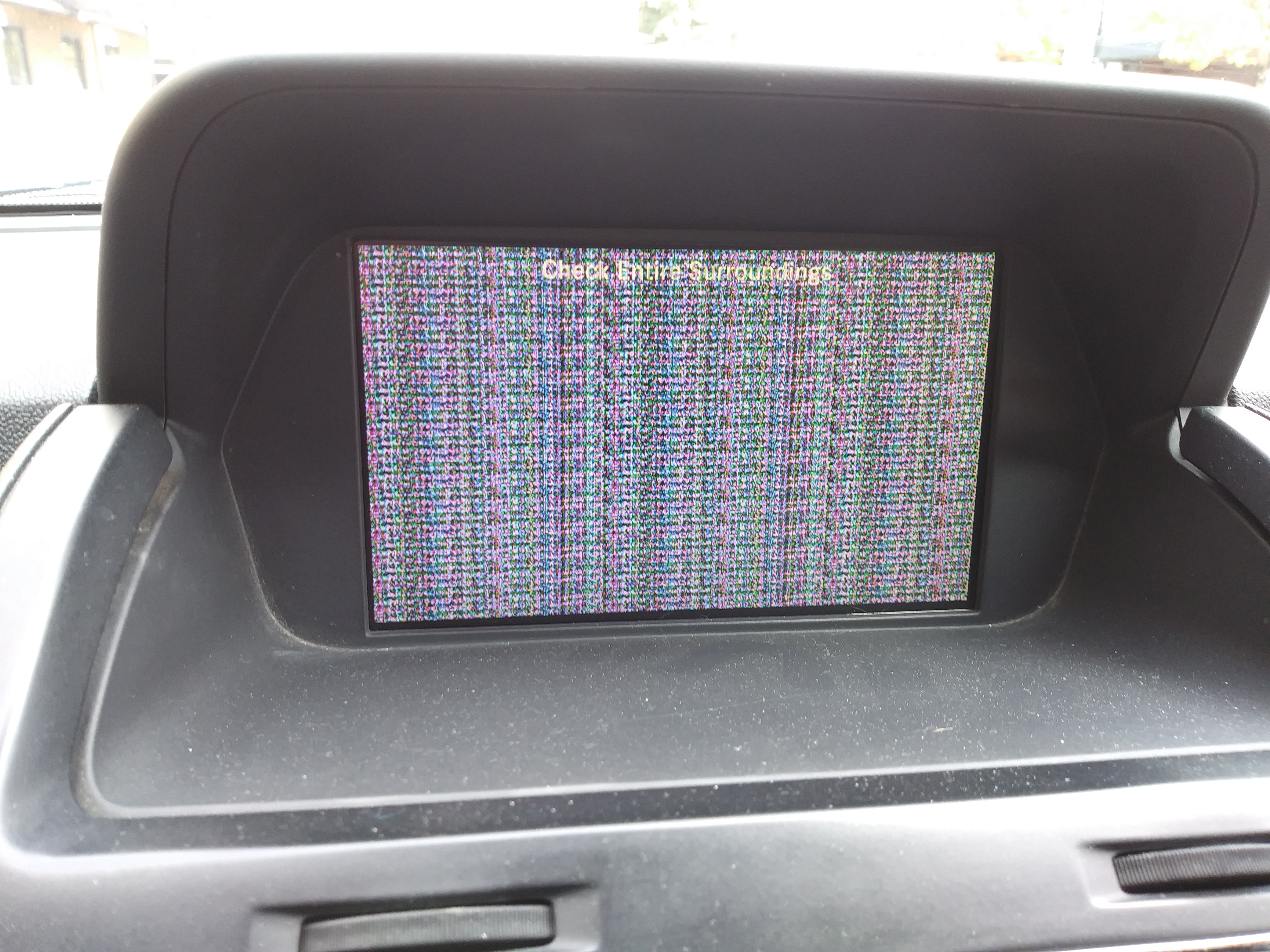

William Burke Posted October 25, 2019 Report Share Posted October 25, 2019 Don't mean to high jack this thread, but I get this intermittently then it goes away. 2010 Journey R/T. Quote Link to comment Share on other sites More sharing options...
2late4u Posted October 25, 2019 Report Share Posted October 25, 2019 (edited) mine is still working 8 times out of 10 times. but when it messes up the screen goes black and the words check entire surroundings is gone as well, i seen ton the charger you tube they been experiencing what i have it has been fixed by replacing the actual camera lens, but also they dont mention if it is intermittent or always going black, since yours is showing what looks like interference static i would assume you have a bare wire shorting out i would check the rubber boot cover over the wires at the top left rear of your hatchback........................ i did check my wiring at the rubber boot and didnt find anything or any broken wires and since my rear camera was added at the dealership the 2 wires plus the big white cable wasn't buried in the wire loom or taped up into the other wires....good luck Edited October 25, 2019 by 2late4u William Burke 1 Quote Link to comment Share on other sites More sharing options...
2late4u Posted October 25, 2019 Report Share Posted October 25, 2019 15 hours ago, William Burke said: Don't mean to high jack this thread, but I get this intermittently then it goes away. 2010 Journey R/T. by go away, do you mean it starts working or go black???? Quote Link to comment Share on other sites More sharing options...
William Burke Posted October 26, 2019 Report Share Posted October 26, 2019 starts working normal Quote Link to comment Share on other sites More sharing options...
William Burke Posted October 26, 2019 Report Share Posted October 26, 2019 11 hours ago, 2late4u said: by go away, do you mean it starts working or go black???? starts working normal again. Quote Link to comment Share on other sites More sharing options...
