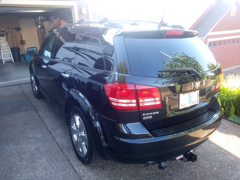

William Burke Posted July 28, 2019 Report Share Posted July 28, 2019 We recently bought a 2010 Dodge Journey R/T. Very nice car, but when we bought it the horn didn't work. After taking back to the dealer who worked in tandem with the Dodge dealer they fixed the horn. It took 6 weeks for them to try everything under the sun. According to the dealer there were 2 wires missing from the wiring harness that made the horn work. The reason unknown. The car came from Canada. Now we have new issues: after turning the car off, 3 instrument panel lights stay on for 15 minutes. Odometer, clock and exterior thermometer. Then they shut off. As for the dome lights, when opening the door the dome lights should go on, but only the front passenger side door and drivers side rear door work. Other 2 doors no go! Anyone know what is going on here?? We are very frustrated!! Any ideas welcome! Quote Link to comment Share on other sites More sharing options...
