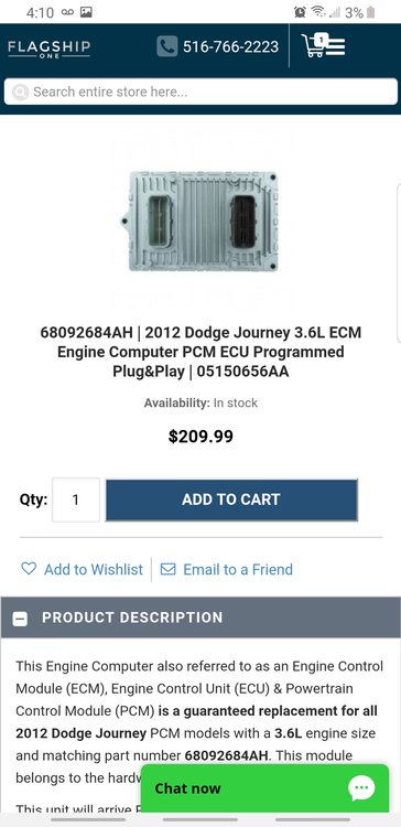

SOUS614 Posted December 20, 2019 Report Share Posted December 20, 2019 (edited) Could be the computer acting up just like mine. I'm getting mine changed out so hopefully it will be the end of the bad. The computer malfunctions and can throw so many codes, I'm having a machanic shop fix my problems. But they told me Flagship is where they will get a new computer and already programmed. Good luck I hope your problems get fixed. Edited December 20, 2019 by SOUS614 Quote Link to comment Share on other sites More sharing options...
