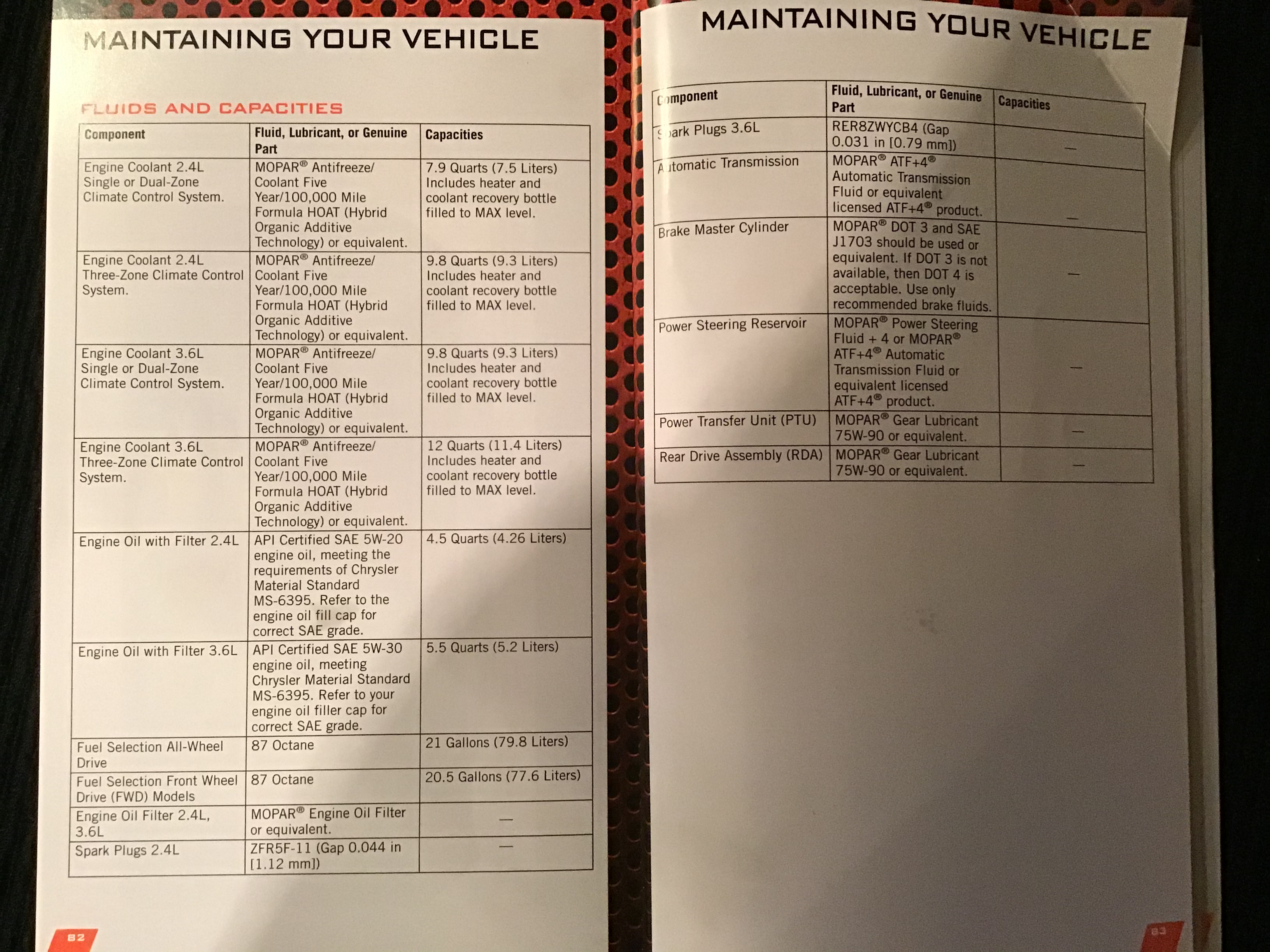

djw11 Posted February 3, 2020 Report Share Posted February 3, 2020 Hi have a 11 DJ RT 3.6l - changing my own oil/filter and trying determine how much new oil to add, my manual states 6qt or 5.2ltres, But I added amount of 5.5 litres and that gets me just to lower hashmarks on dipstick, I read eslewhere that engine takes 5.6litres? where am to fill oil to, top of hashmarks which would require additional 1ltre then it would be over a total of 6.5litres - well above service manual quantity. (After changing I did run engine for 5 minutes before checking oil level) Thanks Quote Link to comment Share on other sites More sharing options...
djw11 Posted February 3, 2020 Author Report Share Posted February 3, 2020 Update: after car sat for 20 minutes I recheck the oil level and it was at the mid point of hashmarks, so I added a bit more to get to the 5.6ltr amount, which should put level at about 3/4 in safe zone, it appears my manual is wrong at 5.2ltre quantity Summer Solstice 1 Quote Link to comment Share on other sites More sharing options...
NavalLacrosse Posted February 3, 2020 Report Share Posted February 3, 2020 (edited) Pre edit: before I posted the following, I quickly searched 5.6 liters to US qts. and, 5.6L = 5.91 qts. There is no problem with your engine, just seems there was an issue of conversion between metric and freedom units. I'm thinking FCA made a typo- It's really in the manual like that? No way! Leave it to us Americans to not know how to convert into metric in a technical document distributed in global markets! --------------------------- Hi, I've got the 2011 with the 3.6 v6 also. I've noticed the same issue you've mentioned, and never really think about it much after closing the hood. When I use 6qts, It sometimes feels a bit low on the dip-stick. I've got tired of buying extra quarts of oil only to use it half way, so ultimately my band-aid solution was: Leave a tiny bit more residual oil in the pan when I close. By changing the oil it faster, and closing the drain plug with a marginal amount of residual oil in the engine keeps the oil level in the 50% acceptable range when refilling with only 6qts. (5.6L) Edited February 3, 2020 by NavalLacrosse Quote Link to comment Share on other sites More sharing options...
djw11 Posted February 3, 2020 Author Report Share Posted February 3, 2020 Thanks for the response, here is the manual details , for your eyes only! Lol i am going with the 5.6litre fill which puts the oil in the middle of the safe zone on dipstick But in reality if a person was to go by the manual, the engine would be under filled and possibly resulting in damage? Quote Link to comment Share on other sites More sharing options...
larryl Posted February 3, 2020 Report Share Posted February 3, 2020 It takes 6 US quarts...works perfect 2late4u 1 Quote Link to comment Share on other sites More sharing options...
djw11 Posted February 4, 2020 Author Report Share Posted February 4, 2020 Thanks conversion of 6us quarts = 5.7litres , so that’s what I going with, just odd that the manual is wrong, maybe it was corrected in the new versions NavalLacrosse 1 Quote Link to comment Share on other sites More sharing options...
larryl Posted February 4, 2020 Report Share Posted February 4, 2020 you can add six litres without issue also Quote Link to comment Share on other sites More sharing options...
