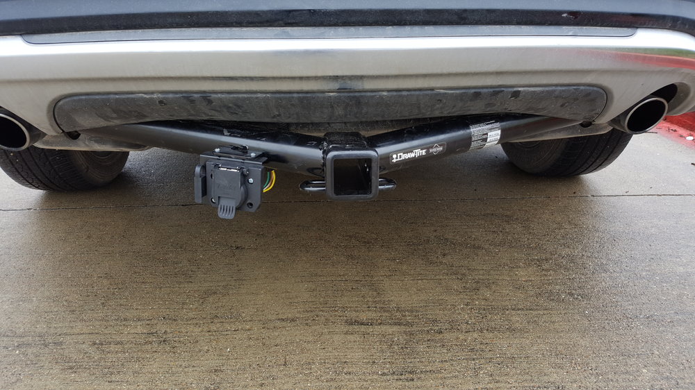

TexMarc Posted February 12, 2020 Report Share Posted February 12, 2020 I apologize in advance for the length of this post...but I feel that there is LOTS of information that you need to know to be able to render an opinion. I thank you in advance for your patience. OK, so.... This morning I had a trailer hitch attached to my 2015 Dodge Journey Crossroad, with the 6 cyl engine. It was from etrailers dot com. Plenty of power in the Journey to pull the trailer I purchased. They get it all hooked up and I drive home to get my trailer. Once I get everything to hook up, I find that I can only get my flashers to work on the trailer. No tail-lights, no blinkers, no break lights...only the flashers would work. I call up the people where I purchased the trailer, they tell me that everything should be working. It is a used trailer (2012) but they've literally gone through and replaced everything except the frame. No reason it shouldn't be working. So I take it to the shop where they installed the trailer hitch. The guy scratches his head when he sees that only the flashers are working. So he gets his tester out and plugs it into the 7 pin/blade receiver that they installed. I run through the gamut of signals and lights...and his tester shows that everything is working! So it must be something the Trailer sales place messed up. Right? I go to the Trailer sales place and they say, no...it can't be. We literally changed everything. They get out their tester...same results as the hitch shop. Everything works with the tester, but not with the trailer. So the owner gets under there and starts checking things and for an hour he can't find anything wrong. He replaces wiring, connectors, the ground...everything you can imagine...but it won't work...except for the flashers! So I leave the trailer with him and before I even get home (15 min ride to my place) he calls me and says that he hooked up the trailer to HIS truck (newer and very nice) and everything works great! He just now called again and said they hooked it up to one of his employee's vehicles which is an older Tahoe and everything is working great! All of the fuses are good, there are 3 different ground points on the trailer now, so that's not it. None of this makes any sense at all! Is it possible that the 2015 Dodge Journeys might have some kind of an amp draw blockage? Some kind of switch that might have gotten flipped before I purchased the vehicle last year? Maybe a reset button somewhere? I am at my wit's end...and I need to have this trailer ready to go in a short amount of time because we are using it to move some of our stuff to TN from TX. I thank you for taking the time to read this...and hopefully, someone has an answer. Quote Link to comment Share on other sites More sharing options...

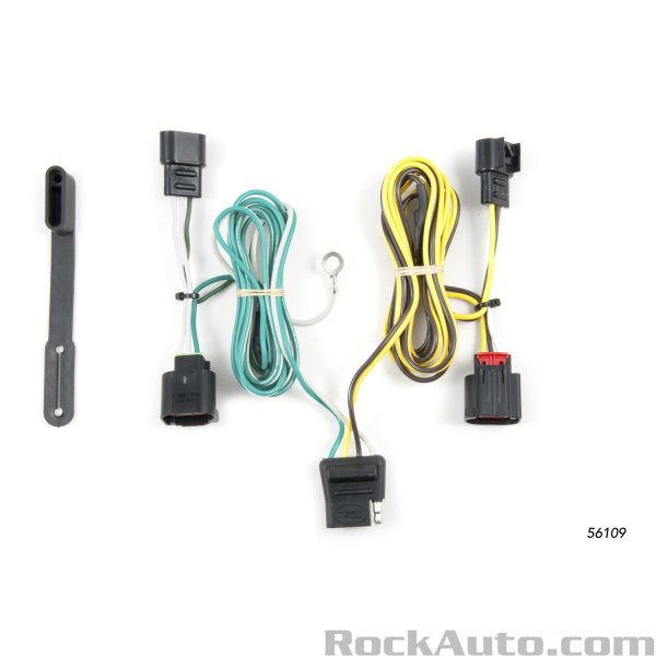

2late4u Posted February 13, 2020 Report Share Posted February 13, 2020 CURT 56330 Vehicle-Side Custom 4-Pin Trailer Wiring Harness for Select Dodge Journey..................... Quote Link to comment Share on other sites More sharing options...
TexMarc Posted February 13, 2020 Author Report Share Posted February 13, 2020 On 2/13/2020 at 12:08 AM, OhareFred said: Did you have the Dodge computer flashed for towing? That’s the only thing I can think of. Even though the tester works, the fact that everything on the trailer works properly with other cars leads me to think the bulb draw is too much and the Dodge is reading the increased draw as an issue. I know if you want to use the factory trailer wiring the car needs to be flashed, might be the same here....let us know what you find out. Expand OhareFred: Thank you for your comment. With regard to the "bulb draw" ... everything is LED lights, so that shouldn't even be an issue...right? It seems to me like this has to be a grounding issue. And because of that, I am beginning to wonder if it has to do with my trailer ball. When I initially picked up the trailer, I had my Dodge Dakota...and I had that same exact problem. Flashers were fine, nothing else would light up. I sold that truck the day after I brought the trailer home and then used my Journey....and I was using the same trailer ball...which, while not a new ball, it still has most of its chrome on it. I have another one that I'll try out tomorrow that is substantially older and might give it a better connection for a ground. Thank you again for your comments, and I will definitely keep the flashing part in mind. 2late4u 1 Quote Link to comment Share on other sites More sharing options...
John/Horace Posted February 13, 2020 Report Share Posted February 13, 2020 (edited) Ground shouldn’t be an issue, one of the wires in the 7 pin connector will be ground. I believe led need a special wire harness for trailer lights to tie in car. It’s a small black box inline in the harness like what is showing in the link below. Regular vehicles just tie right in without it. Look at your new wiring to see if there is a converter box in line. You can add a diode by itself as well if you known what you are doing, but led converter module easier. New Ford F150s requires flashing ecm for trailer wiring, but that is mainly for the trailer brake controller that is built Into dash. One pic shows led harness the other is the regular lights harness. These are diy pig tail hook ups, no cutting wires or splicing or heat shrink connections. Is there a Uhaul trailer place near by? They are usually pretty good for trailer hook ups, around a long time. Good luck on your big move. Edited February 13, 2020 by John/Horace Quote Link to comment Share on other sites More sharing options...
John/Horace Posted February 13, 2020 Report Share Posted February 13, 2020 (edited) I said diode, I meant adding a resistor. You can also install an LED bulb load resistor on the tow vehicle. One resistor is required for each LED turn signal. ... Since the incandescent lights have a higher draw, it is possible for the LED lights to burn out if they wired in line with incandescent lights. Replacing Incandescent with LED lights on your Trailer - CMI Edited February 13, 2020 by John/Horace Quote Link to comment Share on other sites More sharing options...

OhareFred Posted February 28, 2020 Report Share Posted February 28, 2020 If they used a converter I doubt they used the factory trailer wire harness. Likely tapped in to left and right side taillights. Wouldn’t need a flash then.... Quote Link to comment Share on other sites More sharing options...
Dodge hualing Posted July 7, 2021 Report Share Posted July 7, 2021 I know I’m late to this conversation but some really good comments here and I also just got a hitch installed on my 2019 Dodge Journey crossroad witch has led tail light and for the regulator 4 prong wiring harness i had to get one that brings in additional power because the leds don’t bring in the 12 volts or the amarage because they are all running off modules now so they can running lower amounts of power further more brings me to my questions because dealer ships can’t seem to answer my question so I’m forced the bring it here due to they want $500 to set up a brake controller. Now bring back my statement about using modules to just send enough voltage for signals I’m having a hard time trying to wire my brake controller in due to not enough voltage at the switch by the brake pedal. Also further more in to testing and finding out that the switch down by the pedal n longer runs the brake lights where do I find I need to wire this in to because my next step is to just run a wire from where the brake light wire is in the back of my car and run it to a relay then to my brake controller so it works. And on the note that anyone says using a relay to control a brake controller doesn’t think it will work i;ve tested it and it does work. Also I’m a big rid tech so automotive is slightly out of my domain Quote Link to comment Share on other sites More sharing options...
TexMarc Posted July 7, 2021 Author Report Share Posted July 7, 2021 My issue was finally solved by having a 7 pin (with a side 4 pin on the side as well) that was all one piece. Once they were able to run part of the wiring up to the rear LEDs, all of the lights worked, and everything else was perfect. I decided to use an ECHO Smart Brake Controller which gave me the ability to adjust the brake pressure to whatever size load I'm hauling. Best of luck to you. Quote Link to comment Share on other sites More sharing options...
