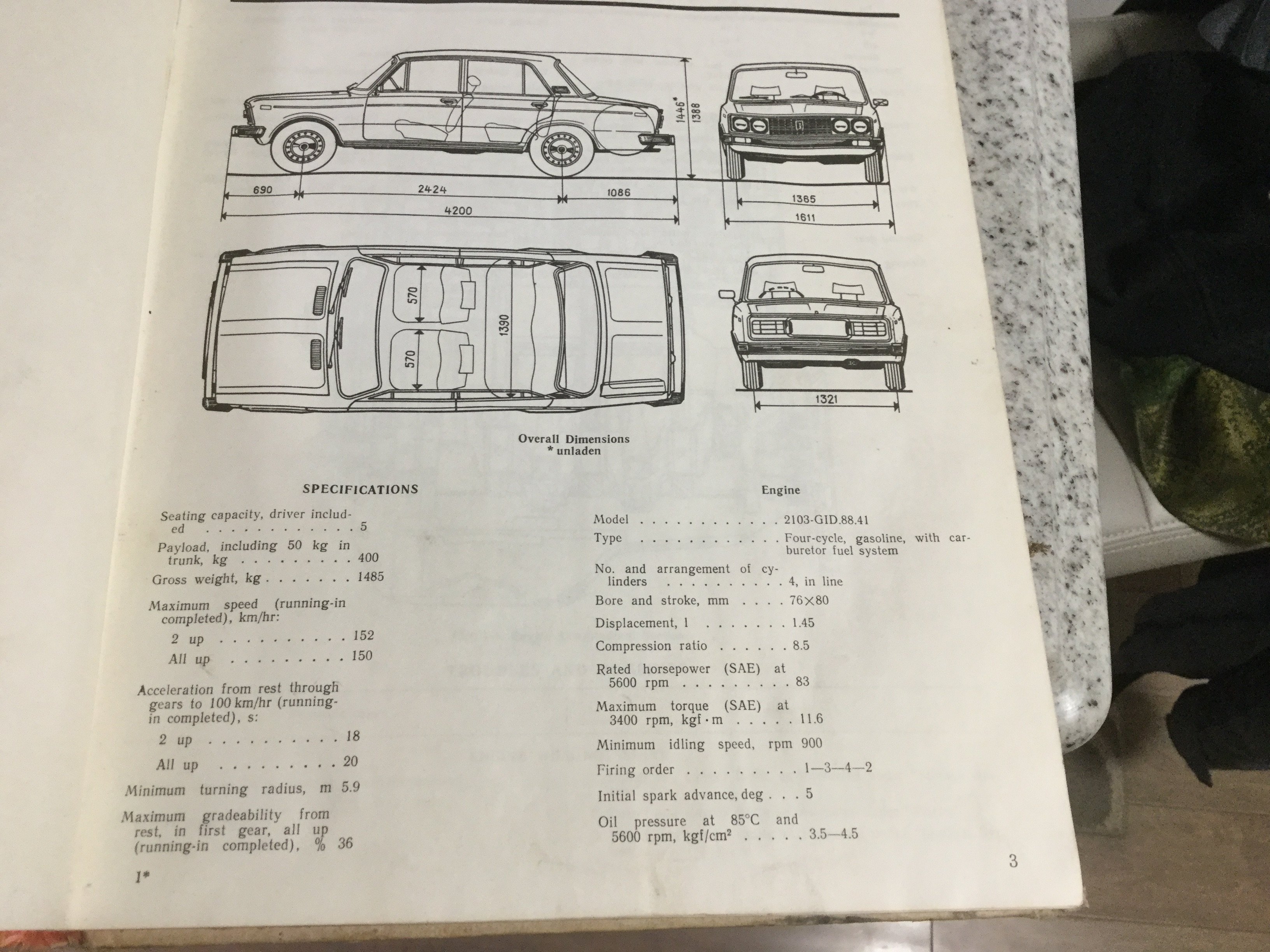

John/Horace Posted March 21, 2020 Report Share Posted March 21, 2020 A whip lash inducing 83 HP. Quote Link to comment Share on other sites More sharing options...
Summer Solstice Posted March 21, 2020 Report Share Posted March 21, 2020 On 3/21/2020 at 12:08 AM, John/Horace said: A whip lash inducing 83 HP. Expand That thing just looks fast! Quote Link to comment Share on other sites More sharing options...
John/Horace Posted March 21, 2020 Report Share Posted March 21, 2020 Very simple but crude vehicle. Very slow because of heavy weight under powered engine, fuel economy not horrible. Exhaust pipes and other metal very thick so you could fix stuff your self. No catalytic converter I think was why back pressure mattered. Just a catalytic by itself could be the minimal back pressure a 4 stroke normally aspirated engine needs. Entire electrical system wired with four colors of wire. Trying to trace an issue not exactly easy to do. Tool kit from car hilarious but functional. I still have two metric wrenches from the kit. Excellent strength steel, but machining and forging very ruff. One wrench has the size stamping mixed up. Small 10 mm end says 13 and vice versa. Bad vodka day maybe. Quote Link to comment Share on other sites More sharing options...
