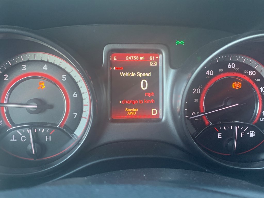

mrsdejesus Posted March 27, 2020 Report Share Posted March 27, 2020 I have a 2019 Dodge Journey I recently got new tires (2 weeks ago) now today the service AWD system traction control and ABS lights are on anyone know why Quote Link to comment Share on other sites More sharing options...
OhareFred Posted March 28, 2020 Report Share Posted March 28, 2020 (edited) Somethings wrong. OK, sorry but couldn’t resist being a smart ass.. anyway, why did you need tires already? Did you replace all 4? How many miles do you have? Have you had the codes read? What did reading the codes show? need more info to help..... Edited March 28, 2020 by OhareFred Quote Link to comment Share on other sites More sharing options...
2late4u Posted March 28, 2020 Report Share Posted March 28, 2020 (edited) check your cruise control as well, as it is not working either if so then you have a wheel speed sensor gone bad , and also your local auto stores will not be able to check the codes to tell you which one is bad, probally one that you had the tires changed they might have damaged the sensor, you can google wheel speed sensor for more info on how to fix one or replace it not real expensive the dealership replaced my front one and labor and part was around $55..your local garage might be able to find out which one and fix it good luck just relised you should still have warranty just take it in Edited March 28, 2020 by 2late4u OhareFred 1 Quote Link to comment Share on other sites More sharing options...
mrsdejesus Posted March 28, 2020 Author Report Share Posted March 28, 2020 (edited) I live on a dirt road Jack Williams (where I got the tires) said the rear alignment was off due to the pot holes and dirt road. As for replacing all 4 tires yes I did and even had the alignment done 2 weeks ago. When the lights came on I drove straight home and parked it so I didn’t check the cruise control. Calling the dealership where I purchased the vehicle tomorrow (hoping they are open). The car is still under warranty so hopefully they will fix it. Edited March 28, 2020 by mrsdejesus Quote Link to comment Share on other sites More sharing options...
