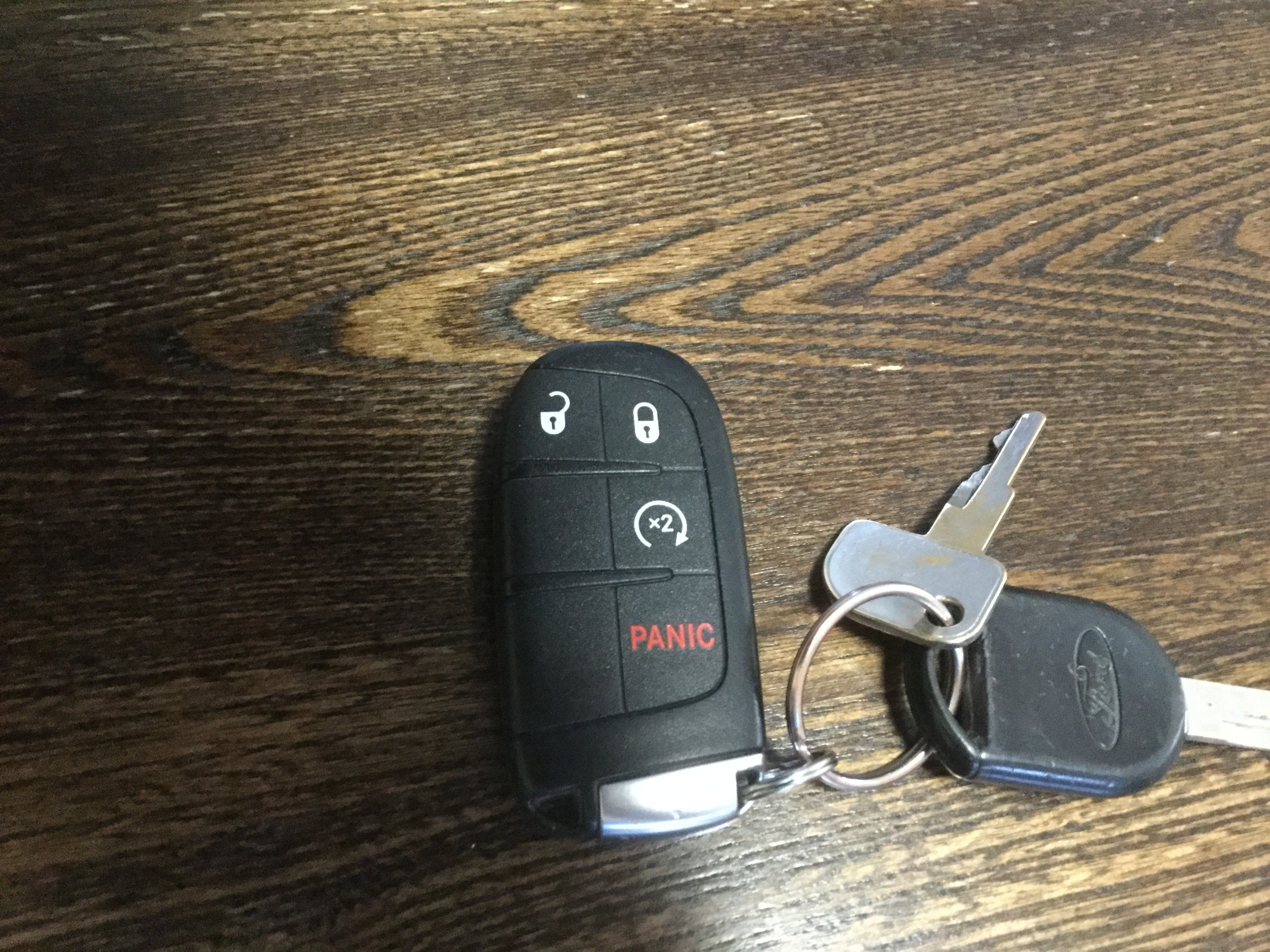

Higmanph Posted March 30, 2020 Report Share Posted March 30, 2020 I was cleaning interior and listening to usb on accessory when I open my door and alarm goes off I dont know I was able to turn off alarm but eventully stopeed but I started car a few times and tried all the buttons on the fob. My question is How did I activate alarm while inside the car? Quote Link to comment Share on other sites More sharing options...
John/Horace Posted March 30, 2020 Report Share Posted March 30, 2020 (edited) Remotes often have a panic button on them. I triggered mine by accident the other day. Was remote in pocket ? Is there a separate button? Manually moving lock mechanism from inside car when system is armed will trigger alarm if no separate button. panic button on remote. If alarm system is armed and door handle or latch activated from inside; car system assumes window was broken and someone without key is manually triggering lock mechanism. Alarm goes off. Edited March 30, 2020 by John/Horace Quote Link to comment Share on other sites More sharing options...
larryl Posted March 30, 2020 Report Share Posted March 30, 2020 you might have "locked" the vehicle with fob then tried to open a door Quote Link to comment Share on other sites More sharing options...
Higmanph Posted March 30, 2020 Author Report Share Posted March 30, 2020 thank you folks that seems to be what has happened I was cleaning and probably hit the lock then opened the door Thank you again Quote Link to comment Share on other sites More sharing options...
