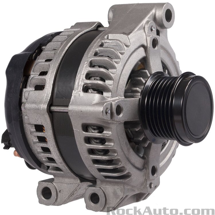

dodgedude420 Posted December 13, 2023 Report Share Posted December 13, 2023 I posted previously about a whining noise that I could not get fixed. It ended up being the alternator decoupler or clutch. I don't know why in the workd anybody would want to install an extra part on an alternator but I swapped it out the wine is gone. A good tip on a 2013 journey se. It's so much easier if you just remove the alternator then the pulley no special tool needed hex bit and air impact. All I ended up using. I just wanted to share, thanks guys. 5rebel9 and larryl 2 Quote Link to comment Share on other sites More sharing options...
5rebel9 Posted December 13, 2023 Report Share Posted December 13, 2023 The 2.4 motor is the only one that employs a decoupler pulley on the alternator, and often the cause of noise around 80-100k mile vehicles. Some left unattended to will fail completely and allow no charging ability of the alternator. Glad it worked out for you! John/Horace 1 Quote Link to comment Share on other sites More sharing options...
John/Horace Posted December 14, 2023 Report Share Posted December 14, 2023 Mmm looks like the 3.6 also has decoupler clutch, all the units for sale list the feature. I used a dealer rebuild on our 3.6 so installed a complete unit a few years ago. It stopped charging but no whining noise. Coupler is used to save energy apparently. Cost is around $130 ish for just coupler, so whole unit is probably better option. Made in Canada…probably why it failed.? 5rebel9 1 Quote Link to comment Share on other sites More sharing options...
