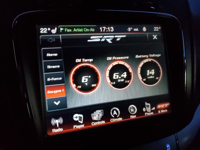

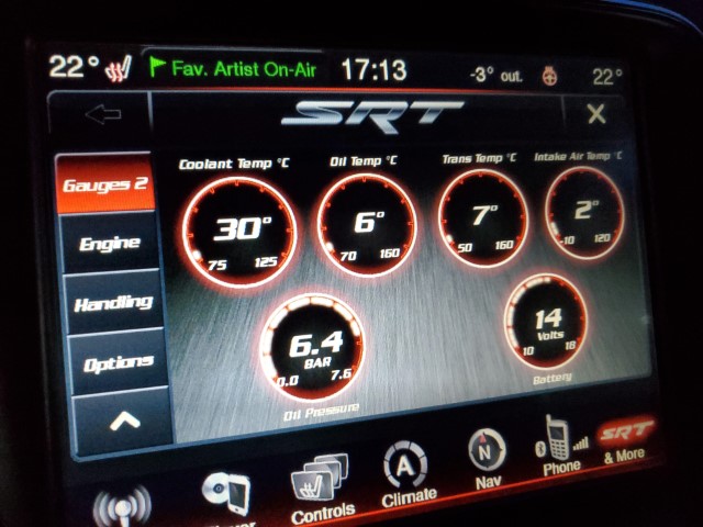

Miguel Pereira Posted January 27, 2021 Report Share Posted January 27, 2021 larryl 1 Quote Link to comment Share on other sites More sharing options...
John/Horace Posted January 27, 2021 Report Share Posted January 27, 2021 Interesting. So the gauge settings always look like that. I don’t have voltage on 2014, would be nice to have. Does the ELM 327 Bluetooth obd11 work with the free app. Wouldn’t mind enabling rear camera, but the head unit input on wife’s 8.4 screen is not rca jack for after market cams I think. Quote Link to comment Share on other sites More sharing options...
Miguel Pereira Posted January 27, 2021 Report Share Posted January 27, 2021 7 minutes ago, John/Horace said: Interesting. So the gauge settings always look like that. I don’t have voltage on 2014, would be nice to have. Does the ELM 327 Bluetooth obd11 work with the free app. Wouldn’t mind enabling rear camera, but the head unit input on wife’s 8.4 screen is not rca jack for after market cams I think. Hello: I have the Paid App and OBD Link MX... if you need help PM directly Regarding the Camera.. I would goggle that further. I think there's workaround for that. Quote Link to comment Share on other sites More sharing options...
