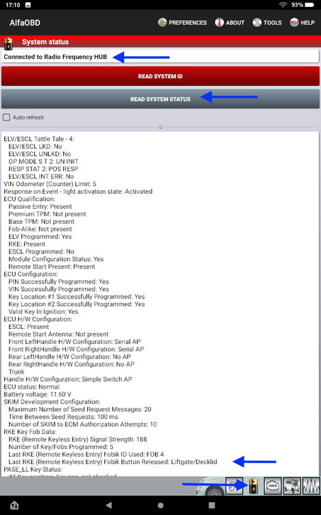

Grendi Posted April 25, 2021 Report Share Posted April 25, 2021 Update: after testing a few remote code ID's, the following functions on my 5 button remote are recognized by the RFH according to my Ancel X6 car scanner. : Unlock (ID 08), works Lock (ID 02), works Liftgate / Decklid (ID 04), does not work Remote Start (ID 40), works Lock + Panic (ID 03), does not work however, if I go to AlfaOBD -> Radio Frequency Hub(RFH) -> System Status -> Read System Status In the parameter: "Last RKE (Remote Key Entry) Fobik Button Released" only "Unlock", "Lock", "Liftgate / Decklid" AND "Remote Start" are shown. ?!? can someone with AlfaOBD and a working panic button confirm this? if someone could post a BODY_CHRYSLER_Info.log of his dodge journey with the "Liftgate" or the "Panic" button working, that would be great. preferred year would be 2012, but any 2011+ model would probably help. Miguel Pereira 1 Quote Link to comment Share on other sites More sharing options...
Miguel Pereira Posted April 29, 2021 Report Share Posted April 29, 2021 (edited) On 4/25/2021 at 12:31 PM, Grendi said: Update: after testing a few remote code ID's, the following functions on my 5 button remote are recognized by the RFH according to my Ancel X6 car scanner. : Unlock (ID 08), works Lock (ID 02), works Liftgate / Decklid (ID 04), does not work Remote Start (ID 40), works Lock + Panic (ID 03), does not work however, if I go to AlfaOBD -> Radio Frequency Hub(RFH) -> System Status -> Read System Status In the parameter: "Last RKE (Remote Key Entry) Fobik Button Released" only "Unlock", "Lock", "Liftgate / Decklid" AND "Remote Start" are shown. ?!? can someone with AlfaOBD and a working panic button confirm this? if someone could post a BODY_CHRYSLER_Info.log of his dodge journey with the "Liftgate" or the "Panic" button working, that would be great. preferred year would be 2012, but any 2011+ model would probably help. Hey there: I can send my reading of the HFM. Please see attached RFH_PN_Info.log.docx BODY_CHRYSLER_Info (1).log Edited April 29, 2021 by Miguel Pereira Grendi 1 Quote Link to comment Share on other sites More sharing options...
