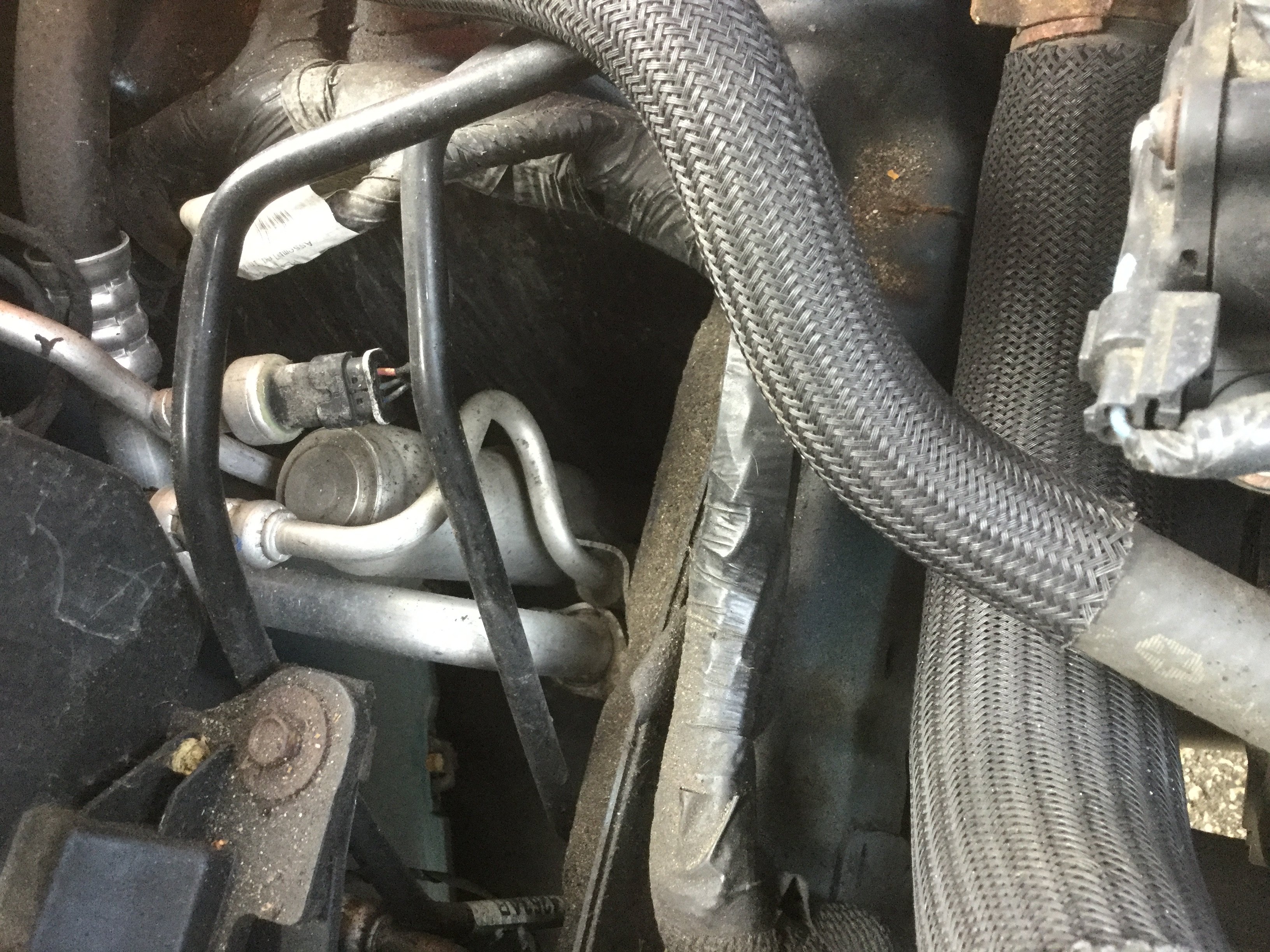

John/Horace Posted May 29, 2020 Report Share Posted May 29, 2020 (edited) This looks like low side switch, it’s on the same line as charging port. High pressure side on a/c can reach over 210psi-ish which is shrapnel making velocity potential. Wear your jock and your goggles.?? If some refrigerant charge still partly there and no air (moisture mainly) got into system might be ok. If compressor starts up, start looking on high side, especially condenser coil across rad for hissing large leak. Edited May 29, 2020 by John/Horace Quote Link to comment Share on other sites More sharing options...
Shawn855 Posted May 29, 2020 Author Report Share Posted May 29, 2020 (edited) Yeah i had found the plug itself and cleaned it off and reconnected it the other day, but how would i go about jumping it? Normally for other vehicles you can go to to the relay in the fuse box and jump it there, but my 2016 doesn't have a relay for that. Edited May 29, 2020 by Shawn855 Quote Link to comment Share on other sites More sharing options...
