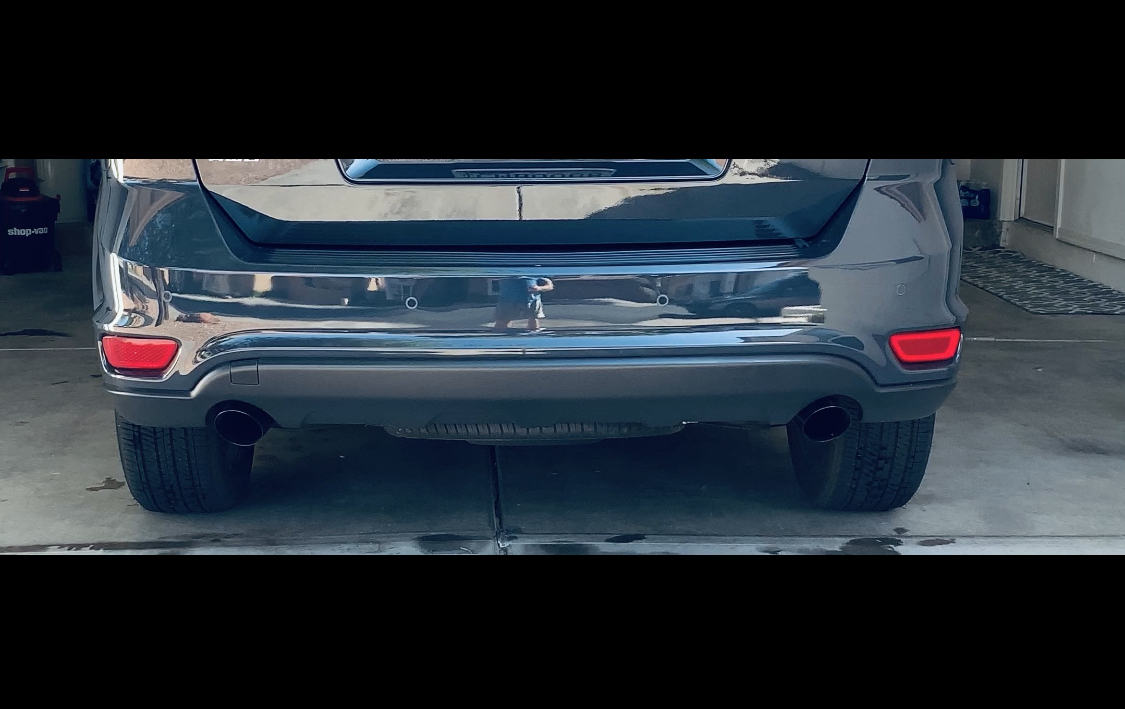

Greekbulldis Posted July 12, 2020 Report Share Posted July 12, 2020 Just had my 17GT done. Deleted mid resonator and replace with MagnaFlow 10415 Exhaust Muffler magnapack Straight pipe the rest. Got rid of those chrome tips and replaced them with single wall black powder coat 12” tips. 45° cut. sounds amazing especially when get on the freeway. Almost zero drone unless you are getting on her. Quote Link to comment Share on other sites More sharing options...
