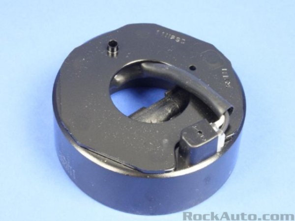

John/Horace Posted June 18, 2020 Report Share Posted June 18, 2020 (edited) But clutchless is newer tec and the Journey hasn’t been updated at all in years. Still a 4 -6 speed tranny and hydraulic steering. Here is a photo of your compressor with a big clutch driven pulley from RoackA. And clutch pic. Edited June 18, 2020 by John/Horace Quote Link to comment Share on other sites More sharing options...
Shankmonkey Posted June 18, 2020 Author Report Share Posted June 18, 2020 Well now I'm good and confused. I looked up the AC compressor model online and it said it was clutchless, and I can't imagine it running the entire time for the two 8-hour drives I took without seizing. But that is an electromagnet clutch there like I thought. So I'm at a loss now. Quote Link to comment Share on other sites More sharing options...

John/Horace Posted June 22, 2020 Report Share Posted June 22, 2020 Interesting. There is even a Mopar clutch coil listed for our Journey compressor. More Information for MOPAR 5140461AA Add to Cart Continue Shopping 1 / 3 Point to Zoom Safari - Jun 22, 2020 at 7:15 PM.pdf Quote Link to comment Share on other sites More sharing options...
