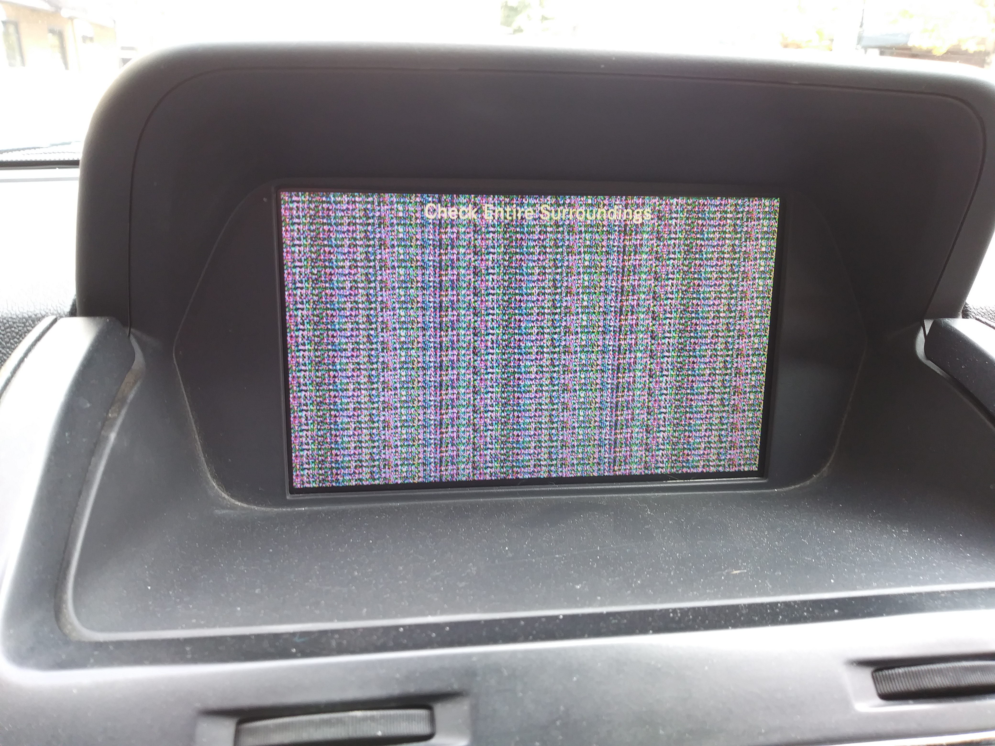

dalarieanderson Posted June 18, 2020 Report Share Posted June 18, 2020 My camera works while the lift gate is up, but when down, it's either black or black with red squibbly lines. Is it more a camera issue or wiring issue? William Burke 1 Quote Link to comment Share on other sites More sharing options...
William Burke Posted June 18, 2020 Report Share Posted June 18, 2020 Sounds like wiring... Ours does this once in awhile, but as soon as we start the car the next time, it clears up. Quote Link to comment Share on other sites More sharing options...
2late4u Posted June 19, 2020 Report Share Posted June 19, 2020 check the wiring in the upper left hand side of the hatch they have broken wires found there before, that said my 2014 acts up as well either completely black or black with the warning at the top or sometimes image upside down then readjust and then normal. or sometimes it works just fine. havent had time to take it to a dealer to get it fixed just waiting for it to go out completely. hope you find out what it is please report back on what you find out for others with this problem William Burke 1 Quote Link to comment Share on other sites More sharing options...
