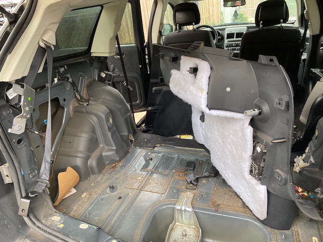

Johnc2912 Posted November 2, 2020 Report Share Posted November 2, 2020 Job was little time consuming. Bought from family with 4 kids so lot of food and sticky substances in way. Several youtube vids out there to give you an idea of basic dismantling of rear interior, some show having to remove upper plastic around window, but didnt need to do it on mine. I took out all seats except front(mostly to clean ) but it made more room to work. Do both struts while everything removed. I thought about cutting access hole at first but it wasnt too bad of job to be worth cutting stuff up. Probably good idea to check all your toe links and knuckle bushings while doing this as well. All bushings seem to be worn out quite a bit for only 105k miles on mine. Seems like bad design to access 2 bolts, but then again you have to remove front to remove battery, go figure shaggy 1 Quote Link to comment Share on other sites More sharing options...
