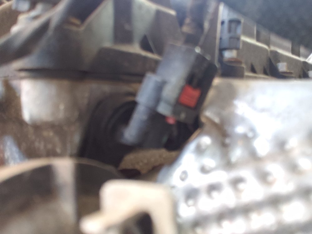

Marcus Posted July 5, 2020 Report Share Posted July 5, 2020 Hello. I got error codes P0339 twice and P0335. Going to start with replacement of crankshaft sensor. Is this what I'm looking for? Thanks Quote Link to comment Share on other sites More sharing options...
Marcus Posted July 5, 2020 Author Report Share Posted July 5, 2020 Sorry it's a 2.4l Quote Link to comment Share on other sites More sharing options...
John/Horace Posted July 6, 2020 Report Share Posted July 6, 2020 It’s this. I don’t work for Rockauto, just good pics. Order oem part, price close, less risk. https://www.rockauto.com/en/catalog/dodge,2015,journey,2.4l+l4,3309783,ignition,crankshaft+position+sensor,7196 Quote Link to comment Share on other sites More sharing options...
