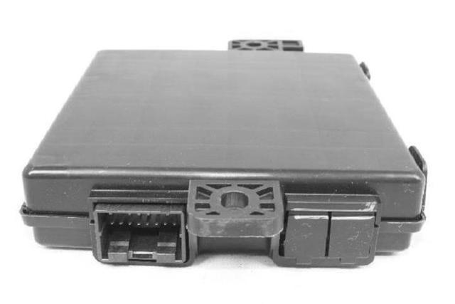

Joel Posted July 12, 2020 Report Share Posted July 12, 2020 I have a 2014 SE and the right front sensor isn’t reading. I’ve rotated the tires and it doesn’t matter which one I put on there, it still won’t read. I’ve never had a vehicle with a tpms system so this is a new problem for me. Any ideas on why the right front won’t show anything other than — no matter which wheel gets put there? They all display the tire psi in any other location. Quote Link to comment Share on other sites More sharing options...
John/Horace Posted July 12, 2020 Report Share Posted July 12, 2020 I’ve had two cars with it. Can be annoying. They work with radio frequency, 433 Mhrz to communicate with a receiver under the dash. It appears one of the four channels is not functioning any more. Tire pressure module receiving module probably. Free advice worth everything you pay for it. https://www.moparwholesaleparts.com/oem-parts/mopar-tire-pressure-monitoring-system-receiver-56046811ag jkeaton 1 Quote Link to comment Share on other sites More sharing options...
John/Horace Posted July 12, 2020 Report Share Posted July 12, 2020 The part shown is for Dart, Journey should have something similar. Search with your vin number. Summer Solstice and jkeaton 2 Quote Link to comment Share on other sites More sharing options...
Joel Posted July 12, 2020 Author Report Share Posted July 12, 2020 12 hours ago, John/Horace said: I’ve had two cars with it. Can be annoying. They work with radio frequency, 433 Mhrz to communicate with a receiver under the dash. It appears one of the four channels is not functioning any more. Tire pressure module receiving module probably. Free advice worth everything you pay for it. https://www.moparwholesaleparts.com/oem-parts/mopar-tire-pressure-monitoring-system-receiver-56046811ag Thank you. I will replace the module and hopefully not have to replace anything else. Quote Link to comment Share on other sites More sharing options...

John/Horace Posted July 20, 2020 Report Share Posted July 20, 2020 I’ve searched and found passive entry and remote start antenna, nothing for tire pressure coming up anywhere. Where is the pic. Remotes antenna is shown below. Quote Link to comment Share on other sites More sharing options...
Joel Posted July 21, 2020 Author Report Share Posted July 21, 2020 I couldn’t find it either. Apparently from what I have been able to find is that these ones work off of a wireless signal And the antenna is built into the tpms module. John/Horace 1 Quote Link to comment Share on other sites More sharing options...
John/Horace Posted August 6, 2020 Report Share Posted August 6, 2020 Still can’t find this mystery antenna, anyone have a pic and part number? Must be integrated like OP says. https://www.moparpartscanada.ca/auto-parts/2014/dodge/journey/r-t-trim/3-6l-v6-flex-engine/electrical-cat/tire-pressure-monitor-components-scat Quote Link to comment Share on other sites More sharing options...
