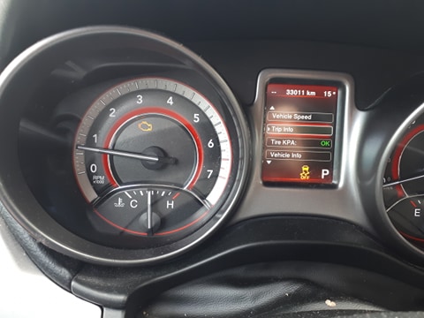

I'm from Poland, so apologies if I made some mistake in English. I have a huge problem with my Dodge Journey, which can not be solved by service there.
Car: Dodge Journey 2,4 170HP 2017
So: From time to time (sometimes it is twice a day, sometimes every few days) a "check engine" and traction control light appear. Then car enters in an emergency mode.
Sometimes, when it is turned off and started again, traction control light disappears and the car drives normally. After some time, "check engine" light also disappears.
The car computer displays P0365 error - Camshaft Position Sensor B circuit Bank 1
The car has Lovato LPG installation. Anyway the problem is the same also on gasoline and LPG.
Computer takes the RPM signal from the timing sensor.
Did anybody have the same problem? Any suggestions or advices?

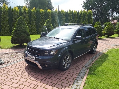

good looking journey and man that driveway looks fantastic and the yard work as well. very beautiful
