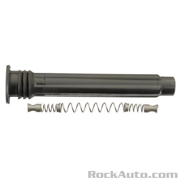

John/Horace Posted September 26, 2020 Report Share Posted September 26, 2020 I changed plugs 2 years when doing oil cooler leak, which is a fair amount of work. Had lower intake etc removed. Plugs by themselves isn’t terrible I agree. How were the coil boots? You can buy them separately, one of mine split apart during removal. If you are getting more misfires after new plugs, maybe some of them got damaged. Coil assembly has new boot automatically included. Misfire moving around cyclinders is sometimes pointing to intake manifold air leaks. The lower intake has O rings that can be changed. Coils don’t usually work and then suddenly not work properly. Plastic intake could be affected by temperature and air flow. Misfires can mess up catalytic converters, not something to let slide IMO. Shawn855 1 Quote Link to comment Share on other sites More sharing options...
Shawn855 Posted September 26, 2020 Author Report Share Posted September 26, 2020 The coils themselves had grey soot at the end of them where they connect to the plugs Quote Link to comment Share on other sites More sharing options...
John/Horace Posted September 26, 2020 Report Share Posted September 26, 2020 None of mine did and I had no misfire codes. Normally a small dab dielectric grease is put on both contact end to prevent arcing. The coil boots are only few bucks from Rockauto, https://www.rockauto.com/en/catalog/dodge,2014,journey,3.6l+v6,3300354,ignition,spark+plug+/+coil-on-plug+boot,10150 Shawn855 1 Quote Link to comment Share on other sites More sharing options...
